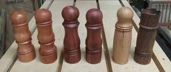

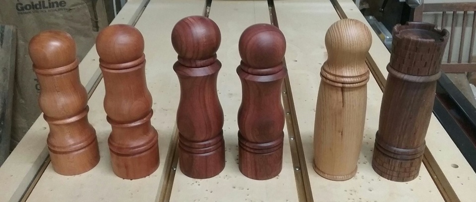

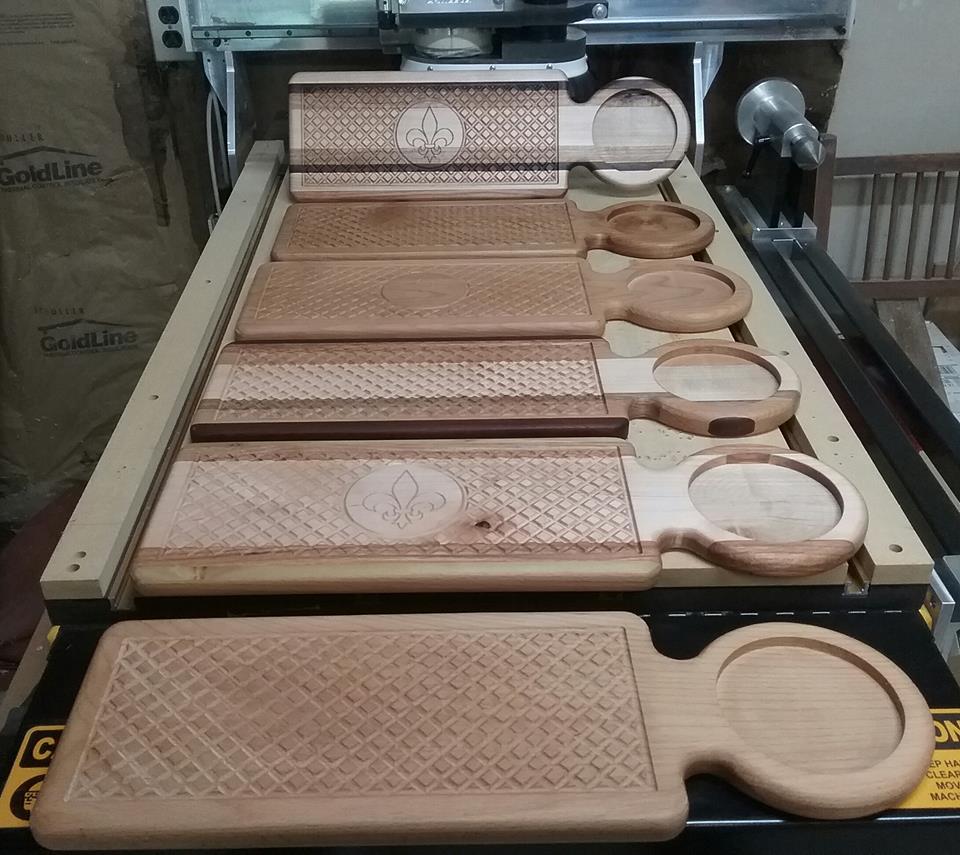

Finished up an order for a customer of mine. She has a spice store and carries some of my peppermills and a breadboard that I make which has a place for a bowl for dips or oils to dip the bread in. The peppermills were made with cherry, sapele, walnut and honey locus. The breadboards are beech, oak, maple, hickory, walnut, mahogany.
Bobby
Louisiana

Thanks for the comments, they are appreciated. Yes, the are done on a CNC machine. They are 20 -21 inches long, 6 -7 inches wide and the area for the dish is about 4" in dia. The cross hatch pattern is cut using a 1/4" ball nose bit, the fleur-de-lis is cut using a 60° V bit. I have some other patterns that I cut, but it appears these are the best sellers. I am having a blast with this machine and I have only scratched the surface in what it can do. I am still very much in the learning stage.
Bobby
