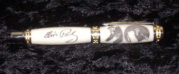

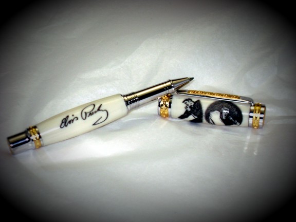

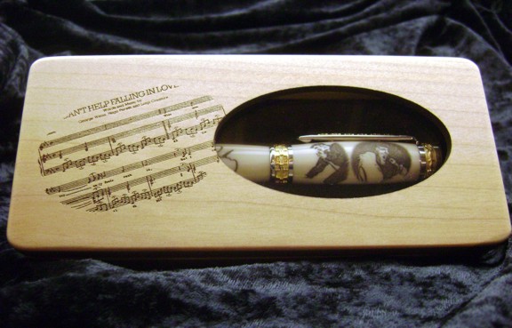

The Elvis Pen I did... I sold for $300. Ivory/ Emperor, Kallenshaan did the engraving.
