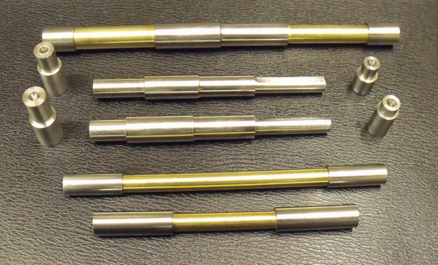

As has been said, making bushings is the very best project to get to learn how to use your new machine.
Here's a pic of various 'Mandrel - bushes' I made from stainless steel.
These were made to suit several different kits and also can be used as 'Closed Ended Mandrels as they include for o-rings to use as pin chucks.
I use a lot of stainless and have learnt the hard way that stainless steel needs to be slightly aggresively cut. If you mess about with too light a cut, then you will struggle.
Not to contradict Joe, but I must admit though that I have never turned, drilled or milled SS at anymore than 5-600 RPM.
Good luck :wink:
Oh...PS.....Stainless Steel shavings and ribbons are hotter than hell and sharper than razor blades. Please take care!!!:wink:
Good luck :wink:
