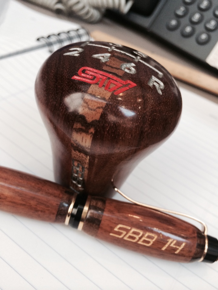

Hey everyone, finally got it completed
Guatemalan Hormigo with Zebrawood accents
Thanks everyone.. it had some challenges... as the car type it is made for has a release lock that has to be pulled up into the knob in order to allow the car into reverse.
Worked out well, and looking forward to making my next one.

If you do make your own, I would suggest using metal threads. Let me know if you need any additional information.
Kev
Thanks for the offer, I am gonna try to make a practice one this evening, proly out of some scraps I have laying around.
So how did you do the threads? I thought about trying to find a nut that fit the threads and epoxying it into the bottom. I gotta research what threads a mazda 3 uses.

I put the threads in the wood first then, I get the matching bolt of about 100mm in length and cut the hex off of the top. Then put the bolt in my oneway chuck with spigot jaws and spin the knob with the threads in, that way it is centered on the shifter. There is more challenge if your car has a reverse lock where you have to lift a ring to get it into reverse.
