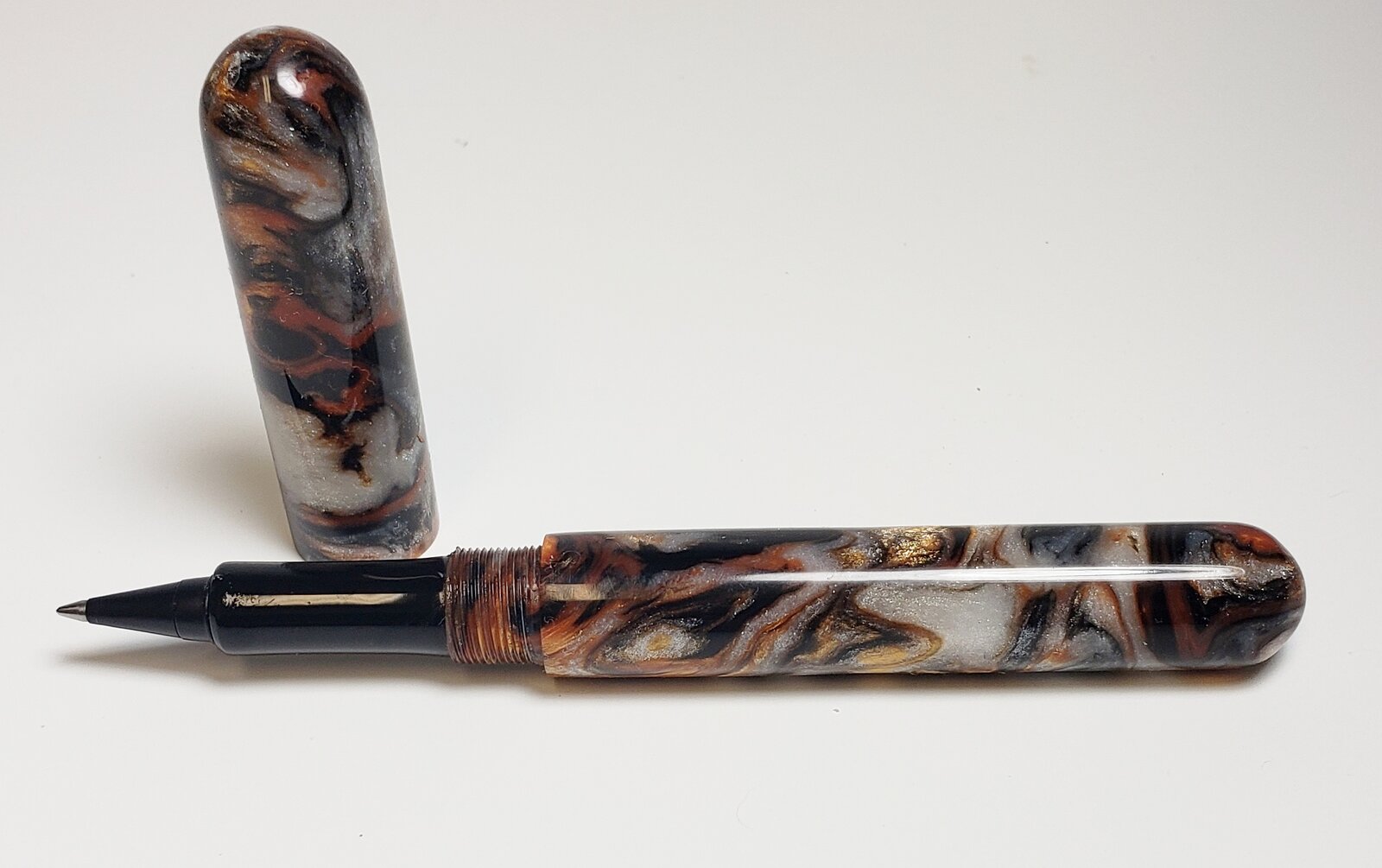

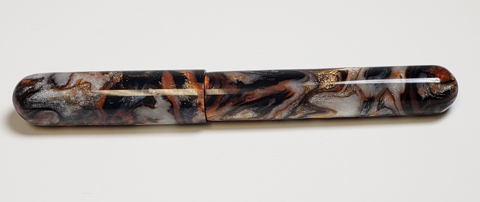

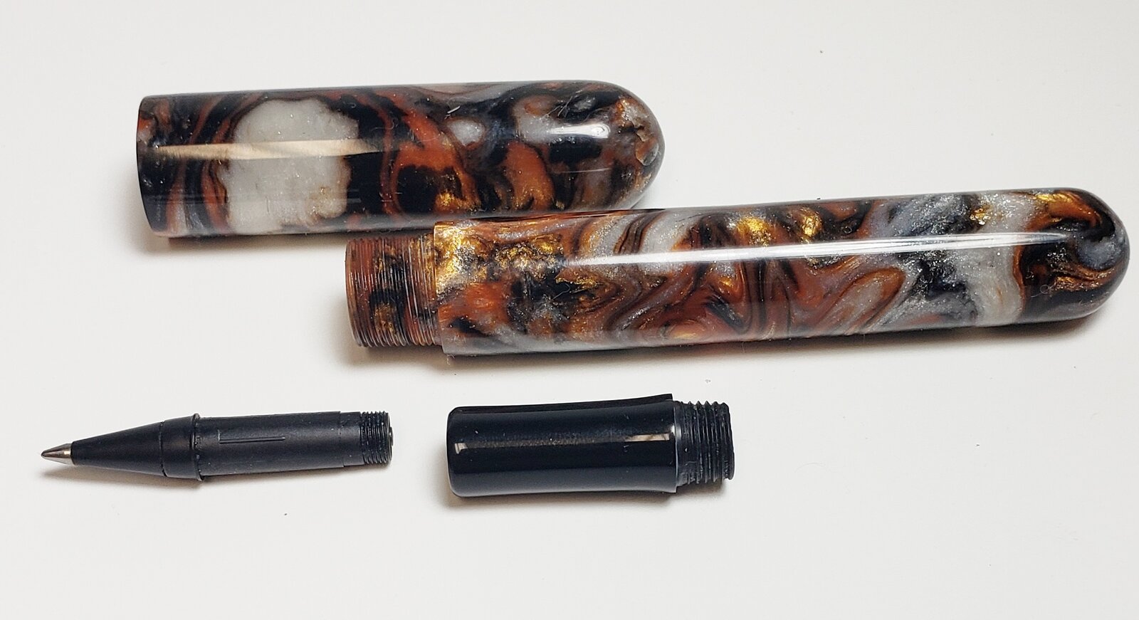

Beaufort Ink in the UK carries refillable rollerball nibs that take a "Standard International" ink converter or ink cartridge, and therefore, can be refilled as a fountain pen. I have used these rollerball nibs in a couple of my pen designs, and they have been working well with different colors and brands of fountain pen ink so far. Hopefully we can source these here in the USA because postage from Beaufort is expensive.

Schmidt PRS Metal Cartridge Rollerball Tip.
I do not consider them ugly. There is one available with a chrome exposed portion. Made by Schmidt. Taps are available for threading the section. Check pricing at several outlets. Some are really proud of them. Tested to write for 20,000 feet and recommended replacement after 30 fillings. I really like using them.
