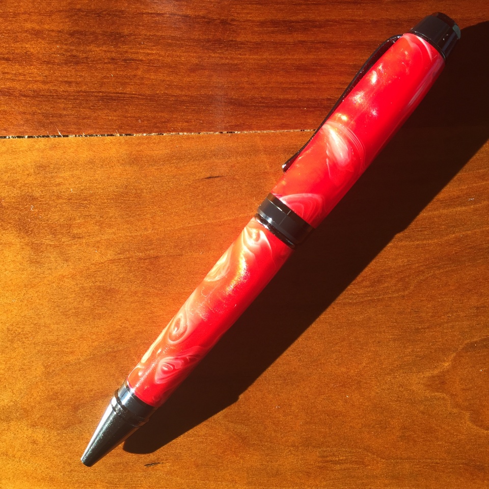

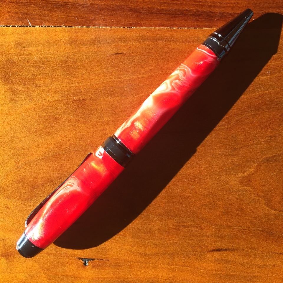

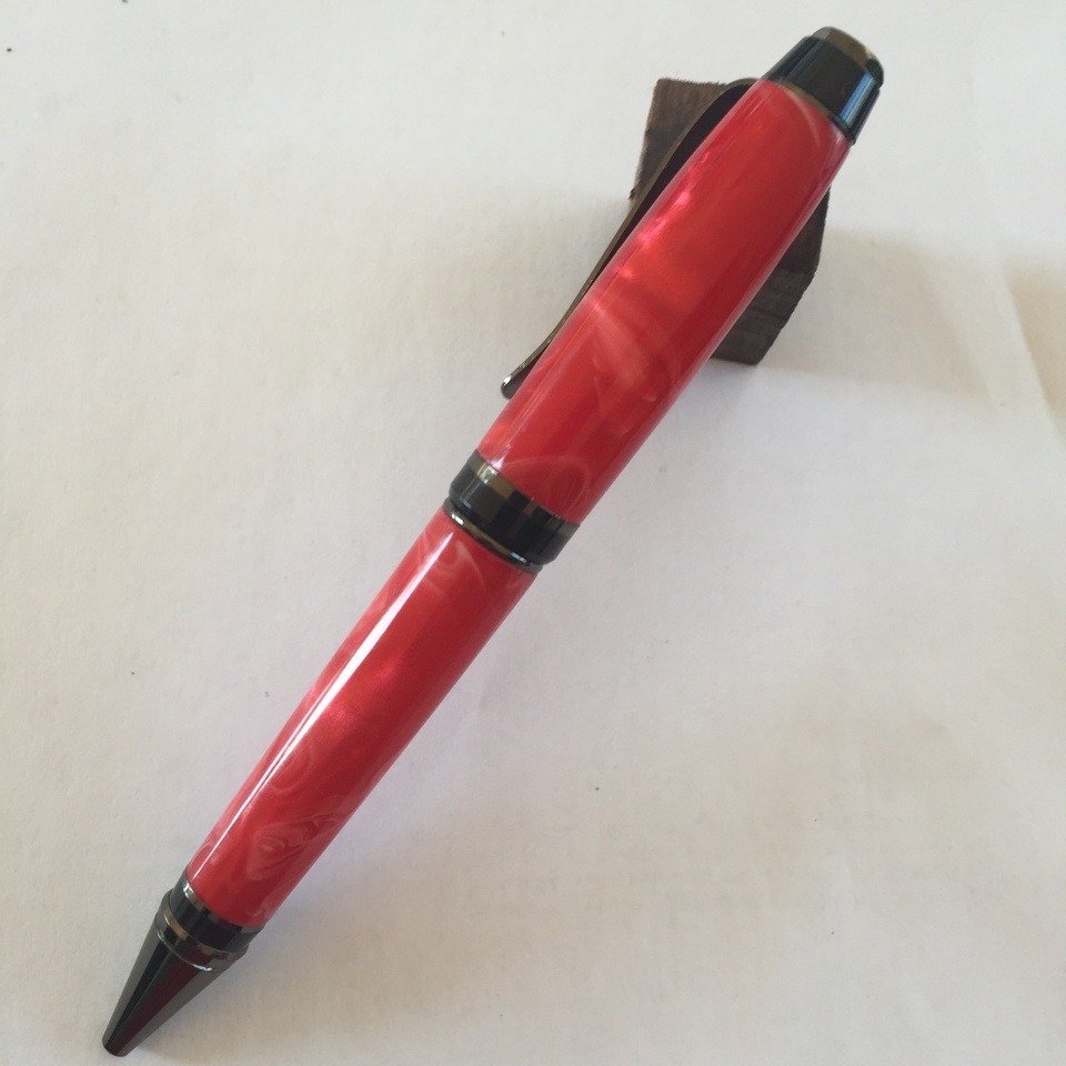

I made this acrylic about a month ago using Alumilite, Alumilite red and white dyes, and Alumidust interference red and pearl powders. I really wanted a unique depth to the blank using the red dye with the interference red powder.
The tubes and drilled hole were painted Red using Testor's Model Master paint and I used a gunmetal cigar pen to pair with the blank. 10 coats of thin CA applied over to gloss it up a bit.
I sent a few of these blanks to my friend and he painted the tubes black which I think gave the blank even more depth! Once I get out of this blasted sling I think I will try another piece of this acrylic with black tubes instead of red.
Sorry for the bad pictures...I don't have a light box setup yet and I was trying to get natural sunlight to reflect out the pearl and interference red in the blank.

Looks great! The first pic shows some very nice swirls. I find myself backpainting with black probably 80-90% of the time now. I think it really brings out some depth with the colors I tend to use, although I have no idea why. Just about the only time I don't use black is if I'm using white, ivory, or yellow for the blank which isn't often.

Same. I backpaint mostly everything either black or silver. This was actually the first red tube I had done. I have some acrylic for a "mahi-mahi" pen I have in my head where I swirled neon green, neon yellow, and a deep blue together and I have painted the tubes with neon yellow with finger nail polish. Bad thing about fingernail polish is it builds extra thickness quickly.
