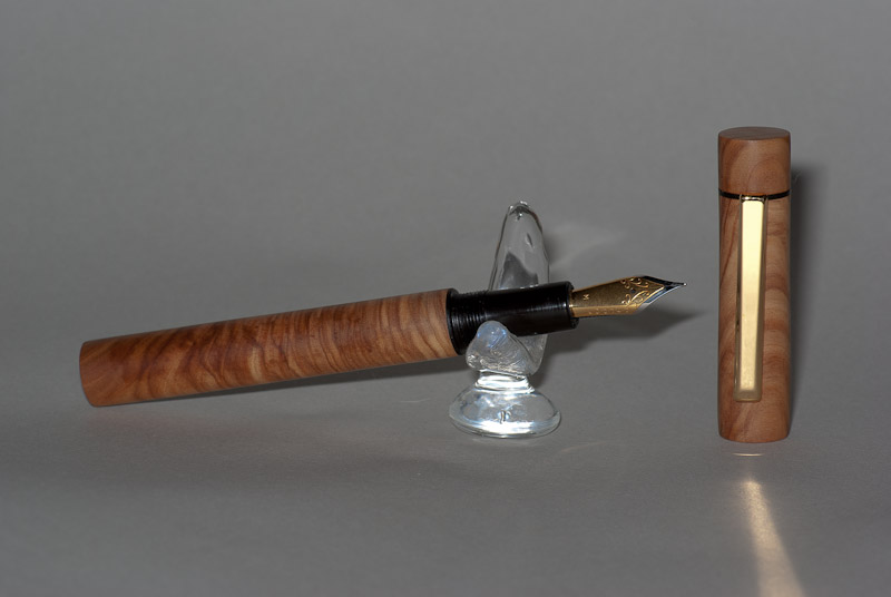

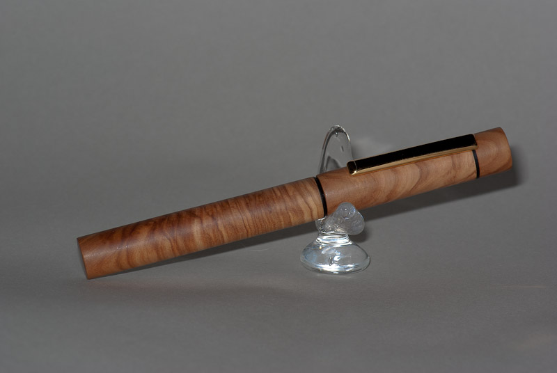

A while back one of my customers saw a pen I made some time back out of lignum vitae and black ebonite (hard rubber), and asked if I could make one like it from olive wood.
I decided I had to line the inside of the barrel and cap. Since I was using ebonite inserts for the threaded parts (cap-to-barrel and barrel-to-nib-section) I extended the ebonite plug into a full-length liner down the center of the wooden blanks.
There's another trick going on inside the cap, but it's not visible from the outside -- it has a double-liner, the internal one is drilled out to accept the nib but it strikes against the front edge of the ebonite section holding the nib. This prevents the cap from being screwed on too far, and also reduces the air cavity around the nib substantially (which I was advised can help keep the nib from drying out when not in use.)
Here's the end result, after I'd given it a wipe down with Mahoney's Walnut Oil and then buffed with carnauba wax to give it some protection. The nib is a JoWo #6 two-tone (from Meisternib.com) and the clip is a Ti/Gold Rineheart from ExoticBlanks.com.

Thanks George :smile:
Your suspicion is true -- 2 blanks. Actually 4 blanks, because I managed to destroy the first 2 barrels by making rookie mistakes. :rolleyes:
I bought a set of blanks from RockB a while back, they were all cross-cut to a degree, but this pair were more noticeably different than the first 2 barrels I made.
I'm just glad that I didn't break the cap -- that was ridiculously complex with the internal stop, which doubled as the tenon to attach the clip and finial (but at a different diameter, of course ... :eek:)
