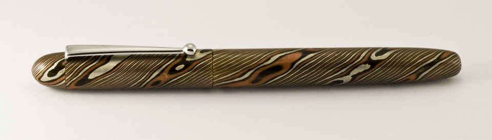

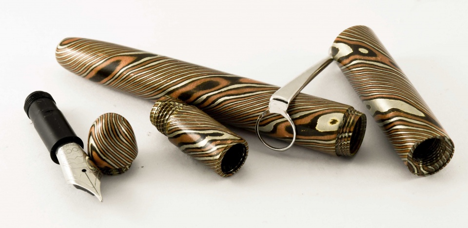

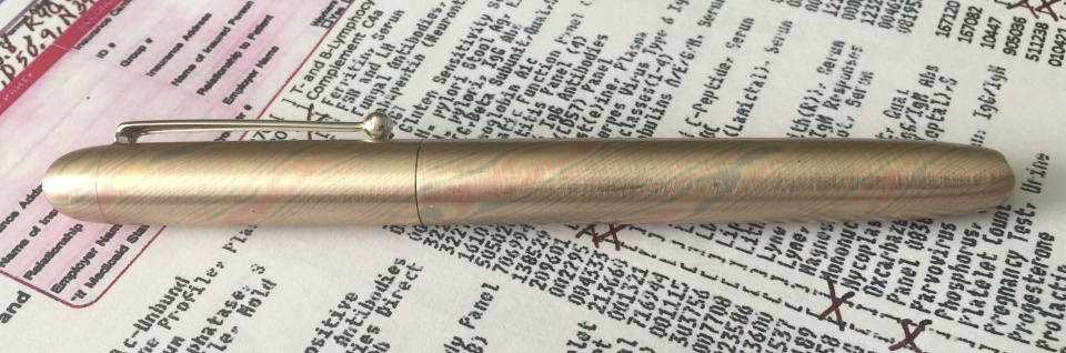

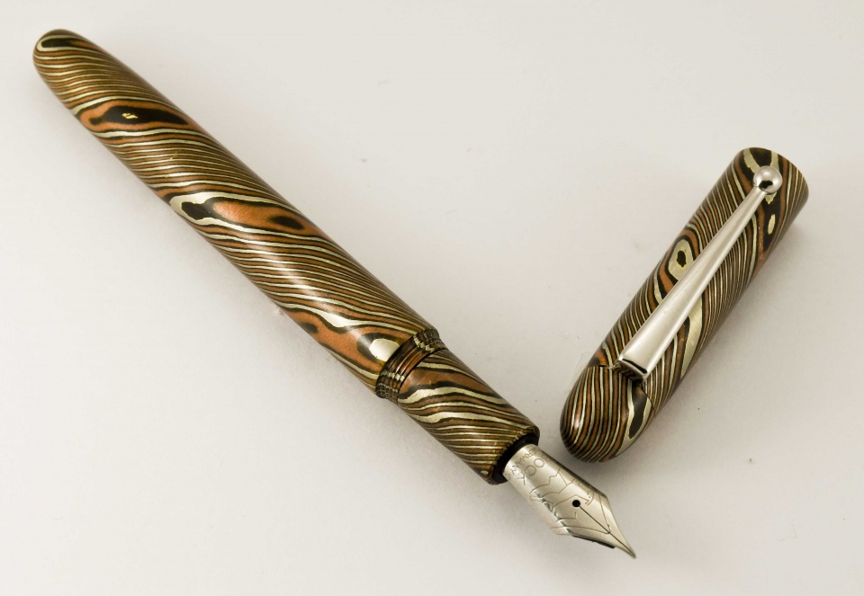

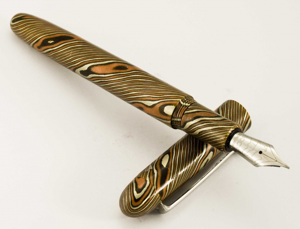

Made from a 5/8" triple twist rod of copper, brass and nickel silver Mokume Gane. I really enjoy working with this material. It is fun to watch it take shape. I still marvel at watching the patina form..included a picture after just machining but prior to polishing, prepping and patina application. Thought I would try to make a fountain pen with a more classic appearance with rounded finial/ends. Sports a #6 fine Bock Nib. Had fun making it.:smile:
Kind Regards, Doc:smile:

Isn't this material sort of brittle? Will the threads last, or wear out over time? I thought it was pretty risky threading this stuff.
Thank you all for the kind comments and encouragement!
Shawn, This is made from mokume gane forged from brass, copper and nickel-silver. Solid metal. Not brittle, lasts for centuries, hard on carbide bits used to drill it and on HSS dies used to thread.
Are there special tools needed to turn this? ITs amazing!
Hi Ray, Thank you very much for the compliment. Not really that special. This material is pretty tough to drill and machine. Mainly metal machining tools:
Little Machine Shop 8.5 X 20" Metal Lathe with DRO
Eccentric Engineering Diamond Tool Holder Holder with Cobalt bits
Cobalt Drill Bits
12 X 0.8 HSS triple start tap and die
Abranet
Felspar Powder
Patina Solution
Hope that helps.
Regards,
Doc:smile:
If you don't mind, what secret sauce did you use to bring out the patina? I think your end result is stunning.
Hi David,
Thank you for the kind words.
I use Baldwin's Patina Prep which contains Feldspar powder to shear metal surfaces to prevent one metal from smearing over an another adjacent metal layer. Makes the delineation between the three metal surfaces very crisp looking.
For the patina, I use Baldwin's Patina Solution heated in a microwave when my wife isn't looking and with enough time to air out ammonia fumes. The darkness and thus the contrast of the various hues is dependent on the time left in the solution. I hope that helps.
