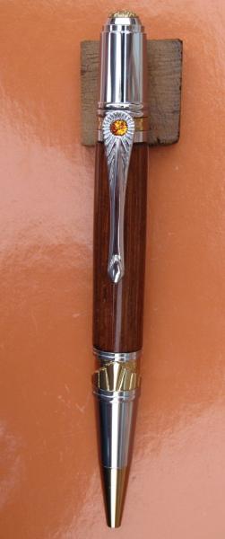

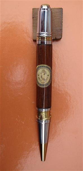

Here is a photo of the pen I created using a sticker I purchased from the above company.
The pen is a David Broadwell Art Deco ballpoint. The wood is from the teak deck of the battleship USS California which was sunk on December 7, 1941.
I wanted to add more separation between the pen and ends of the blank so I used additional Teak Oil to make it darker.
The pen was make a friend whose father served on the USS Tennessee on that day.

The stickers are thin, stick well, and work with CA.
One point, on their website, you can adjust the size of the sticker. If you keep it as is, it will be 1.5 inches. What I did was to measure the image on the screen and calculated it down to the size I needed.
