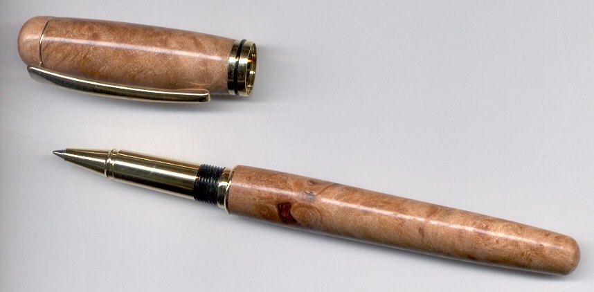

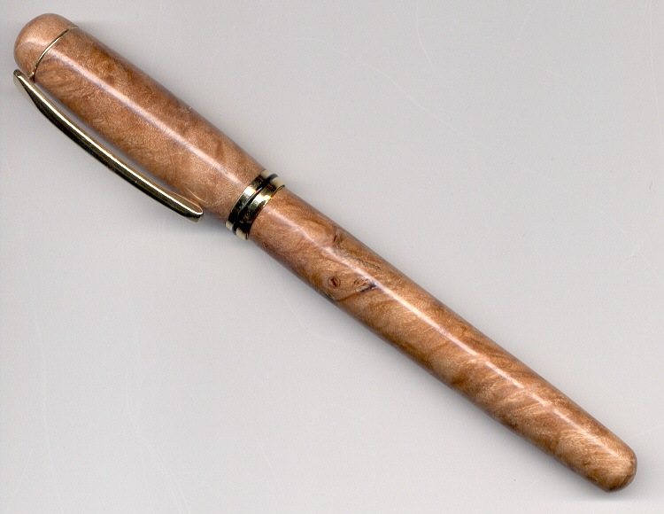

This is a Jr Gents solid body in maple burl with a custom final. I was pretty happy with this all in all.
Comments and critiques are appreciated.

Originally posted by pastorbill1952
<br /> Like the finial but was wondering what it would look like w/ the clip recessed.
Pastor Bill this is just my opinion but I find that with a recessed clip I personally do not like the line that forms where the cap and the final meets if they are both made out of the same material.
I like recessed clips but usually if I recess the clip I make the final out of a contrasting material. On this one I wanted to have all one wood.
see example:
<b>Image Insert:</b><br />
<br />
Plus on the Jr Gent with the different diameter of the cap and the lower barrel, I think that increasing the diameter of the cap further would make it look disproportionate. With the small amount of material where the clip attaches that is the only way that I could see doing it.
Feb 19, 2005
1,343
Orrum, NC
Good answer. Isn't there some way to reduce a clip's size (diameter) and insert it into the wood without a full cut? Not really trying to start an argument, just wondering. Both pens are great.
vick
Nov 16, 2004
1,447
Gilbert, AZ, USA.
No argument I appreciate any discussion about my designs and or methods. I am not sure if you use this kit or not, I would post a picture of it but this was my last one. The clip is usually held in by a plug type end cap that is the full internal diameter of the tube. So there is only a very thin circle of metal. The only way I could think to try the recessed clip other than changing the caps outside diameter would be to grind away the entire metal circle and epoxy the small rectangular section into the recess. I have serious doubts that the epoxy could stand the abuse a clip take constantly flexing.
If anyone has any other ideas I would be interested in hearing them.

Originally posted by Johnathan
<br />Looks nice. Is it just me, or does it look like there is a little space around the clip? How's the fit?
I also see that it in the picture the seem is tite however the final is just a tad bigger than the clip in a couple parts which may be what is causing the picture to look like that. I have pretty high standards when it comes to fit and I would still call this pen sellable, but most pen turners could tell that it was off a little.
