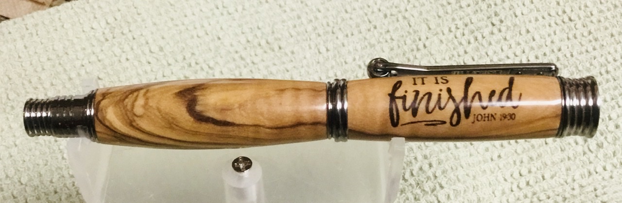

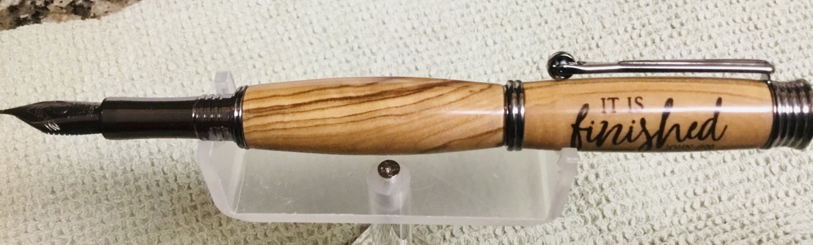

Loving my Neje laser. Had a customer order this Jr Morgan/ Olivewood pen for their pastor. The non figured part of this blank was perfect for what they wanted engraved.

That pen and it's message is really nice! Which Neje did you use? And 2 newbe type questions: 1) did you engrave before or after finishing; and 2) what finish did you use?
I have the 1500mW laser st at 25ms. Engraved after sanding and one coat of thin CA. After engraving I built up CA finish to a smooth finish. Micro mesh and buff. Thanks. Jason
