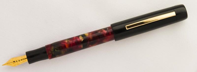

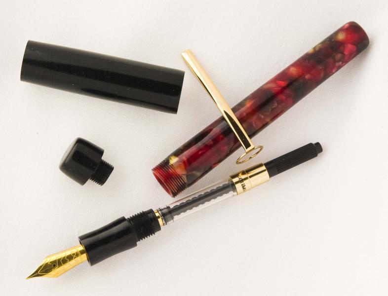

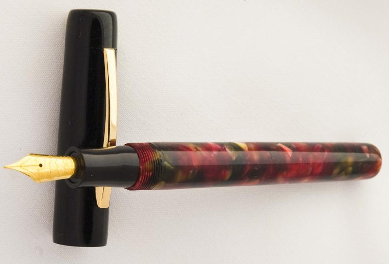

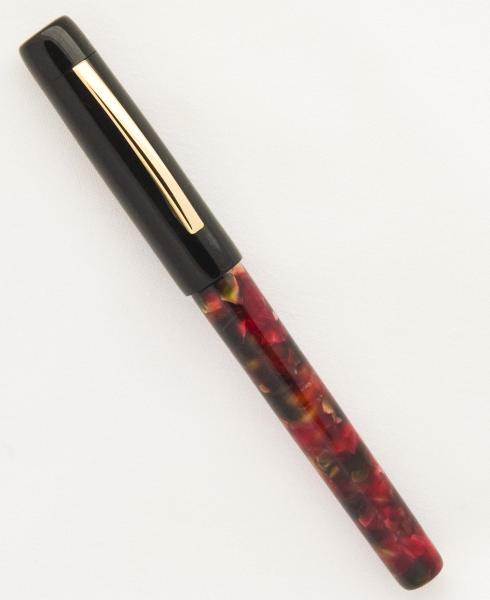

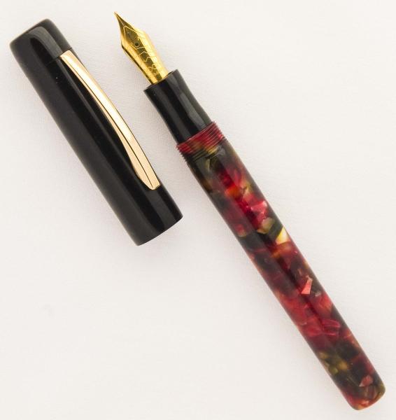

Finished it this A.M. Fountain pen that I called a Duo as it has an ebonite cap with a red chunk resin barrel. Section is also ebonite. Has a #6 Medium point Gilded Bock Nib. Enjoyed making it. Hope you like it. Doc:)

That is fantastic. I really like the black cap with the other material. I'd be interested in the other dimensions. Like the cap thread size, length, etc.
wizard
Aug 27, 2009
3,569
Houston, Texas
Thanks you all so much for the kind comments and encouragement.
Bob,
Thank you for the kind words. With regard to your question regarding dimensions.
Cap to barrel threads are 14 mm triple start
Cap to finial threads are 9 X 0.75 mm
Section to barrel threads are 10 X 1 mm
Length of pen capped is 6.1"
Length of pen posted is 6.55"
Length of cap/finial is 2.7"
Length uncapped from tip of nib to end of barrel is 5.3"
Barrel width at widest point is 0.55"
Cap width at widest point is 0.65"
Hope that helps..
