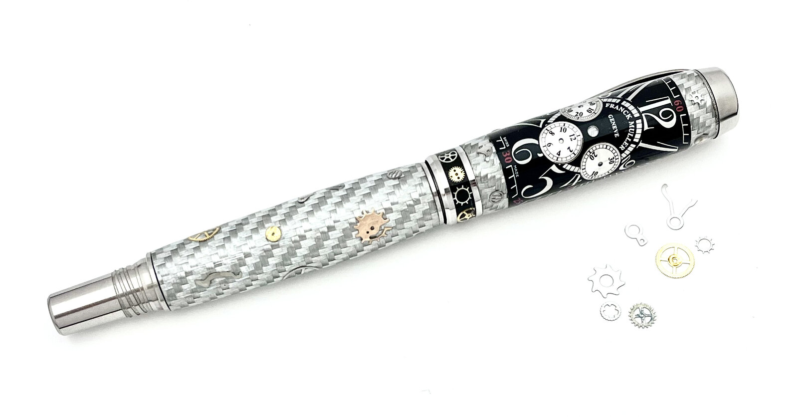

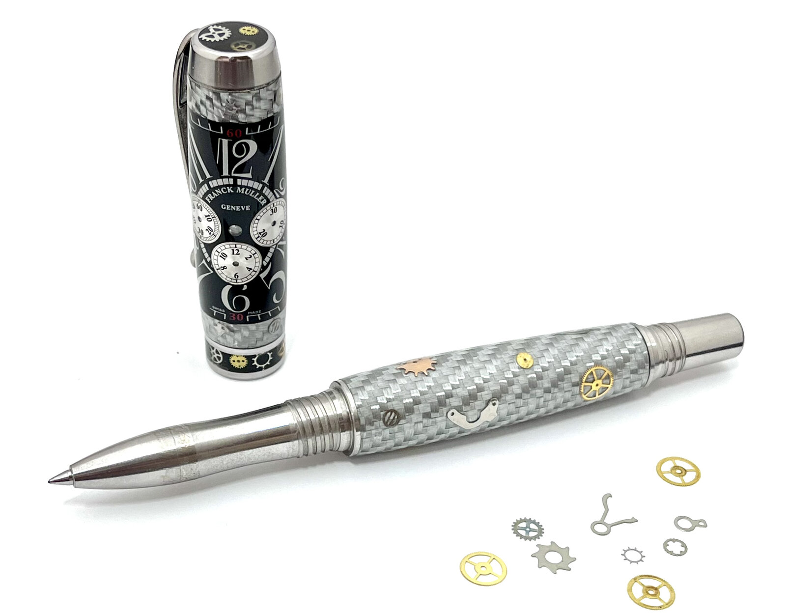

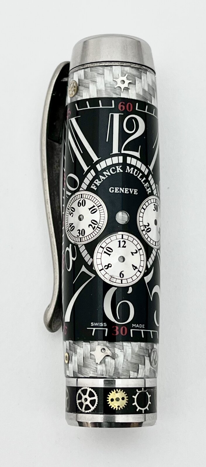

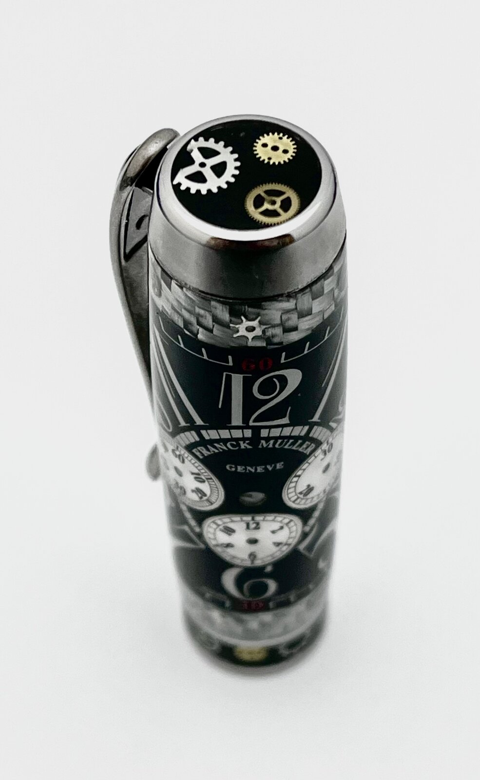

In a recent conversation with Ed Brown he asked if I would make a couple short videos on how I construct some of my custom parts for the new Band-It pen (my new "Go To" pen set). I had some blanks set aside for myself, that I usually end up giving away before I get around to turning them, so I thought I would put one to use. This is a silver woven fiber blank I cast with a few watch parts and face. I wish I would have put more on there but at the time I thought it might over power the fiber. The black face worked very well with the silver so I decided to construct a center band and finial to match. I'm wondering what it might look like with a small black band at the lower end just above the threads to match the center band. Maybe next time... Here's the result. I'm pretty happy with it and will probably keep it unless I have a weak moment. If you're interested in how I made the center band and finial, Ed will be posting the videos on Exotic Blanks YouTube Channel.
Thanks for looking!
