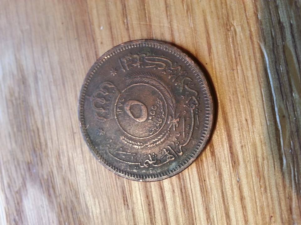

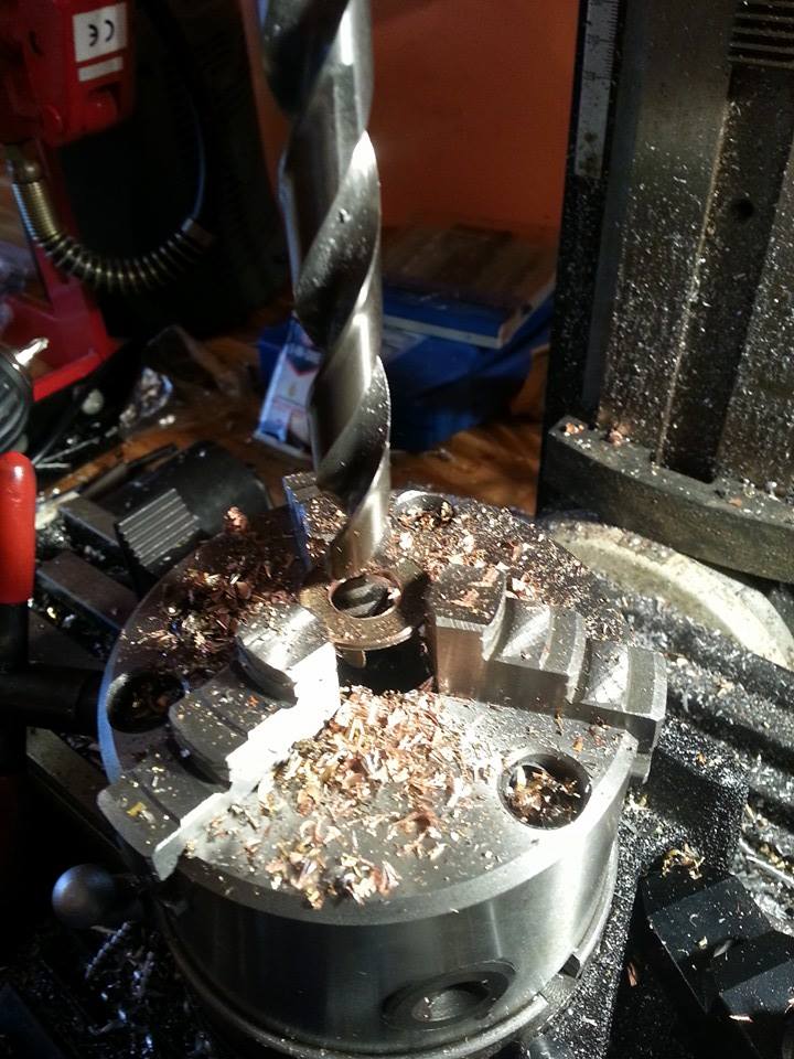

buy a bag of coins and pick one out which has detailing which appeals around the outside edge
attachment.php
Drill the center out. the size of this hole goes a long way in determining the final size of the ring.

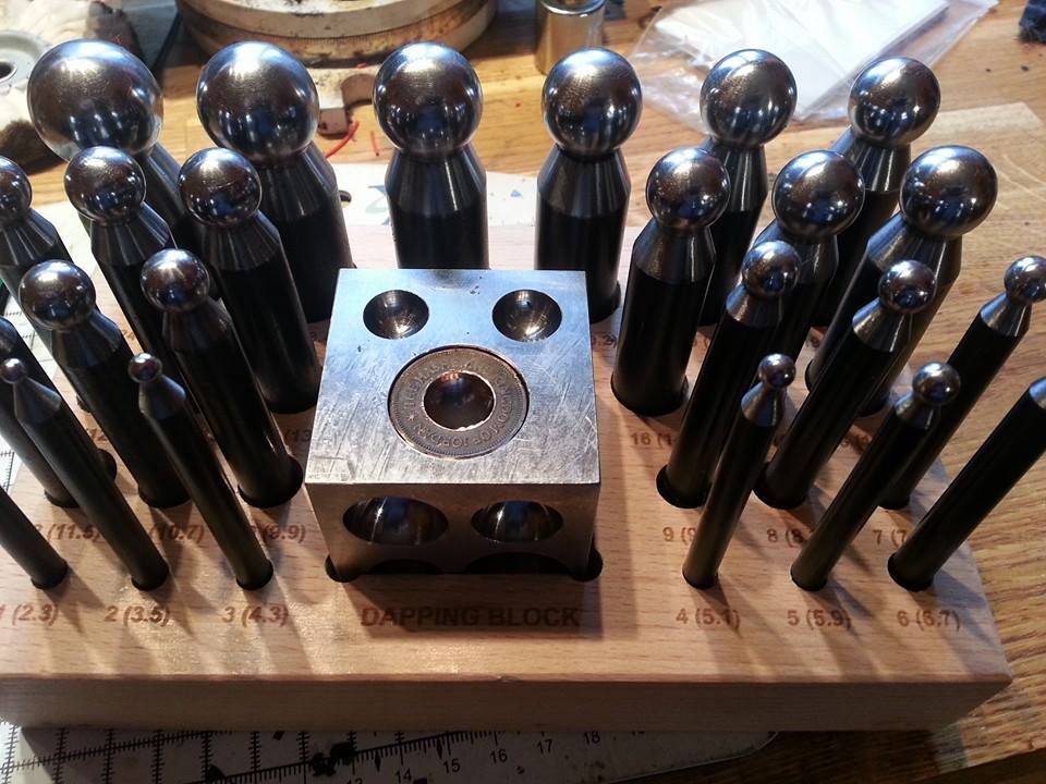

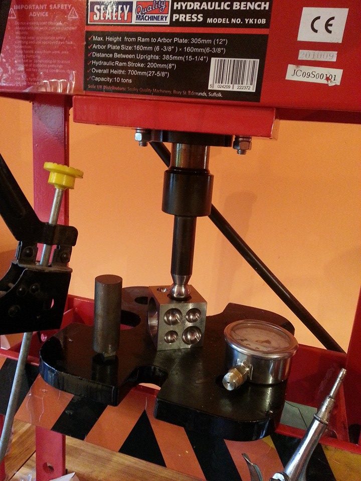

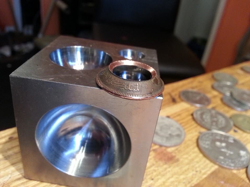

This is a dapping block. it's used to hammer things into a dome shape. I have a hydraulic press so I used that, but it can be done in a vice also.
attachment.php
attachment.php
Press to this shape

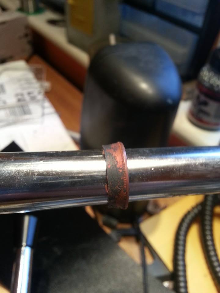

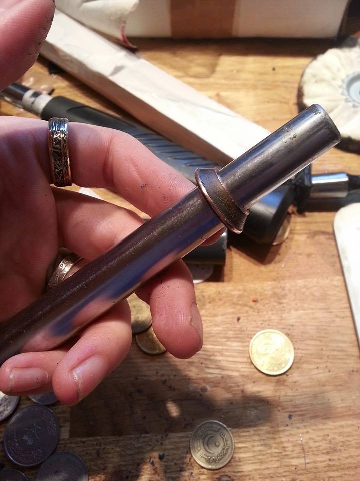

Place it onto a jewellers steel mandrel. these are used for straightening out bent rings and making them a little larger by working them down the taper.
attachment.php

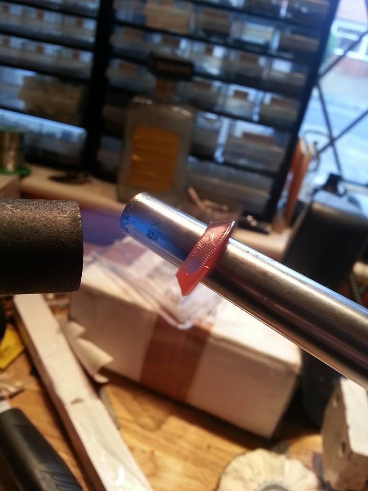

heat the coin until it glows with a blow torch, and begin working the coin with a soft hammer such as copper or weighted leather. Depending on what way around the coin is on the mendrel (Flange pointing in or out) will determine if you end up stretching it down the mandrel more as you hammer it, or if you're hammering it flat.
attachment.php
attachment.php

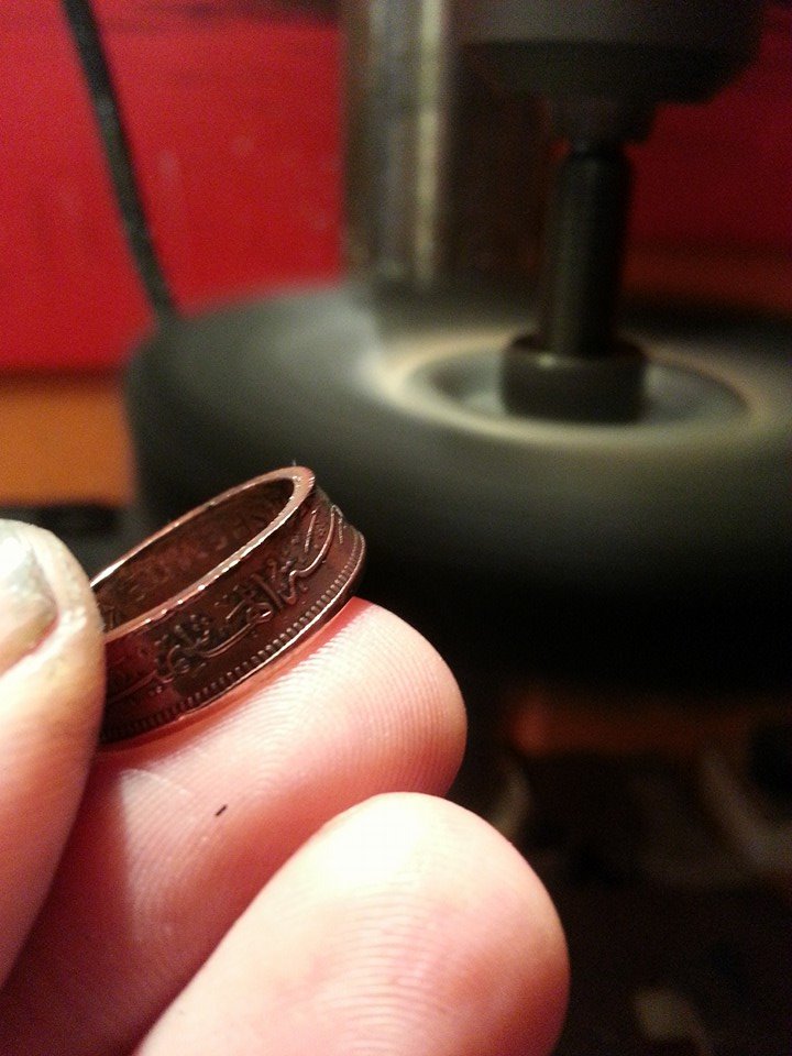

I give mine a rough polish so I can see what i'm working with
attachment.php

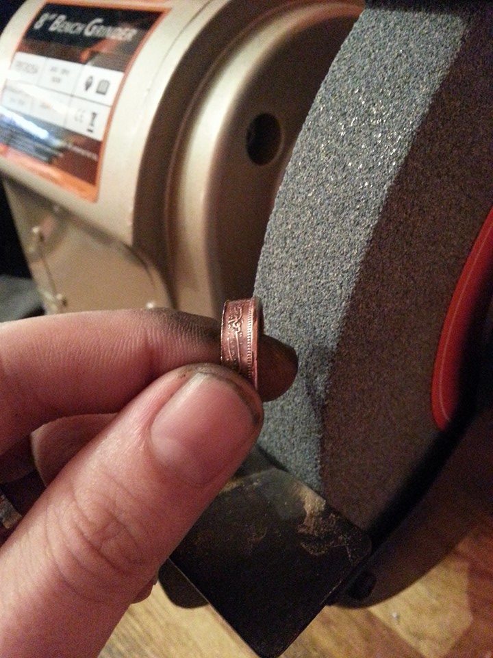

and then take to the grinder to profile the edges
attachment.php

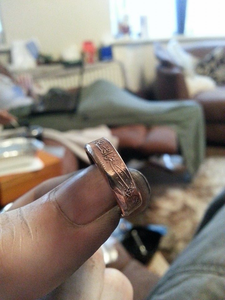

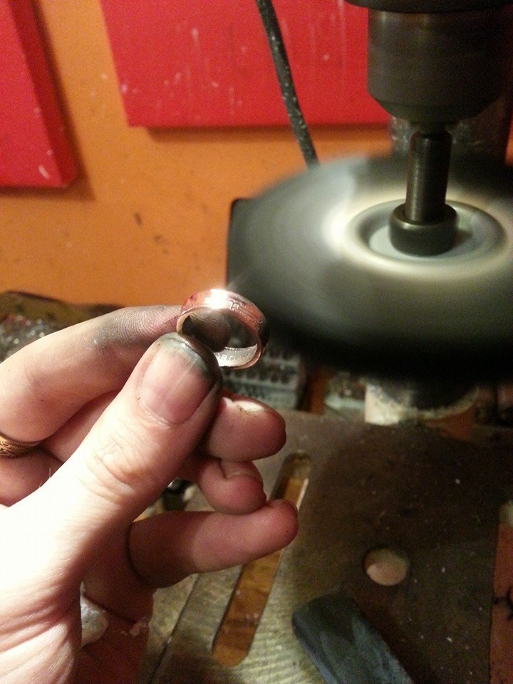

From there, another polish.
attachment.php

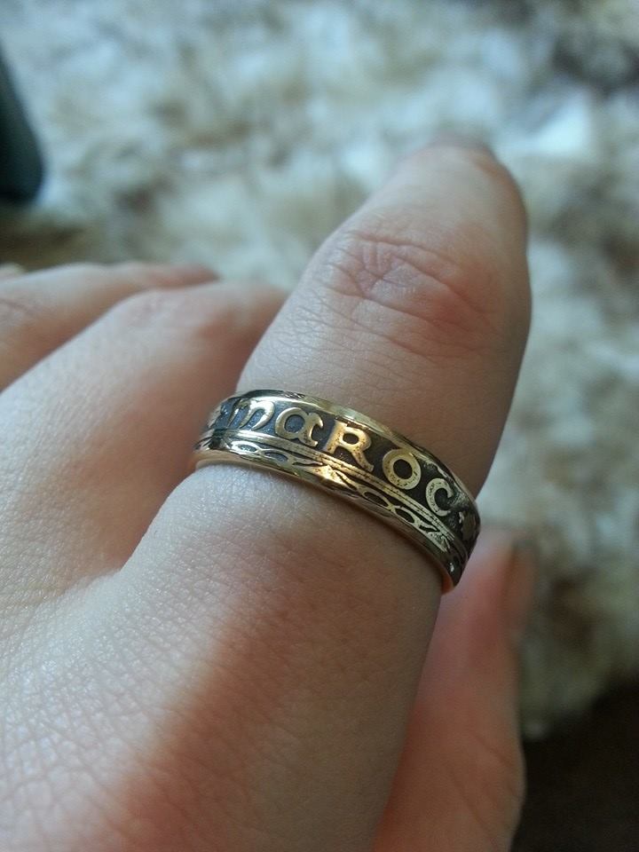

And one finished ring with arabic script.
attachment.php

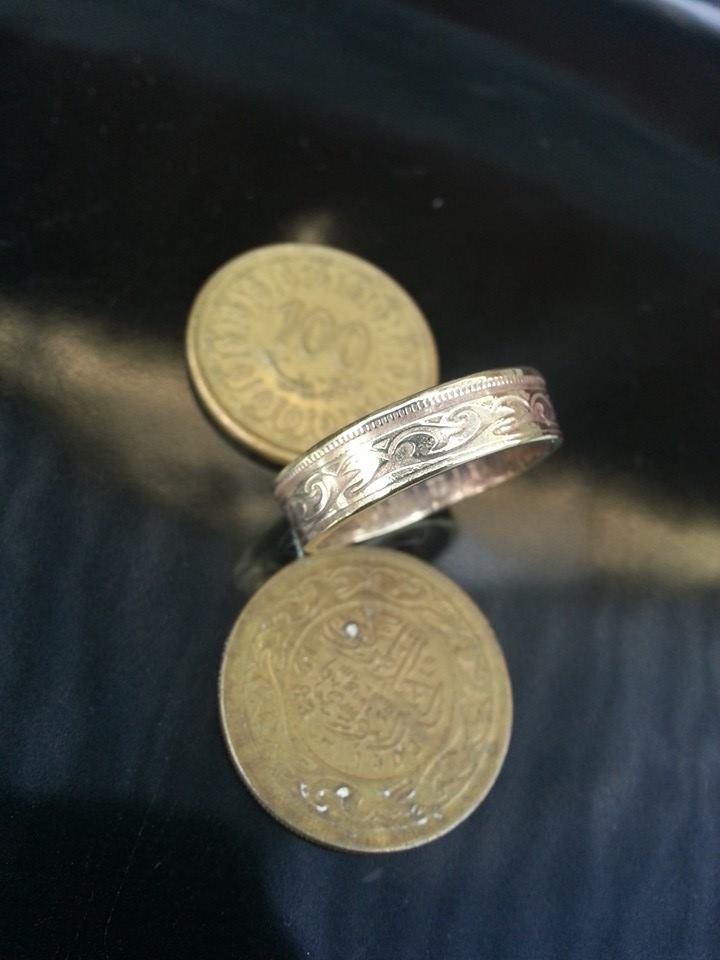

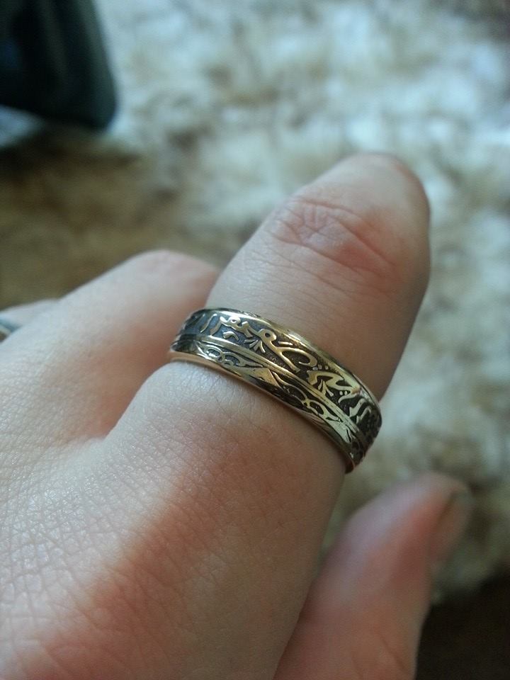

here's a couple of other finished coins
attachment.php
attachment.php
attachment.php

I've played with that idea (have all the tools and such) but never could get anything small enough for a center band without making either a really big pen or using a dime sized coin. By the time you fold them they get pretty big diameter.
Most of my pens are 15mm diameter, so that's not an issue for me. You would struggle for a slimline for sure.
Did you have the flange pointing towards the tip of the mandrel? As that way when you hammer it it's forced a little down the mandrel which will widen it. With the flange pointed towards your hand it won't stretch as much. This can be done with larger coins so long as you trim down the excess once it's been hammered into a ring shape
