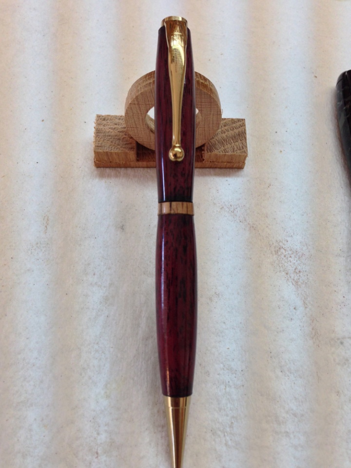

I have been turning "Creekline Slimline" kits since I started. Today, I got a variety package of Slimlines from PSI. It never occurred to me that the center band would be different in size. I decided to use the Purple Heart that I turned yesterday but realized that the center band with the PSI kit was greatly smaller. A good friend had mentioned to me to make a center band so I gave it a shot. I used a piece of Oak and made a center band. Okay, it is far from perfect but I am still a newbie and never attempted anything like this before. Heck, for that matter I am a newbie to working with wood, tools, and everything. Love it though.

Far from "Perfect" maybe, but isn't it fun to try other ideas and have them turn out well. I love the colour contrast, and I just LOVE Purpleheart.
Great job with this and keep experimenting.
Thanks for showing.
Bob.
I just threw away a bag of centerbands. I see you'll soon have a bag of your own. That's a really cool pen. You also don't have to follow the bushing sizes when you make your own centerbands. Next, you can try your own finial. There are just endless ways to customize a slimline.
Good work! :good:
Mike; I knew you could do it !! Sometimes it just takes a little problem to move you on to the next step, than you never look back. Jim S
beautiful!! and i hope this isn't rude or considering hyjackin a thread, but do you laminate the wood for the center band to the top blank or just turn a seprate one?
Laminate it to the top blank, that way you don't have to worry about the size being off. You can also turn the band larger than the rest of the blank to make it stand out or fit over the lower barrel. Jim S

mjrbuzz,
I had to make this center band separately but you can do it prior to drilling and inserting the tubes. The guys on here can tell you much better than I can but in this case, I did glue the center band that I made to the lower barrel. Hope that helps.
