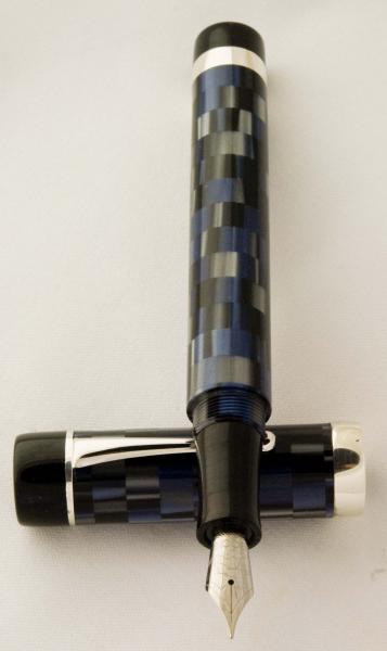

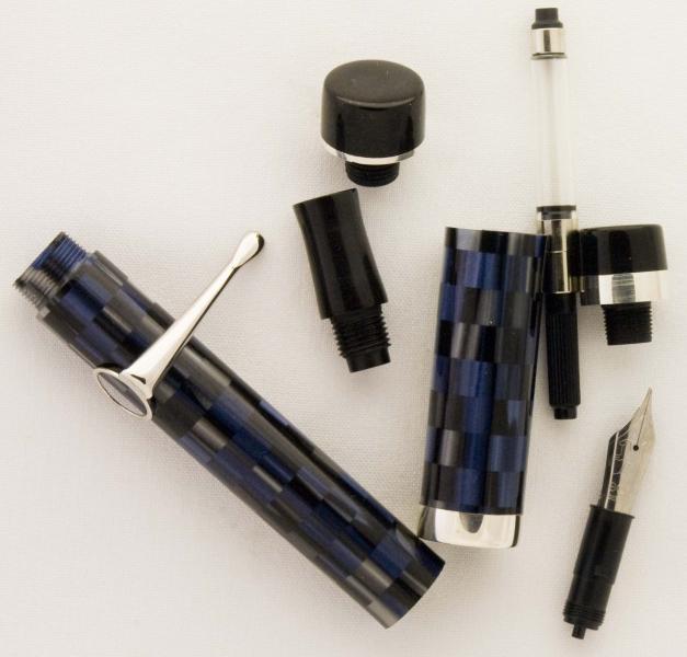

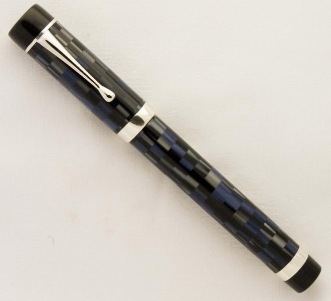

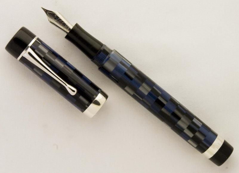

Finished it this A.M. It's a custom fountain pen made with a Blue/Black Mosaic Resin for cap and barrel, Black Ebonite for finials/section and 16 gauge Sterling Silver for accents. Has a #6 Medium Point Polished Bock Nib. The silver bands in the pictures have the reflection of my camera...sorry. Comments and/or questions welcomed. Thanks for looking. Regards, Doc:smile:

As usual, very nice Doc. What did you use to glue the silver to the ebonite and PR? If epoxy what type?

Wow is the only word that comes to mind! I gotta ask, did you sleeve that center band accent or glue it to the blank?
Dan, Thank you! The center band is sleeved on to a tenon in the mosaic resin prior to drilling the cap. The band on the ebonite finial is also sleeved onto a tenon that was turned. I use 5 minute epoxy but let it set overnight.

Lynn, Thank you. I used 5 minute epoxy but let it set overnight just to be safe.
I like the nice straight tubes with the accent bands and the contrasting finials. Geometric pattern of mosaic acrylic works so well with your detailing! Beautiful work as always, Doc!

I think the sliver bands and ebonite really compliment the patterning in the body, and the silver looks soldered and polished to absolute perfection! To my eye, the width of the CB and lower barrel look to be about the same...are they made to mirror of each other?

Dawn, Thank you! The bands are supposed to mirror each other...got the idea from a recently issued Conway-Stewart ebonite and silver offering.
