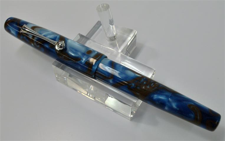

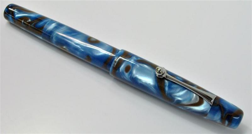

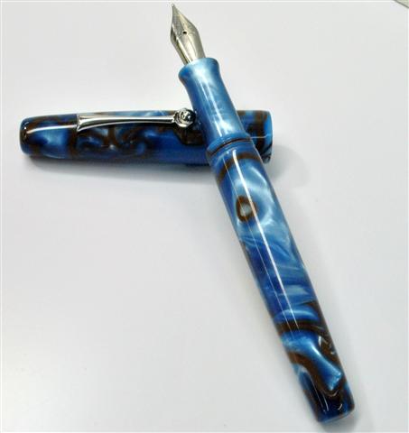

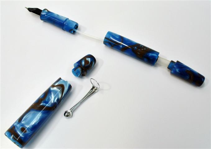

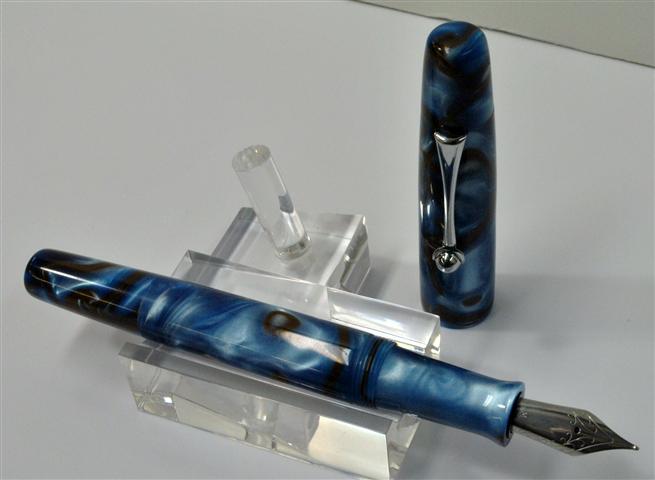

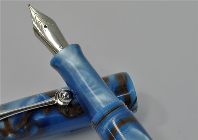

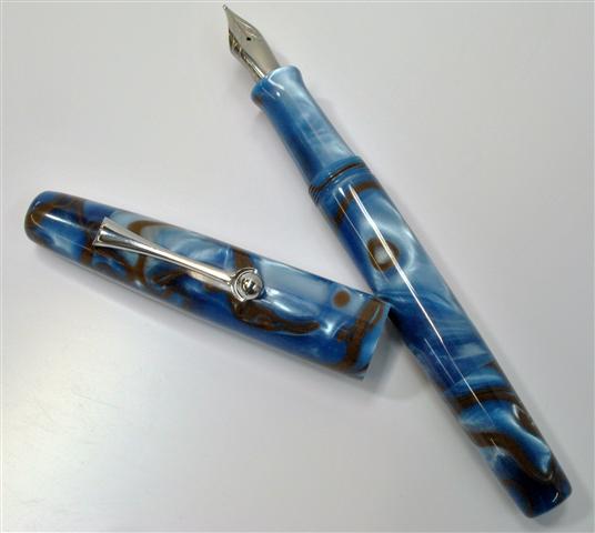

Made to a client's specs, the blank, the bulb, and tubing came from Richard Greenwald.
Length 5.75"
Length posted 6.75"
Length w/o cap 5"
Cap diameter at widest point 16.5mm
Barrel diameter at widest point 14.5mm
1.5 turns to thread cap onto barrel
Ink capacity 2.5ml
Cap/barrel threads 14 x .8 (triple lead)
Barrel/section threads 12 x .75

The pen is beautiful,the workmanship is nothing short of amazing.
I love the long section it gives the pen a nice balance and flow.
Like I said before ,I watch and try to learn from the guys like you,you create a new pen
almost every time not just changing blanks to make another one.
Nice touch Robert, I wanna be like you when I grow up!!!!
Mark
Robert,
Beautiful blank and top notch craftsmanship. Just think the cap is a bit long IMHO. Still way above my skills. Great job overall.

Beautiful job as usual!!! That resin is incredible and has such depth and movement to it. Section looks very comfortable. Very clean and crisp features. Photographs are great. I'm sure your customer will love it! You keep inspiring me to push further! Regards, Doc
Terrific! Definitely an all time great.
The vivid color is wonderful and the lines are so elegant. You've outdone yourself! Judy
