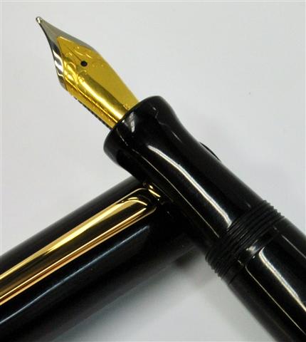

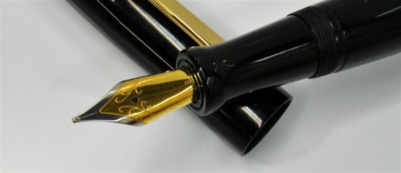

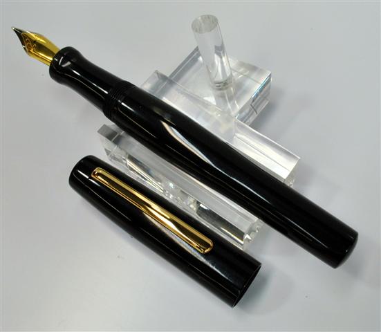

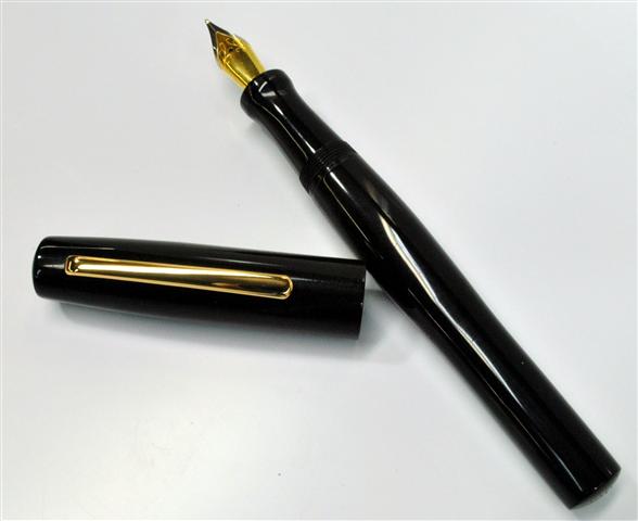

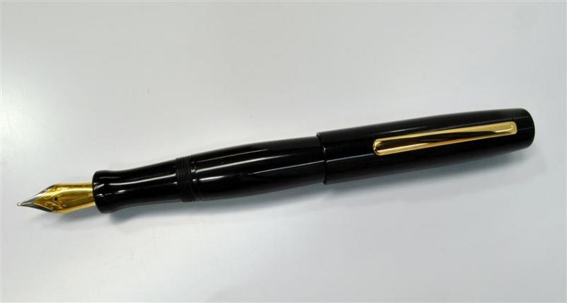

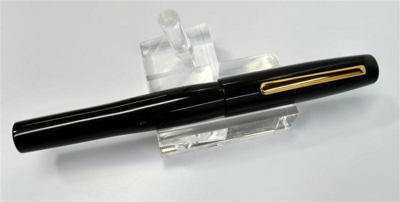

At the risk of confounding the members, I present a stick with a clip. I wouldn't be surprised if most fountain pen buyers much prefer it to Big Red, the last pen I posted. Fountain pen people are different. Those who want to sell custom fountain pens need to learn more than construction techniques. There's the culture to absorb. Best way to start is by carrying and using fountain pens.
This shape was specifically requested by a customer--the shape is new for me. Posted length was to be 6 1/4" or less.
Overall length 5 5/8"
Barrel length (inc. section) 4 3/8
Cap length (inc. finial) 2 1/2"
Posted length 6 1/8"
Section length 1"
Cap diameter 15.8 mm
Barrel diameter 13.75 mm
Section diameter 12.75 mm
Weight 21 gm
Cap/barrel threads 14 x .75
Section/barrel threads 10 x 1
Cap/finial 8 x 24
Clip is from the PSI Designer Twist BP kit
