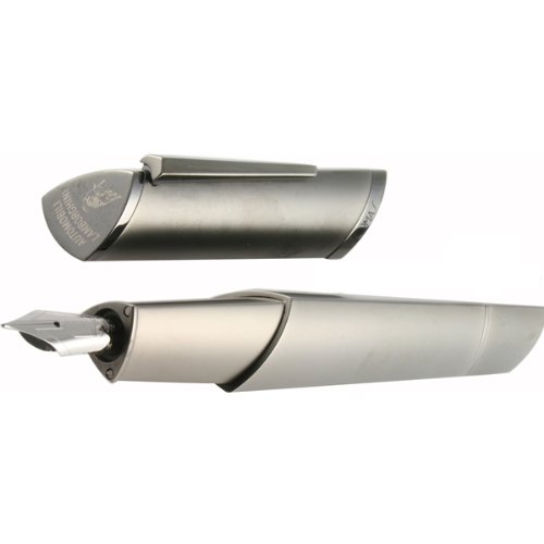

Hi Guys,
I want make a similar shape to the lamborghini FT.
Metal lathe can do so much. Can I adapt a lathe for example to make a 4 axis?
What machine or tool do I need to create shapes like this for aluminium?
Input will be grateful!!

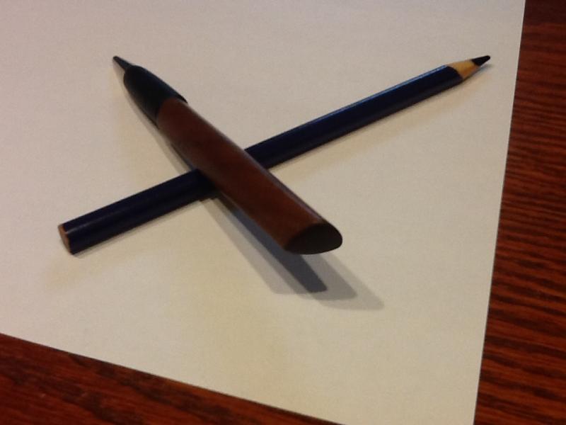

I know this is a lousy picture. I took it with my IPad. hopefully u can see I made a triangular pen on my lathe as a prototype a while back. The only way i could make it work was to make it a closed end pen. It is now the pen I carry. It is quite comfortable to use. It is a long of process to make it work, but I think it could be a cool pen to make. If you want more info on how I did it, just let me know.
I do think the lost wood technique could work for the cap.
