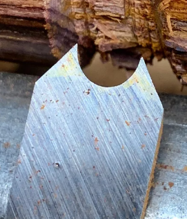

Are you referring to a beading tool like this?
Used like this. Video Link
Or like this. Video Link
