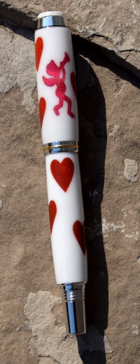

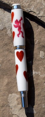

Scrolled Cupid from Pink Buckeye Burl <lazerlines>, and scrolled hearts rotating around the pen as well as one on top. :biggrin:
My wife says it's tacky. :frown:

Phunky_2003
May 18, 2009
1,470
Bonham Texas
I dont think its tacky at all. I think it is pretty nice. I would carry it and be proud. Did she say she would like it more with less hearts or something maybe? Maybe just the cupid on cap and hearts on the body?

Who knows with her. She says she doesn't like bigger pens and she isn't into cupids or hearts I am guessing.

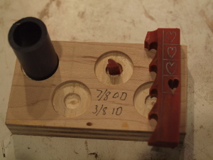

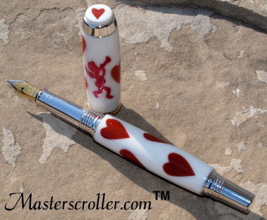

Here's my finial button.

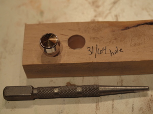

Drill a hole, take a punch and whack the pin to remove the old button.
Forestner bit..drill a shallow hole to fit the pvc pipe, and another shallow 3/8 hole in the center of that. Cut a heart out that is smaller than 3/8 and glue in center of middle hole, then glue the pvc into place.
Pour in resin, pressurize to 60 lbs...let sit for 5-6 hrs, because it is such a small pour it needs a lot more time to set up and cure.
Cut pipe pieces around the plywood.
Mount pipe into chuck, part off the plywood. Spin the blank round to be the same OD as the old button.
Polish and wet sand the button.
Part off the button.
Rough up inside the top of the finial and glue in new button with epoxy.

ThomJ
May 14, 2010
807
Fairlee, VT
Boy I kniow exactly what lady to give that too if you are having problems with the wife liking cupid. That is a great looking pen Jeff
LarryDNJR
Feb 28, 2010
912
Columbus, OH
Very Nice Jeff. Not something I'd personally carry around but I can see it definitely is a great pen and someone will be happy to have it somewhere. :) You never cease to amaze me with your works!
Toni
Feb 23, 2010
2,042
Phenix City, Alabama
LOVE the pen Jeff~!!! Love hearts its perfect just the way it is!! I dont think its tacky your wife is probably used to your more manly stuff. Great design!!!
