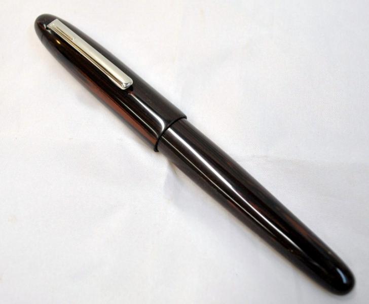

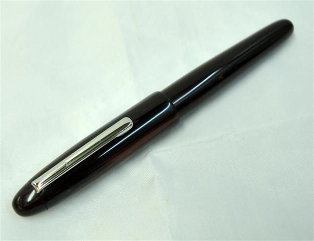

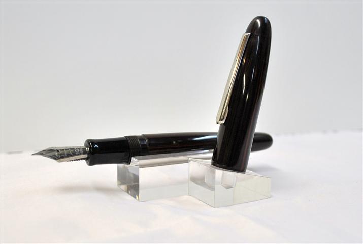

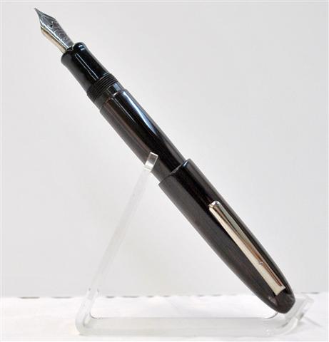

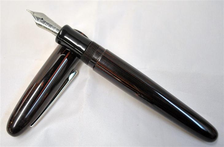

I posted a cracked ice prototype of this pen last week. My customer got his in Cumberland--gorgeous stuff!
Same dimensions:
Length capped - 6"
Length uncapped -5 1/8"
Length posted - 6 1/2"
Barrel diameter - 9/16"
Cap diameter - 5/8"
Weight - 27 grams

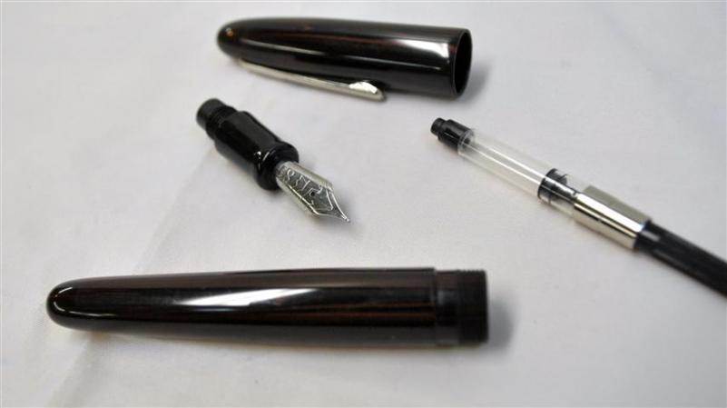

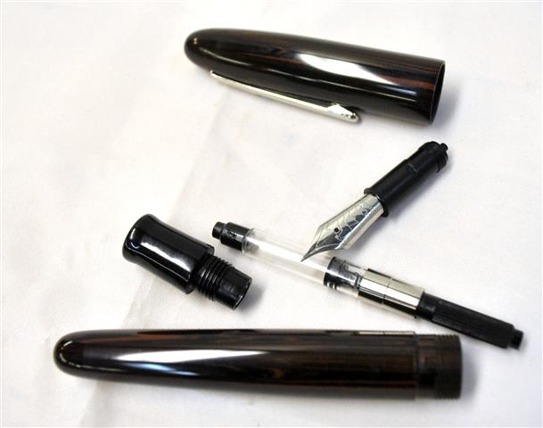

The most difficult part was the cap/finial/clip joint. On the Sailor, that joint is at a point where the diameter is just 10 mm. The Cumberland further complicated the process because of the need to match the grain.
Black ebonite section. The polished nib is a #6 Bock.
Thread
section/barrel - M10 x 1
barrel/cap M14 x .8
cap/finial 1/4 x 32
