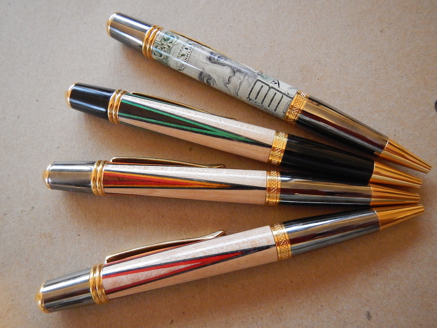

Trying points like are in pool cues.
Using colored veneers.

Nice job!!! I want to learn how to do the pool cue pen that a guy does up in Colorado Springs. He is supposed to be making/producing a dvd on it. He uses a slimline as the kit. Hopefully it will be available soon.
Very nice. These are on my to do list. Not sure if you have or not shared how you make your points on these. Would you consider sharing and I understand if you do not want to. Thanks for showing.

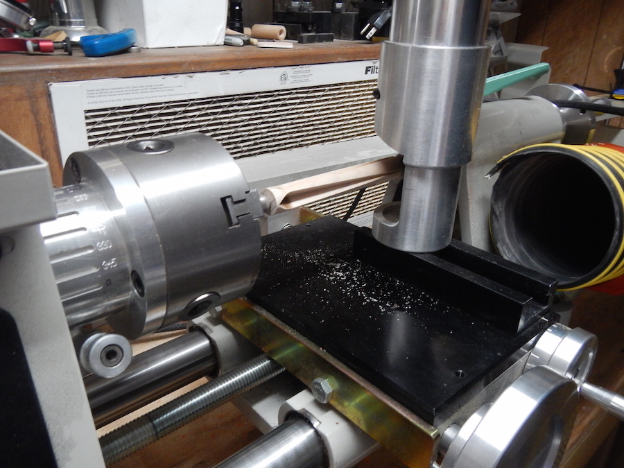

Of course I will share ... that is the way I learned.
It takes a lathe or some way to index the blank to the 4 positions needed.
A router using a 90 deg bit cuts the pockets at a taper ... in other words as the router travels from right to left it also travels into the wood.
Depth and angle is critical to the pen blank you are cutting.
I am cutting some blanks monday and can post some photos then.
After you got the pockets cut then you need to make the veneers and wood point to fill them.

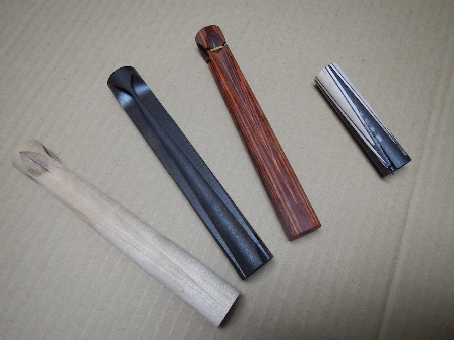

Cue Pen Blank Cutting
Here are some photos of the blanks and how the router mounted on the lathe cuts them.
The lathe has an index collar that will position the blank at the proper deg rotation for each point.
I know not everyone has this equipment to use and if you still want to try your hand at building one of these pens the cut blanks as shown in the photo will be available in the near future. When I make another one I will post some photos about fitting the veneers and finial point into the "V" cuts.
The pockets could also be filled in with Inlace or some other similar material to get floating points as well as traditional pool cue type points.

The router idea is similar to Skiprat's. Willee is using veneer instead of a solid piece to add color and detail to the pattern. Excellent innovation! Makes a stunning pen. If you are willing to settle for only two patterns, one on each side of the pen, it could be done with building a lamination with no need for a router. The problem would come in centering the drill hole.

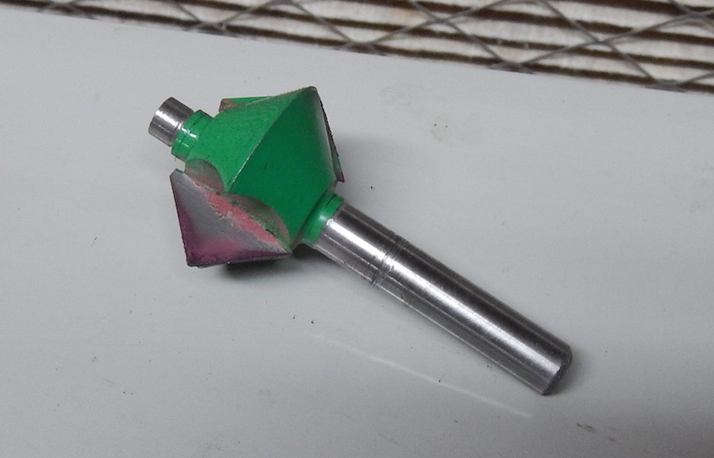

Interesting. I would have thought the router would be oriented differently to cut with a v bit. What bit is used here?
Thanks.
Thanks.
I believe that is a V bit, but the cross slide is connected to the taper attachment (Cue lathe).
