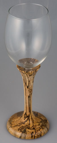

Who here makes the wine glasses that CSUSA sells? I like the look of them and thought about trying them I just haven't seen many finished ones and didn't know if there was a reason for that.
What size wood would be suitable for the base? I was thinking at least 2.5", if not a 3"
Any issues using glue ups to make a thick enough chunk of wood to have a stable base?

I did one last year. The CSUSA wine bulb worked well, but I think an inexpensive wine glass with the stem cut would do just as well. I'd recommend a 3", or even slightly larger diameter base for stability. I believe a glue-up would be just fine - you're not going to stick this one in the dishwasher after all (I hope).

I have done a few, the general rule that I try to use with those is to make the base approximately the same diameter as the glass for stability and symmetry. You can go larger, which will give you more stability (especially if you do a very long stem), but it may seem out of proportion if it is too big... But hey, you can always easily make it smaller if it seems too large to you.
Good luck, and enjoy.
Here is some of the ones I have made with Aspen wood.
