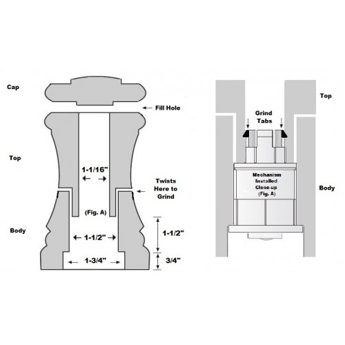

the crushgrind 'wood' no-shaft version can be a challenge compared to the "typical" old school USA grinder or the crushgrind shaft version. the reward of getting your hands around the crushgrind wood version is you can do some funky cool mill designs.
i have attached a crushgrind wood spec so you get an idea of how it is created.
