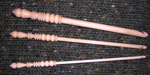

Turn the whole crochet hook! Its simple and takes 2 minutes with a rat tail file to make the hook. I have seen hooks as big as 2 inches in diameter for folks who do lace work!
These are not mine I did a google search..........
To make the handles first get a set of the transfer punches from, I use them as mandrels. Measure the diameter of the hook shaft, drill a pen blank to the closest size. Drill only to the length if the shaft on top of the flat spot. I use a drill chuck with a draw bar in the head stock to hold the transfer punch. Some of the hooks are so shirt that I have cut the punches to get them short enough. Then turn the blank using a live center in the tailstock. After cut to shape, I sand then parted off the excess.
These were made out of poplar and or maple, not sure what I used and then dyed the various colors.
