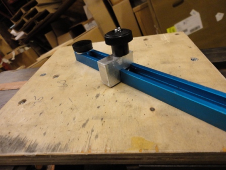

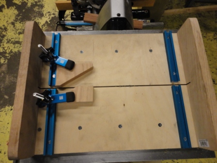

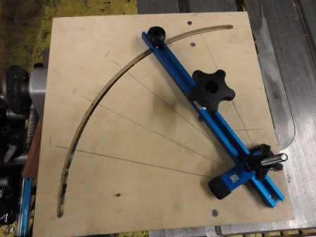

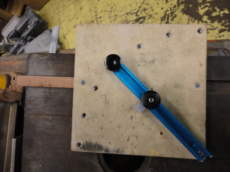

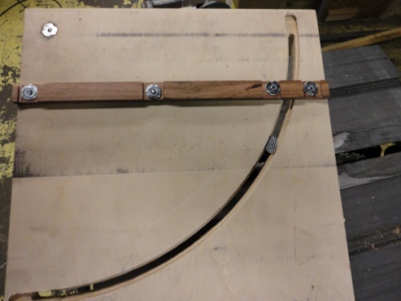

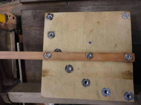

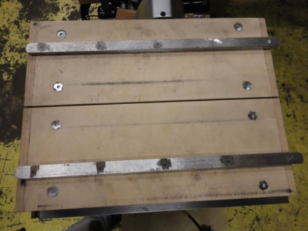

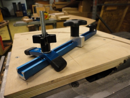

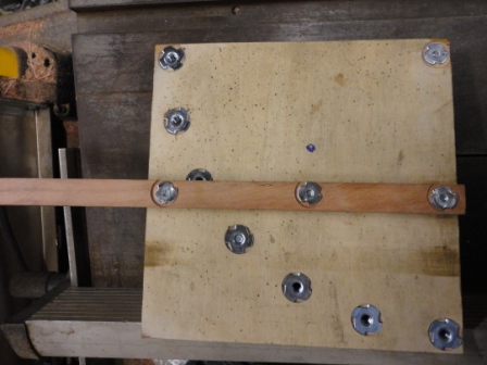

Been trying to find a better way to do some segmenting, and I've come up with three different sleds. Two for my shopsmith and a smaller version for my bandsaw. Since everything is a little smaller than normal, I was able to use T-Track for the angle guide and clamp rails. Even fabricated a stop for each angle sled.

Thank you for sharing. Angles can be perplexing and you have made it simple.
I tend to cut on the right side of my blade and get confused with some angles and wood placement for safe cuts. Your sled with angles on the left was a great help.
