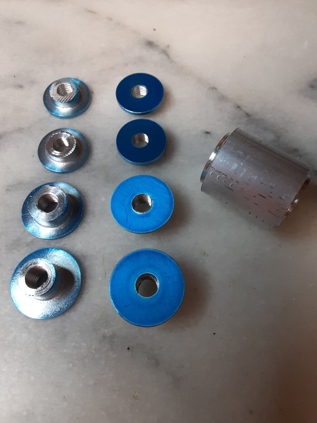

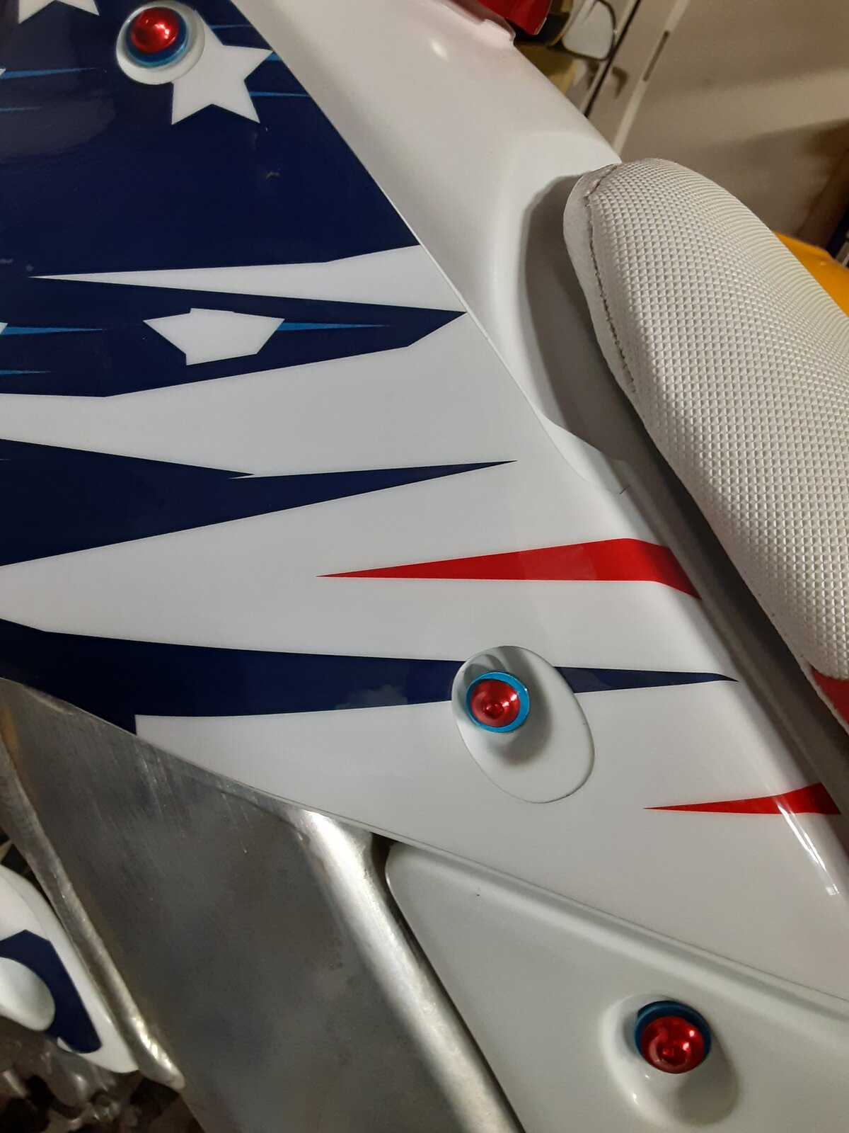

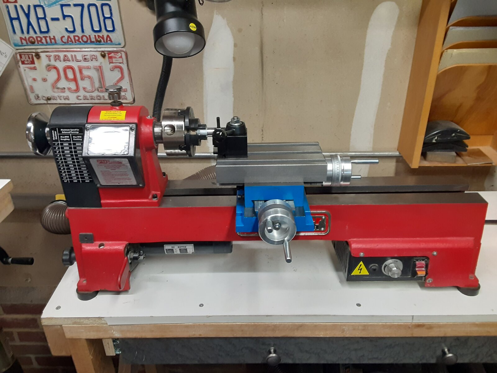

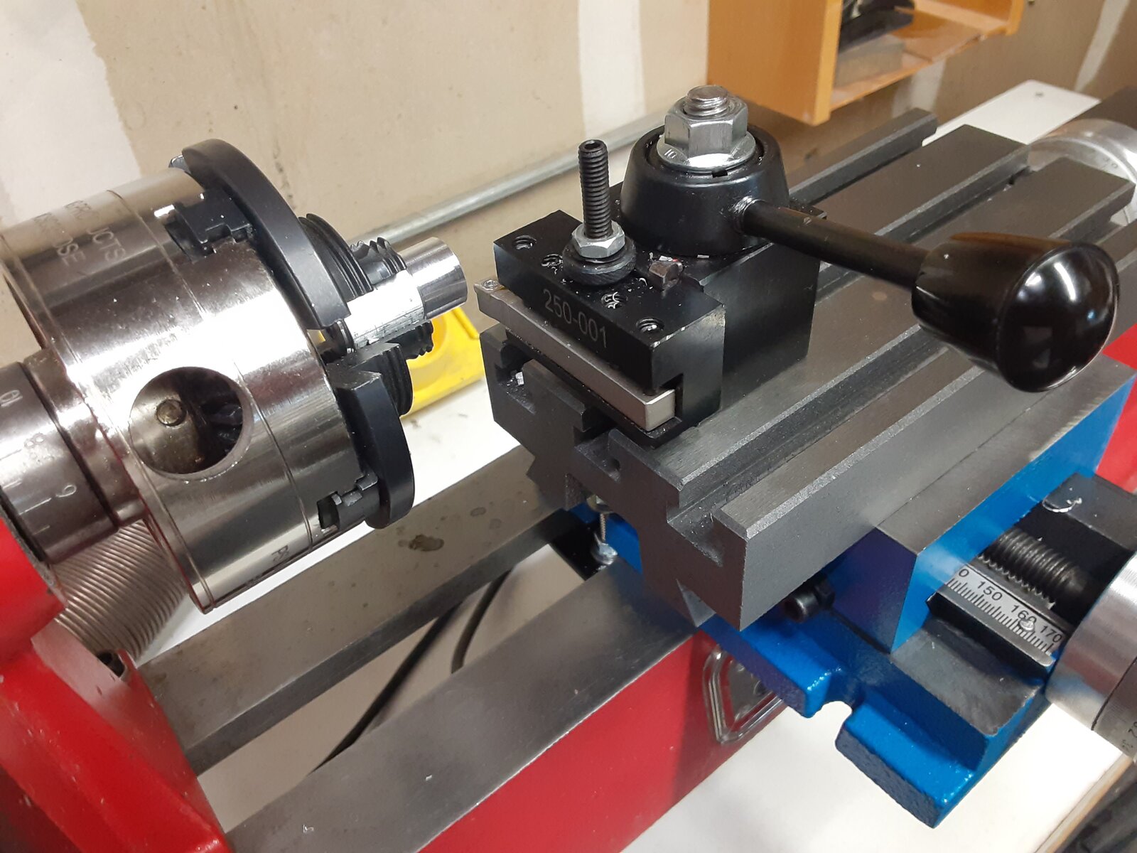

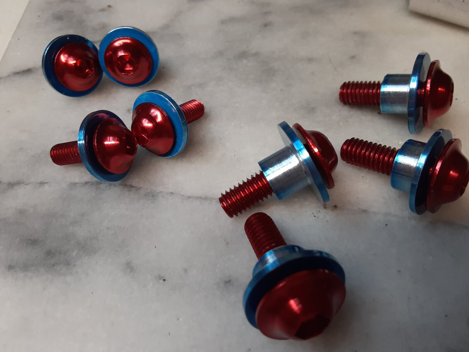

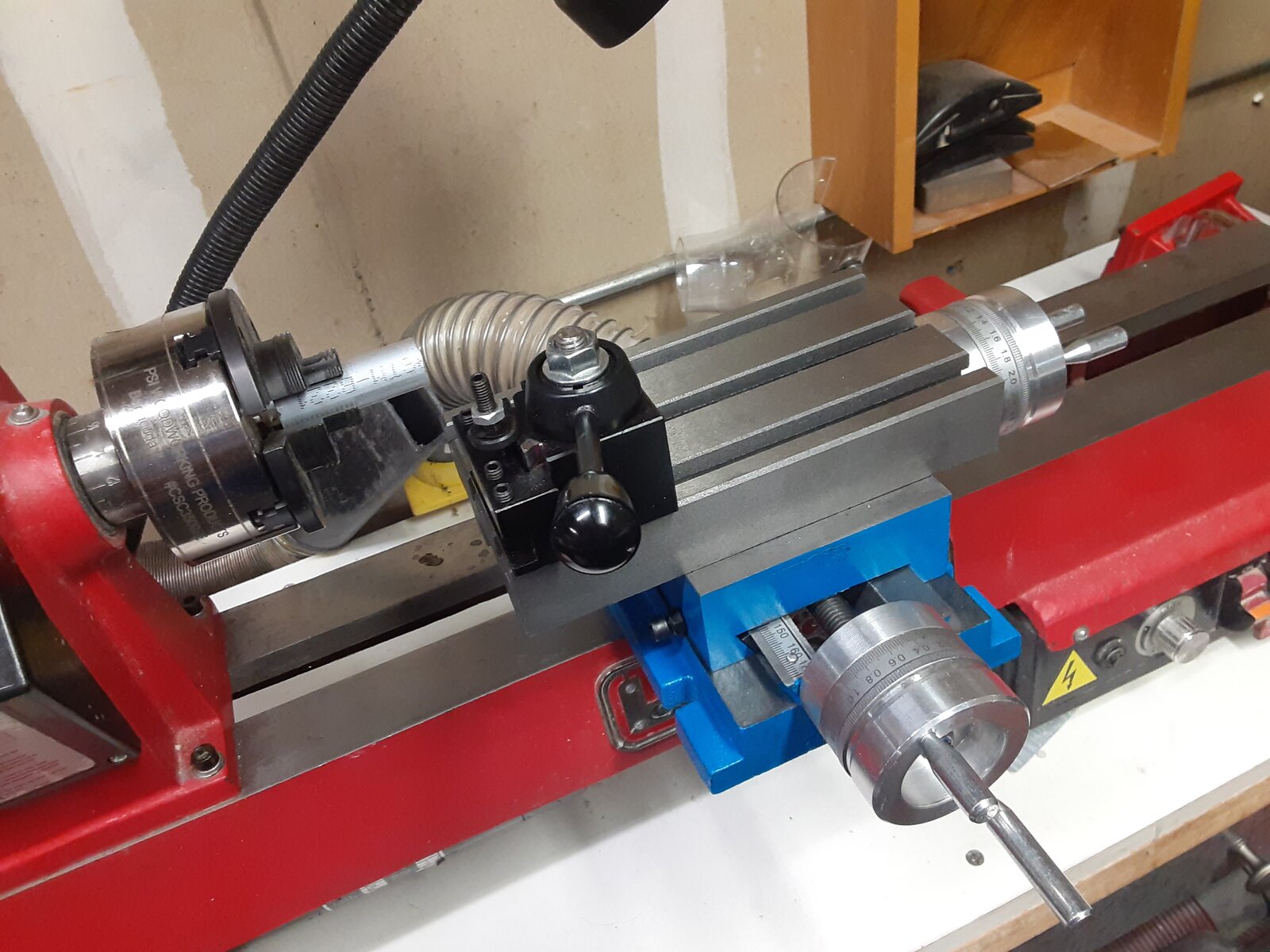

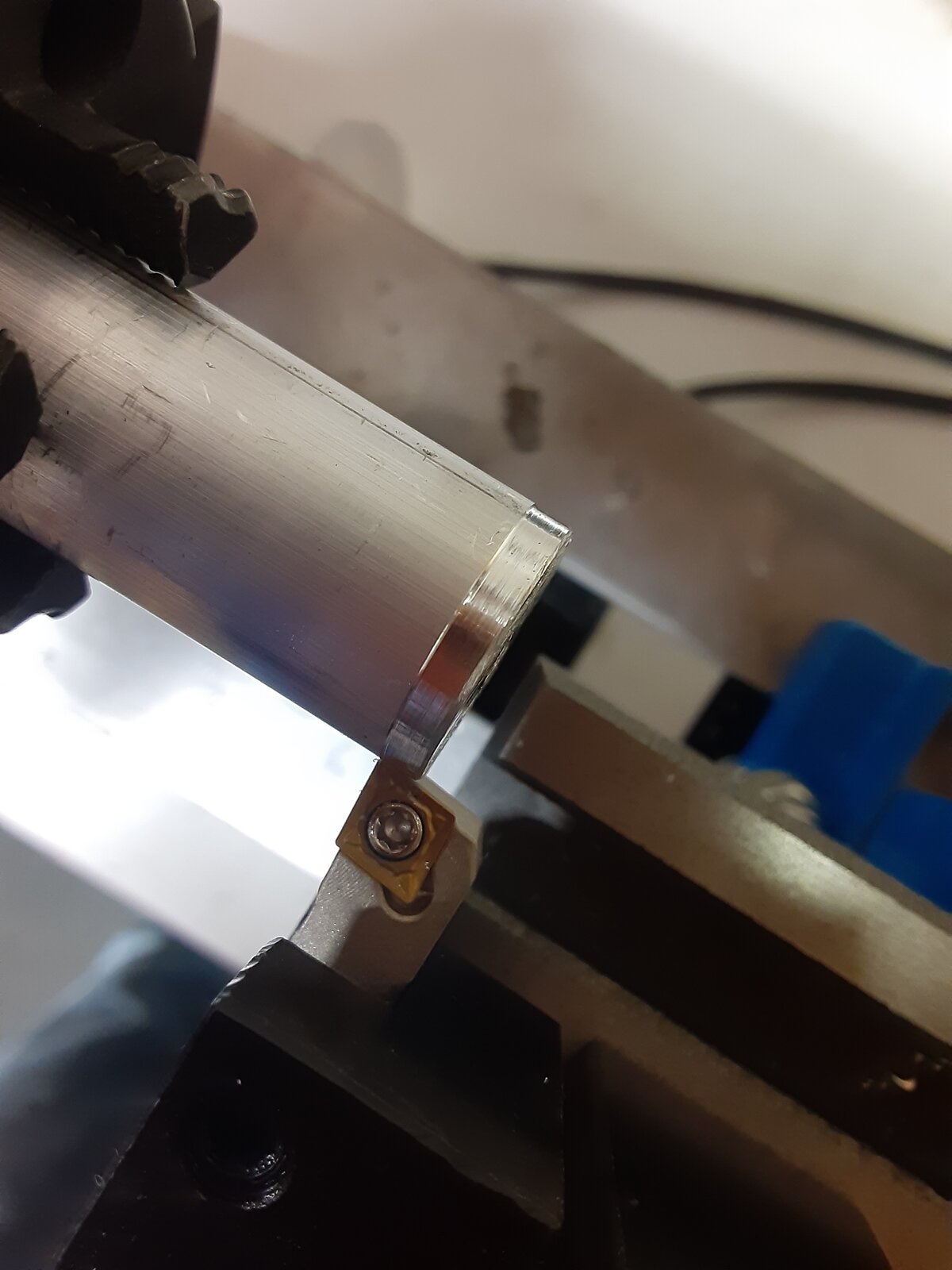

I got an inexpensive cross slide. Mounting was simple. Just a plate underneath. I added a quick change tool post. Wedge type OXA in steel. Got inexpensive cutters from Lowes (Wen). I have made custom parts for my dirtbike (199( CR125). I am on pause, but am making a different pulley to get a little slower speed. Mainly though to practice metal lathing!

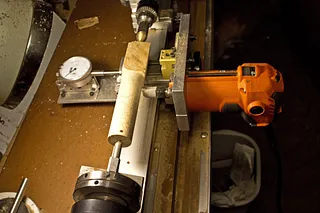

I traded some blanks for a cross-slide (think it's Grizzly) several years ago but I'm still (ahem) "waiting for that perfect time" to fit it to my lathe. These pix have nudged me into thinking about it again.
One advantage of the quick change tool posts, is the tool-holders have a height adjustment. This makes setup a little easier. Regardless of the cross slide. BTW, the one I picked was around $80, cast iron, and pretty smooth for the price. I have the 10" turncrafter, and went with the OXA size tool post, turns out with the smaller cutters, I have to adjust all the holders almost all the way up. If it was going on the 6" bed, this setup would need a plate under it all. AXA size might help with that. But the biggest concern to me, adding 3 unknown parts, and hoping I could get the cutter to center.
One advantage of the quick change tool posts, is the tool-holders have a height adjustment. This makes setup a little easier. ... the biggest concern to me, adding 3 unknown parts, and hoping I could get the cutter to center.
Good to know, thanks; my concern is that the top of the cross-slide on mine might be too high, resulting in all tooling being above center, but I haven't done any proper measurements. And for some of what I have in mind, it might not matter, the lathe will be mostly acting as a fixture to hold the blanks while the cross-slide moves a Dremel around in a controlled path.
