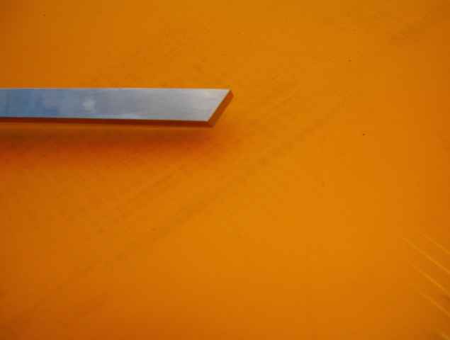

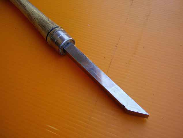

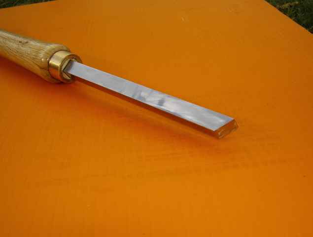

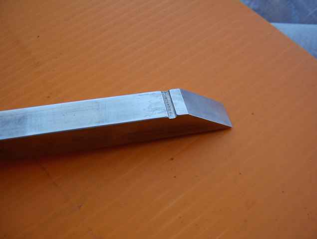

I was introduced to the Bedan by Jean Paul Escalon at the time I was doing hundreds of wooden eggs, an item that the Bedan exceeds most other tools so I made 2, one 12 and a 16mm. The angles are not exact and testes have proven that about 60°, the tool performs a lot better, but you will see that the angles on my Bedans are different, that have to do with the shaft size also.
Anyway, pretty much like the skew, some love it some hate it, there is not much in between, really but, I like to use it/them when I'm doing something that calls for Bedan, if you know what I mean...!:biggrin:
I've attached a couple of pics of my Bedans so that you can have a close look...!
Cheers

Thanks for pointing out the Bedan -- not a common tool in the US but useful. Cindy Drozda uses it for one. Heavy shafted skew is one description, and square parting tool is another.
George -- I cannot tell if you have relieved the side to make a trapazoid (bottom is more narrow than the top) or not.
I can see where that would be a good tool choice for eggs. I was making darning eggs for the fiber person recently and while I made less than a dozen to get the shape she wanted (she did not want a classic egg shape on the large ends -- more flat for darning) I am not at all ready to make hundreds!!!!

The bedan does have some side relief angle though, and are not square or rectangular: kinda like a triangle with one point lopped off. (I tried to "write" one in, but it did not work)
They are great beading tools, great parting tools, except typically a little wide,
superb tennoning tools, and as Peter pointed out, excellent for egg work.
