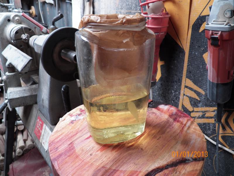

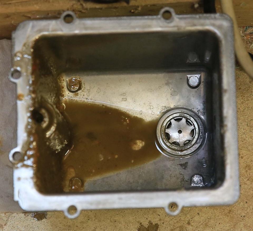

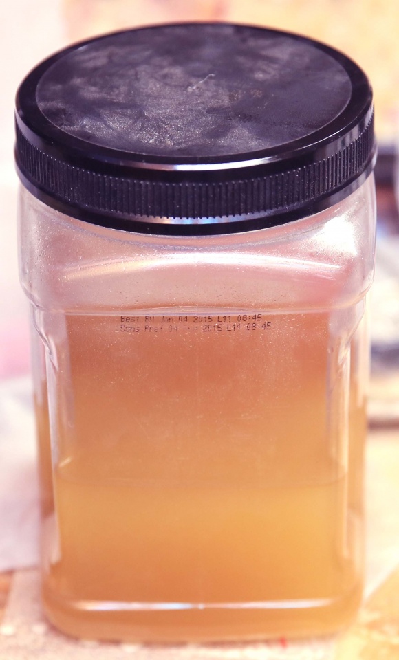

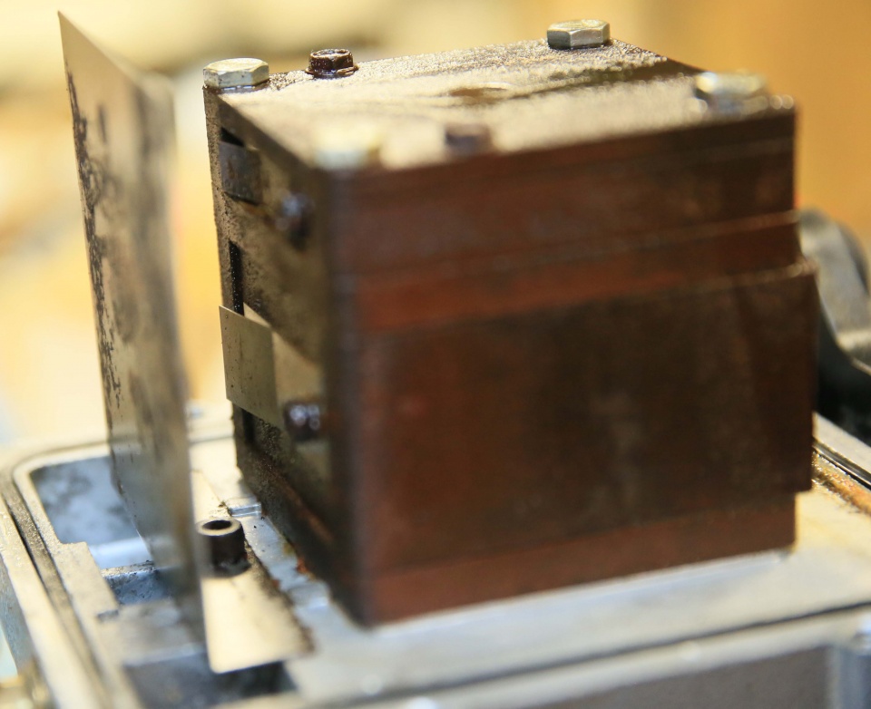

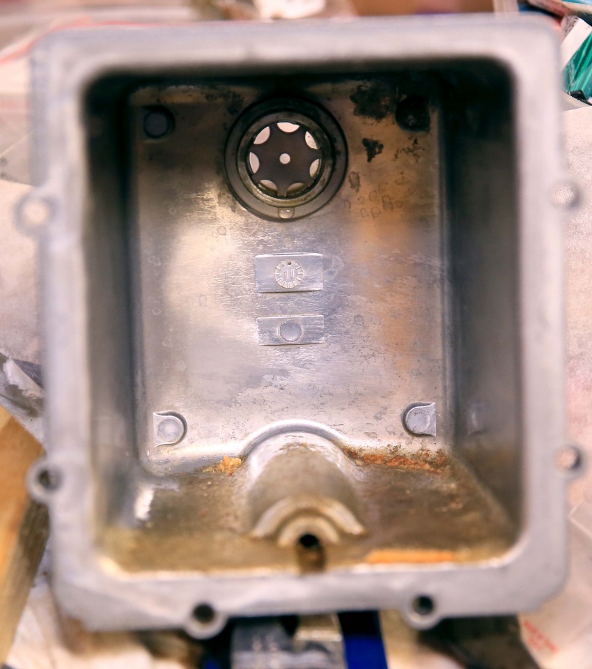

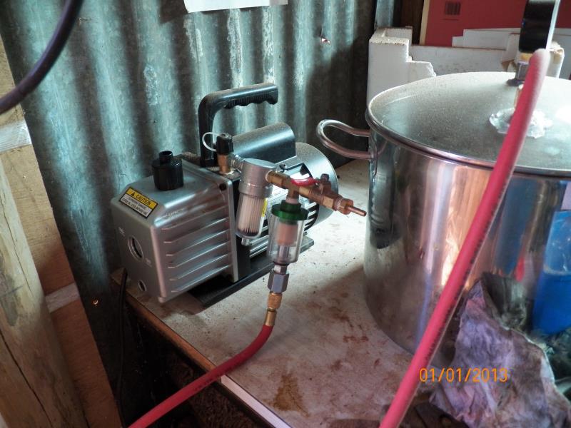

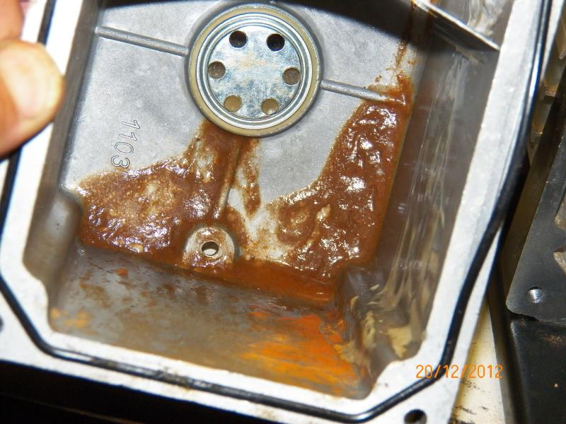

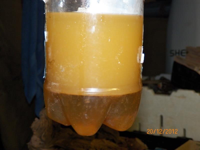

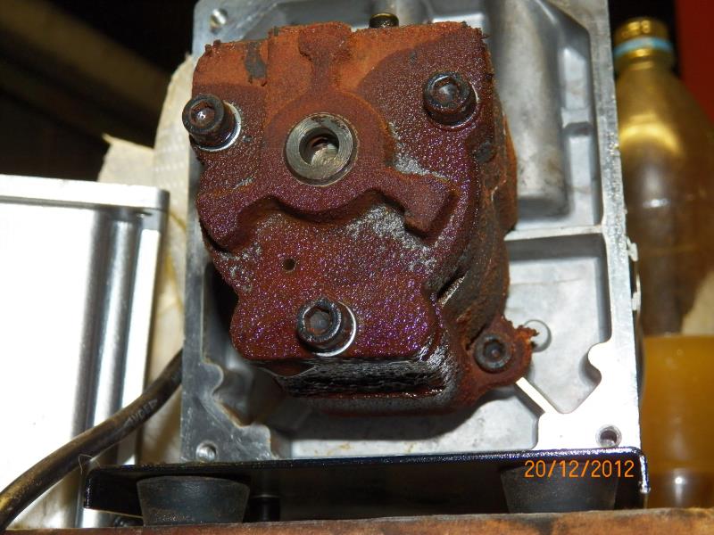

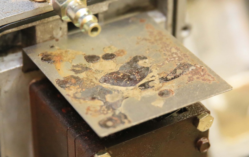

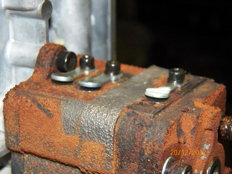

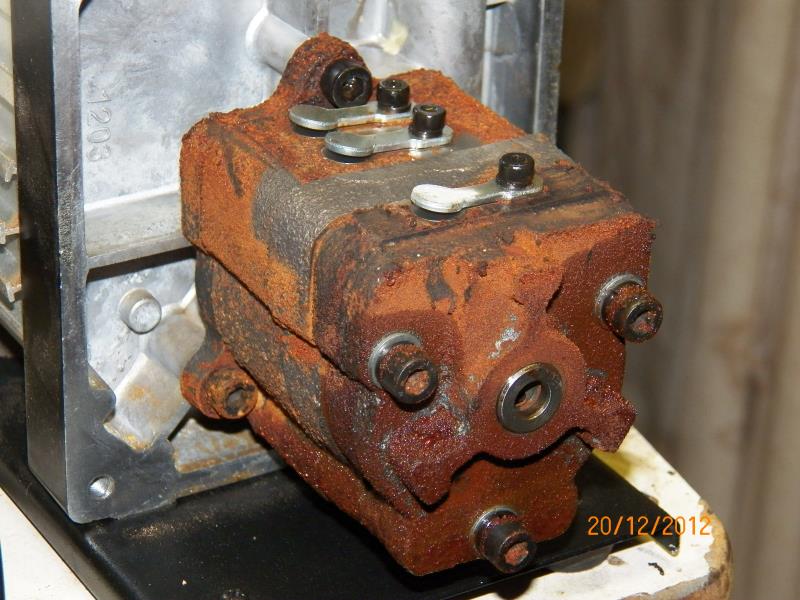

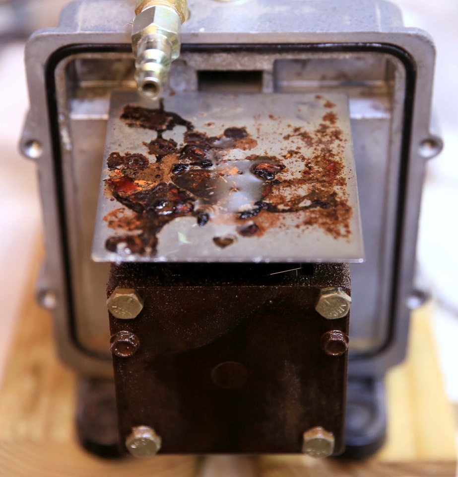

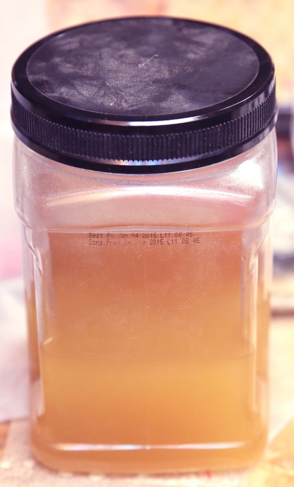

I have drained the oil and taken the cover off, so that I can change the oil and look at the exhaust valve as Curtis suggested.
I have a bunch of pictures attached.
Picture 1: the oil, not clear at all, it appears to be very cloudy and contaminated. The fist comment I will receive is to ensure the wood is dry. This is only my fourth use, not sure if this enough for that much cloudiness.
Picture 2: this is the splash guard, it has several deposits of ugly brown goo!
Picture 3: this is inside the cover, there is a messy deposit of the ugly brown goo! From the parts diagram, this is a new version of the pump.
Picture 4: this is inside the cover, I have cleaned the goo and there appears to be some corrosion on the metal,
Picture 5: this is the splash guard cleaned, apparently the brown goo is rust/corrosion, there are dried corroded spots left,
Picture 6: This is a view under the splash guard of the exhaust valve that Curtis identified. It appears to be OK.
So my actual immediate conclusion, the vacuum pump was probably very dirty when I purchased it from a pawn shop, at least it ran! So, some more questions:
1. How do I clean the everything? I think that I can clean the splash guard and remove the corrosion. I am scared to clean the inside of the cover.
2. Is the vacuum chamber/cartridge damaged?? How do I clean it? Just run clean oil?
3. Does this mean draining some oil at every use and determining how clean it is?? If the oil is changed at every use then it could become expensive. The capacity seems to be close to a 1/2 or full quart and the JB gold vacuum oil is $14 per quart!!
4. Can I clean or remove water from the oil?? How do I do that??
I should receive 2 quarts of clean, new oil late Friday or Saturday and I can attempt that.

Have no fear, that pump looks fine. Just a little dirty and nothing more. Stop over analyzing it! JB pumps are build like tanks and I have seen the insides MUCH worse than this one and the pump still worked fine and is still plugging along in a friend's shop.
Feel free to scrape off the crud with a razor blade and clean up the OUTSIDE of the cartridge with a scotch brite type pad and wd-40 if you really want to thought it is not necessary. If you are really feeling anal and want to make sure it is clean, after you clean the inside as you see fit, put the cover back on and add just a little oil to the pump. Then pull your hose off the chamber and stick it in a cup of vacuum pump oil. Turn on the pump and allow it to suck oil into the pump. Now drain it again an you have flushed the cartridge.
Again, the pump looks fine so don't sweat it. This will keep running in MUCH worse condition!

But, a few more questions;
1. George and Curtis, can the oil be cleaned on this pump?? Is the cloudy contamination water? Can that be removed somehow??
2. What about the noise; both, my wife and I thought the pump was going to come apart. Will it settle down and stop during use? Or, do I just accept it??

Well, you can filter the oil using the normal coffee filters, slow but works. Unless the oil is fairly new, I wouldn't bother, I was a little annoyed when I found out the average cost of a gallon of vacuum pump oil, (about $100) but I didn't accept that so a searched a little more and I found vacuum pump oil for under $25 per gallon, that I can accept and will last you a long time...!
I wouldn't be worried about the noise...! I don't, anymore...!
When I open my pump sump, mine wasn't much different than yours (look bellow), a good scrub and was all clean again. Following my advice on bleeding the oils before every use, will stop all that "gunk" to accumulate on the sump and be continually mixing with the oil, the process of bleeding is very easy and effective with that made screw and the knob, it works wonders.
Cheers
George

Vacuum pump spitting oil
I cleaned the pump of corrosive crud, reassembled, and added new oil.
The new vacuum pump oil is the clearest, most pure looking oil that I have ever seen!!
But, after I turned the pump on, to test the seal and make sure there are no leaks, the pump started to spit (expel) oil out of the exhaust port opening. This was not happening with the old oil. Will this go away? I have the oil to the mid-level on the sight window. Did I put in too much? Not enough?
As a side note, the sound is great, essentially gone.

Mine does that, I put a 12" piece of vinyl hose on the port with a house clamp, with that length of hose it doesn't make it out.

2. But, I still do not understand how water can be removed from the oil so that I can re-use the oil.
First of all, never mix oils, you will regret it...!
To remove water from the oil, there many ways to do it but, the way I did it was to pour the old oil into a coke plastic bottle and let it see overnight, what you get is what I show on the pic above, where you see the water on the bottom.
Very gently (not to stir the oil and water), drill a small hole (3 to 5 mm) on the bottle bottom (side bulged plastic) and let the water run out, be ready to put your finger in the hole and turn the bottle upside down (if the cap is on). From there you pour the oil into a couple of paper coffee filters, already installed in a glass jar, as the above pic, also and the oils comes out fairly clean but, and unless you got the exact same oil to top up, disregard it...!
Cheers
George

All these type of pumps expel an oily mist, at certain stages of the process, it is possible that the old oil became to thick to create mist, the new oil as any proper vacuum pump oils, are very thin (viscosity) and they mist easily so, the way I found to resolve that problem was to use and empty 8oz bottle of thin CA and a normal paper towel. How, and where to cut the CA empty bottle and what to do with the paper towel is all explained in here...! Starts at page 6 through page 9 post #93 with the answers...!
Cheers
