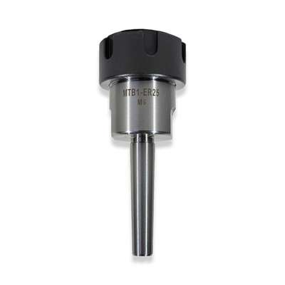

So I want to buy the er25 but I can not find with mt1 (Morse 1). Indeed, I also wish to use it as a mandrel with my wooden lathe.
But er25 in mt1 (Morse 1), maybe it does not exist.
On the other hand, it exists in er20. What could be wrong with using an er20 and the silvers that go with it?
I think that does not change much on tightening, am I wrong?

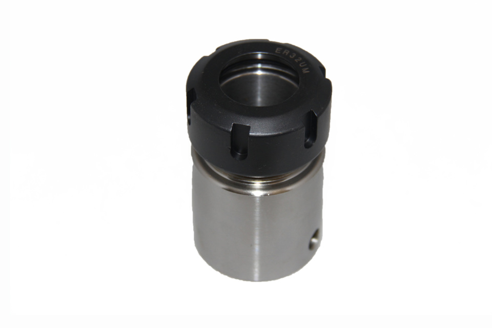

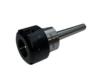

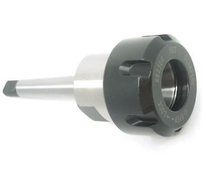

MT1 x ER25 chucks are available, I have one to fit one of my lathes, though I prefer to use the ER32 that has a thread to suit my headstock spindle.
Here is one on eBay in the UK
Or there are plenty of listings in China for half the price , I got mine from China, but not from this seller. I have had no problems with mine.
The ER25 Chuck goes up to a 16mm collet, is this big enough for your rings ? The ER32 goes up to 20mm which is more convenient, but I cannot find a Chuck with MT1, but if your lathe has a common sized thread on the spindle, they are available .
I got mine from Vermec, Enzo makes them to order, he may be able to do other threads than what he has listed if you talk to him. He provides a very good service and his products are top quality.
In my opinion, it is definitely worth having the extra capacity of the ER-32 collets. This will allow you to do as Fontainbel recommends in his posts on the Fountain Pen Network thread - avoid getting "tooth marks" on your ring by wrapping in a plastic sheath (he recommended PEEK).

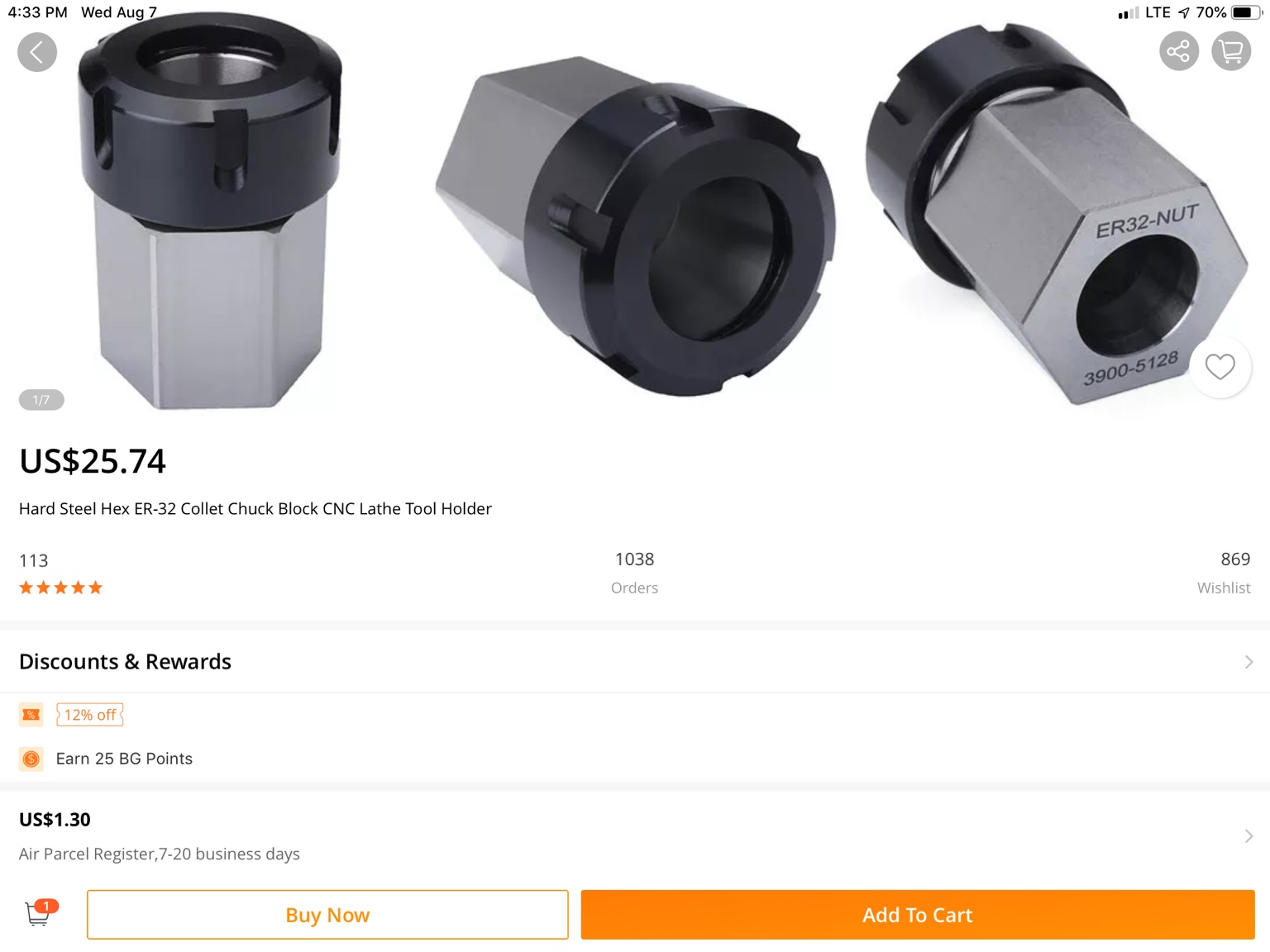

My ER-32 collet chuck screws onto my headstock spindle - I am also thinking about getting one of the square (or hexagonal) collet chucks that I can hold in a bench vice.
Collet chuck with square base is available for $22 from Banggood. I've placed 15 orders through them without issue. It just take 2-4 weeks for shipping.
They also have individual ER 32 collets for $4.99 and a set of 19 for $69.99
