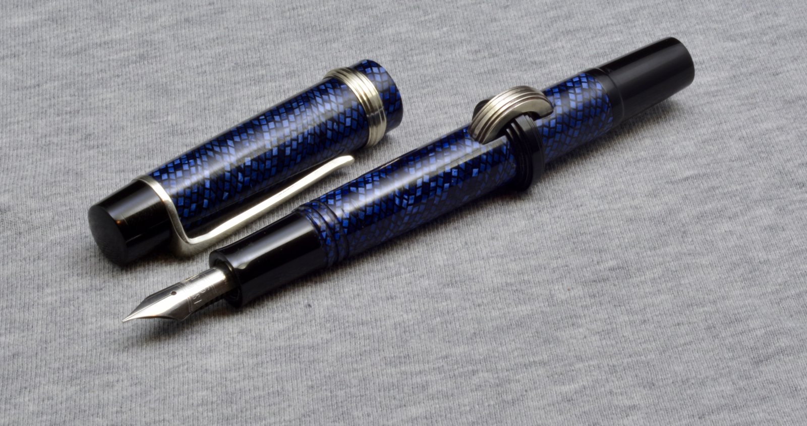

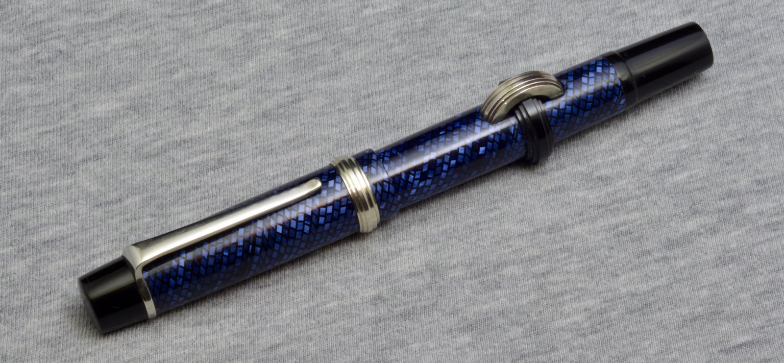

I just finished up this crescent fill fountain pen. It's based off an old design, and something I'd wanted to try for a while. It uses a sac as the ink reservoir, and the mechanism to fill is a pressure bar that's attached to the ends of the metal crescent. The black plastic ring prevents the crescent from accidentally being depressed, and expelling the ink. To fill the pen, you rotate the ring until the slot in it aligns with the crescent, then you press the crescent down and release it while the nib is submerged in ink. Here is a video :
I made the pen from vintage lizard skin cellulose acetate and black acrylic. I used nickel silver for the metalwork rather than stainless, since I can solder it easily. To keep the vintage theme going, I used an old esterbrook nib.

John, that is so interesting and novel !!! . VERY well done, also !!!
Congratulations, and thank you for showing .... expanded my pen horizons just to learn about this concept !!!!
Now I am wondering about the initial assembly of the crescent and the fillup-enabling ring !! :rolleyes::)
Might be a bit like one of those Oriental manipulative puzzles !! . Got another video ??;)

Thanks. Assembly is pretty easy. The pressure bar and crescent slide in the back of the barrel (the finial unscrews), and the lock ring is spread slightly, then slipped over the barrel and into the shallow groove that holds it in place.

Thanks. It's a rather obscure filling system. A few manufacturers still use it, but it's not terribly common. I did this one because I had a several vintage pen nerds lusting after a custom version.

Thanks. It's definitely something that is simple in design, but ends up requiring a lot of engineering consideration to get to work correctly
That is very cool. What material did you use for the pressure bar. I figure it would need to have some good spring and still be strong.
Nickel silver, since it's easily solderable. It doesn't need to have any spring, since the sac provides the pressure to return the crescent to its original position
