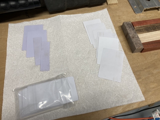

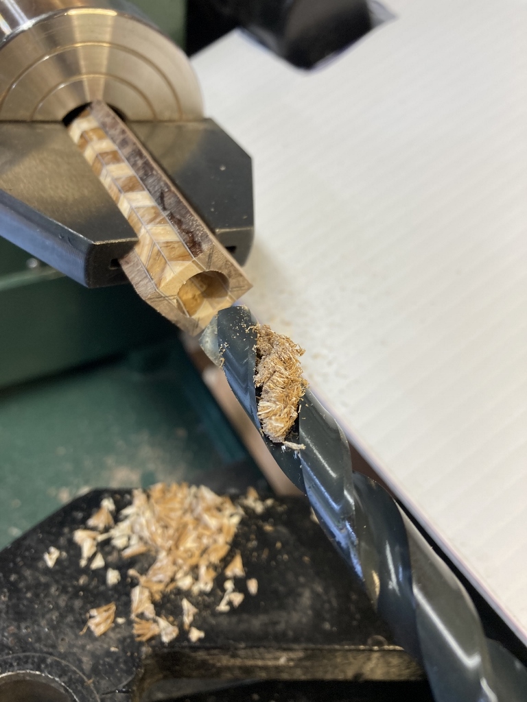

I bought the blank ID cards on Amazon and have had terrible results with them. The cards are made up of 6 ply of thin plastic, which want to separate from one another when drilling or turning. They're not well attached and I can peel them apart with my fingers easily before even cutting to size.
Anyone else have this problem? Or better yet...a solution? I have a stack of cards and white segmenting would be nice. Maybe I'll try pulling off 1 ply but that is a VERY thin segment.
The quality may vary from one mfg/seller/batch to another. The ones I ordered seem nice and uniform throughout. I've only used them on a couple pens so far, but had no trouble - and even with an xacto I can't separate them into layers.

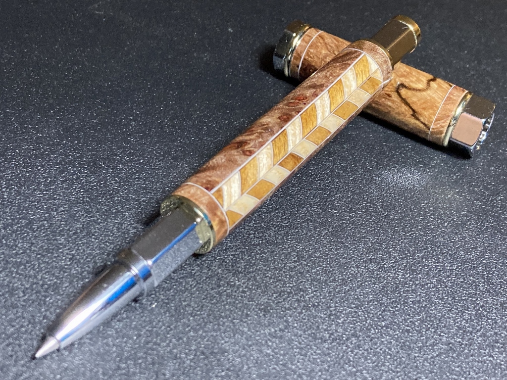

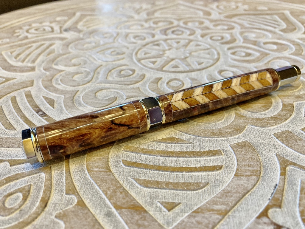

Update: I looked at the cards more carefully. They seem to have a veneer on each side and are solid in the middle. I ended up using the veneer which was very very thin to make some chevrons.

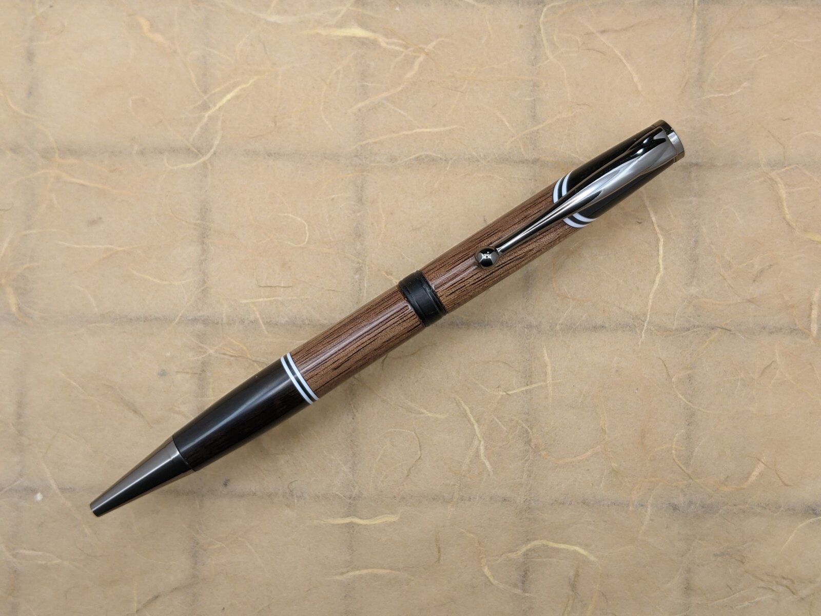

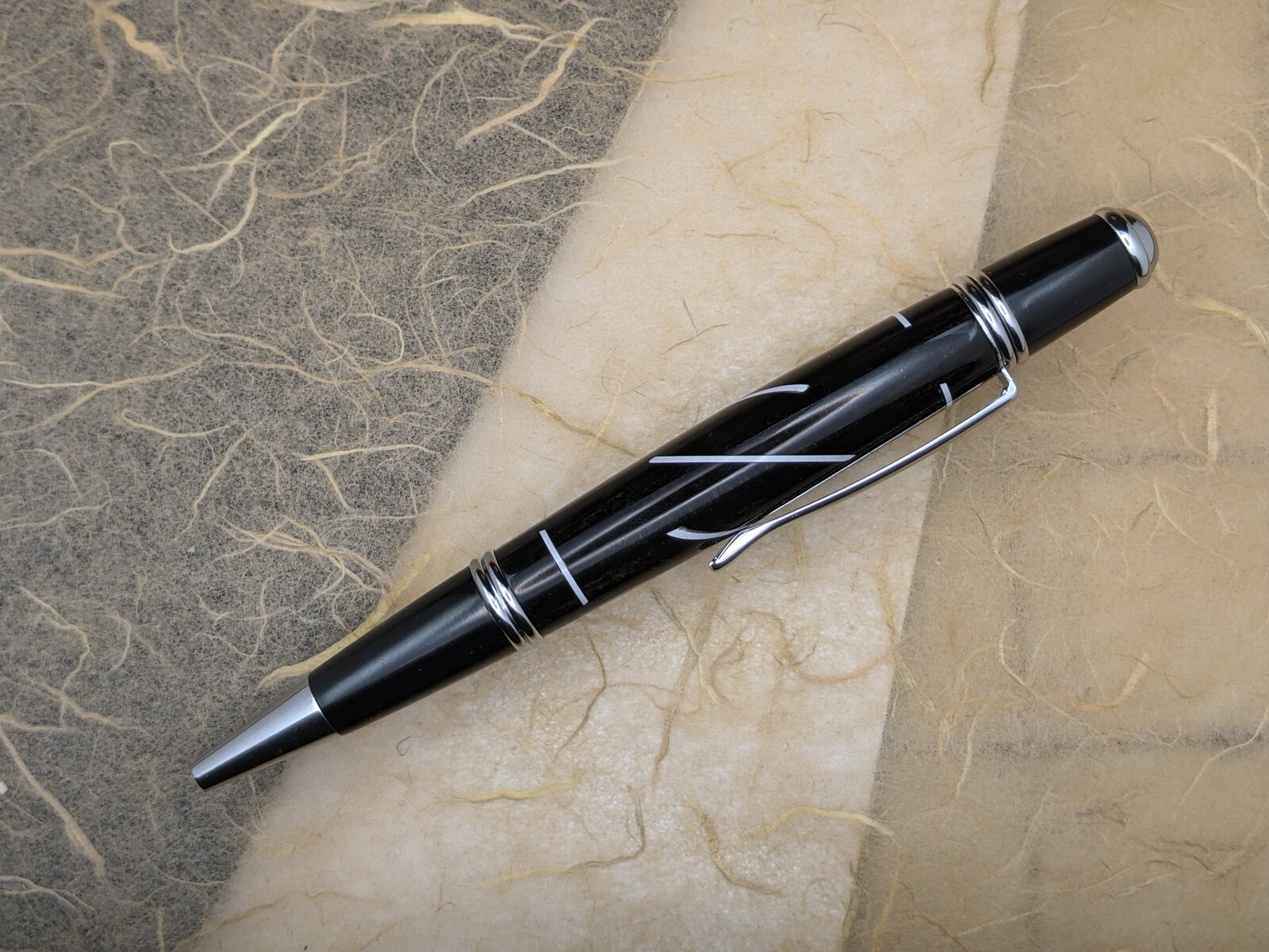

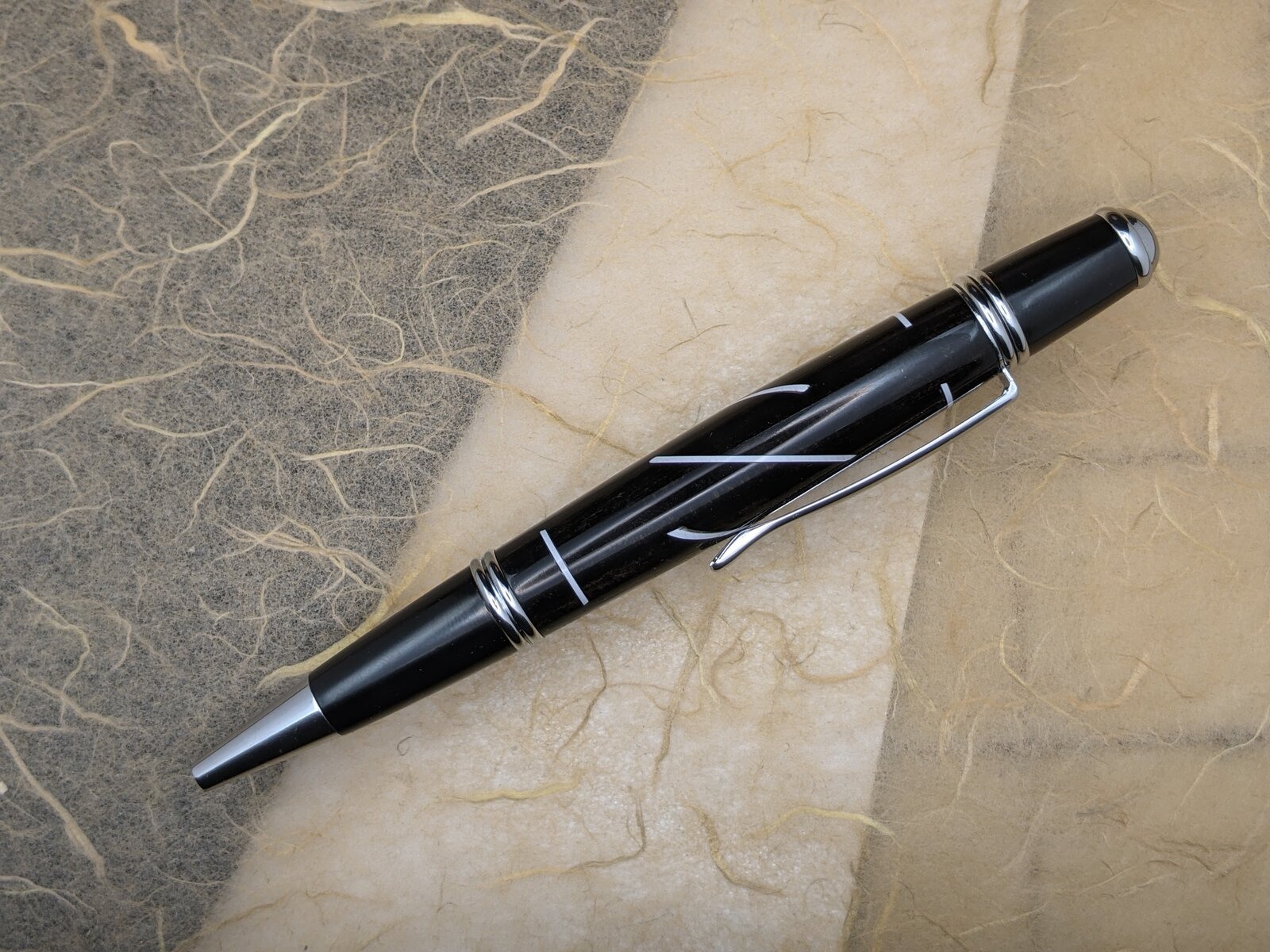

How about posting pictures of finished blanks with cards used in them. Thanks. Frank
(I'm a few days late - I've been tied up trying to shop for a new apartment & haven't had much time for pennish pursuits)

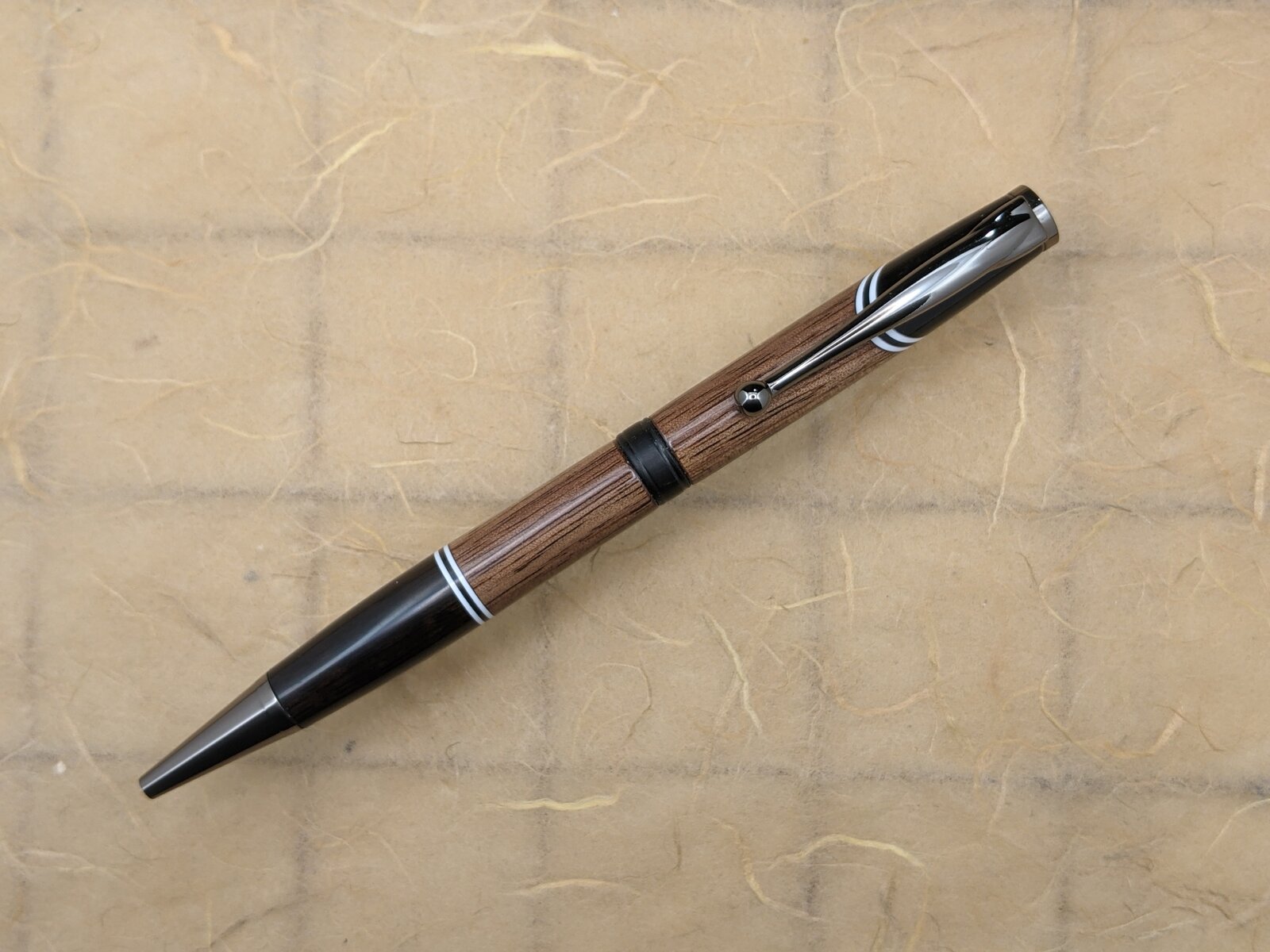

I don't have any shots of the blanks in progress, but these are a couple I made recentlyish - nothing nearly so nice as Todd's, though. The first is out of ebony (and cards), the second out of walnut and ebony, with something I think is dyed-black poplar veneer... and cards. Unlike Todd's, my cards seem to be solid straight through (I believe we're both using blank ID cards off Amazon, but probably from different sellers).
View attachment 318688View attachment 318689
Nice.... the top is quite interesting. I'm going to try ringwork like the bottom. Smart looking pen.
