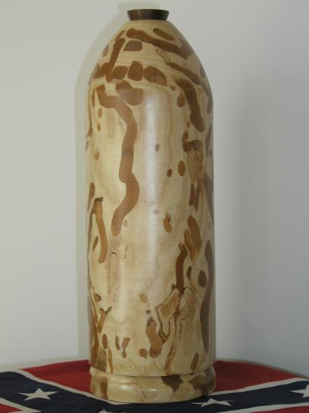

Here's what the results of an Emerald Ash Borrer going through
Ash looks like. I used lots of CA and textured wood shaving putty
to fill the holes/trails. I removed about 12 of the Borrers by ice pick when
their holes opened up, and 2 borred out while it was on the table
of the guy I gave it to. This is a full scale Confederate artillery shell
made in Ash from an original found by the superintendent of a cemetery
when digging for a burial here in Gettysburg, Pa. And yes, the wood
was moisture free when turned, and bugs still alive. The termite look
and trails should look - just smaller.

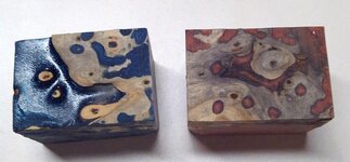

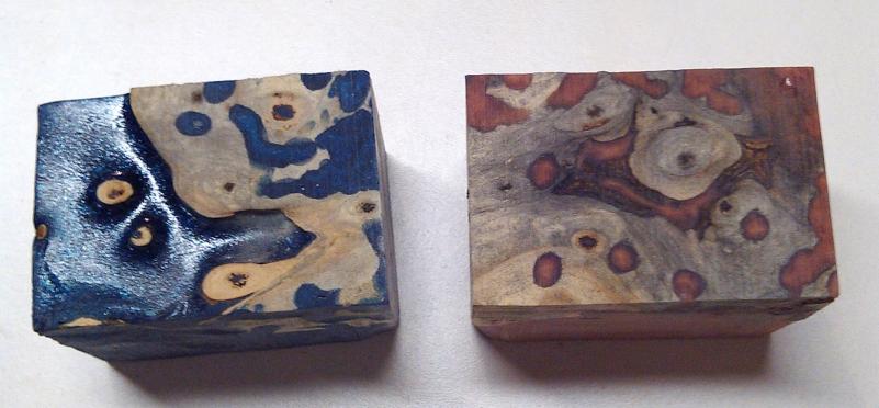

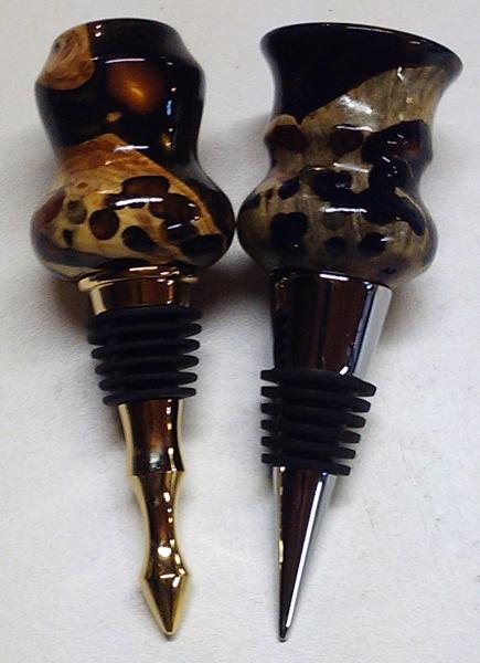

Whereas Im not quite as adventurous as you are in farming your own little critters to damage the wood, I do like to use bug damaged wood to make projects with. Heated PR flows nicely into all of the nooks and crannies. I use a turkey injector syringe to inject the PR into the holes one at a time to keep the bubbles to a minimum.:glasses-cool:
