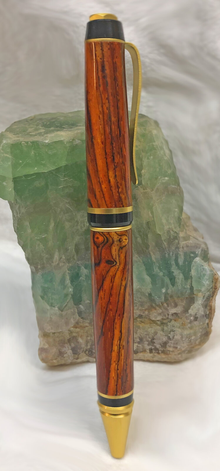

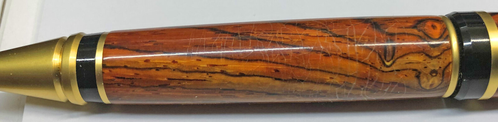

Hello All,
It hasn't happened to me very often at all; however, today I was looking at some recently completed pens and found that a "Plain Old Cigar and Cocobolo" that I made on February 18 now has a crazed appearance. According to my fingernail test the cracks are all the way to the surface of the finish. I suppose I will knock it apart, sand it down, and re-finish it. The only thing I can think of is that I may have started with CA a little sooner than usual after cleaning with Denatured Alcohol. Otherwise there was nothing different that stands out in the regimen that I use. Your thoughts?
Regards,
Dave
No Cracks as completed on Feb 18
With Cracks as I found it today March 7

A few things. I say this over and over and over and over again here but it falls on deaf ears. Pen turning is a marathon and not a sprint. Please take note. If you are going to do pens for sale stick with acrylics and mass produce them as fast as you can and even faster. Go for it. But if you are working with wood blanks and all these people who sell blanks here can not tell you their blank is dry enough to use for your purpose unless maybe if it were stabilized which is plastic injected in the pores. But if you order a blank and now it ships from place to place the humidity levels changed in transit. How was it stored and where. Yes these are factors.
Now the CA itself can be old which will lead to not good adhesion. I hate the accelerators with a passion. It makes the coating too brittle and the layer underneath now has no way to escape the gases. I am tired of saying to skip them because people continue to use them and some people have good success so you have been warned. If you are using them make sure they are compatible with the CA you are using. They are not all the same formula. Change CA and still use same accelerator can be a disaster. Now the blank itself is an oily blank and I am a fan of wiping with acetone and not DNA. Again my choice and had success. Do not use so many coats. 3 of thin and 4 to 5 of med is all that is needed. If all else fails then maybe need to switch top coat and either just polish or use a lacquer designed for woods. Time between coats to dry before next coat is applied. It can take 2 days for me to put CA and another to let it cure before I polish. Some woods are just not made to have a hard brittle finish because they move so much and if they are not dry enough then they move even more.
But again all this is time consuming so I work on at least 4 to 5 and sometimes more blanks at a time. Right now I have 10 blanks going. Good luck.

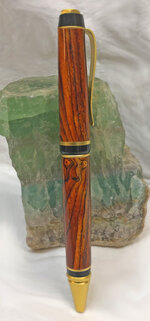

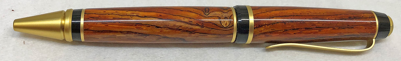

Well, Here it is re-finished and back to it's un-cracked appearance.
I'm anxious to check on it in a couple of weeks to see if the problem recurs.
Dave

Well, it's been just over a week and the pen looks as good as it did after it was re-finished. I also have been keeping an eye on the 2nd pen I made just after that - still looking good. - Dave
egnald
Jun 9, 2017
3,105
Columbus, Nebraska, USA
And another week has gone by with no re-appearance of cracks on either the re-finished one or on the 2nd one I made after that. Still looking good. I'm going to have to chalk this up to not letting all of the alcohol evaporate out well enough before starting to apply CA. - Dave
