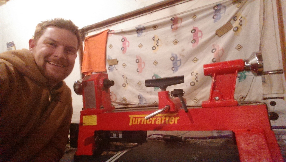

I'm pumped. I do not have the bed extension on currently but here's a picture to show my excitement of my new tool in the shop!
