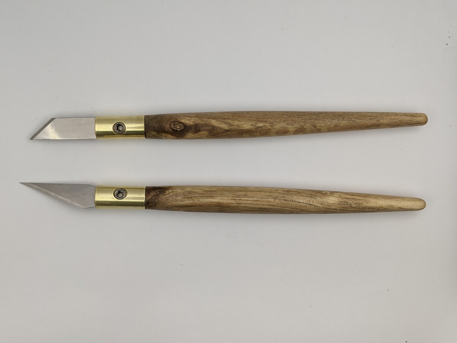

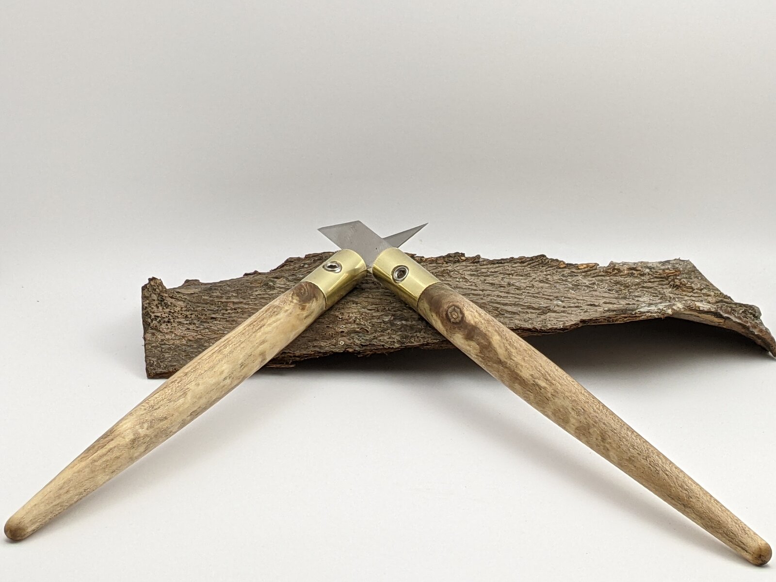

It feels wrong to post in "Other Things" before posting any actual pens, but I just finished these and the pens have been very patient about waiting for their turn on camera. Made from stabilized not-quite-but-almost-spalted-and-kinda-punky-and-interesting-looking (is there a term for that?) maple taken down in the yard a year or so back. Unfinished but polished to a nice shine, although it doesn't really show in the pictures... I'm still getting the hang of this "Phot O'Graphy" thing.
The first one (left/bottom) was over-turned a little at the hardware, so it's living on my workbench. The other was a gift for my father.

Those are beautiful. When I first looked at them I thought there were antler but the knot gave it away as wood.
Those would fit my hand so much better than the skinny ones that you get from the store.
I bet the unfinished wood feels quite nice in the hand also.

It really is some interesting looking wood - not something I'd usually associate with being very "maple"-looking at all... and yes, it feels fantastic. I'm usually a big fan of ultra-high-gloss CA finishes, but the warmth you get by leaving something like a stabilized wood (or a dense, oily hardwood like ebony, which is another that I'll often treat the same way) unfinished is really something else.
