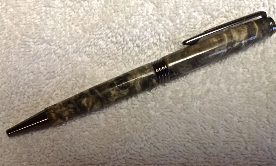

Here is a couple of first for me, 1st time I turn a pen without bushings, 1st time using Craft Coat, C&C more than welcomed. Pen wood is a burl, forgot which one and set in gun metal. I really like this Craft Coat. 4 coats, 5 minutes apart. Let cure for 2 hours, wet sanded lightly with MM, and polished up.

Great looking pen William. Who is the manufacturer and seller of Craft Coat? Looks like I better get me some of that! Beautiful finish.

I wiped it on while my lathe turned on its slowest setting. Waited 5 minutes, wiped another coat. ( 4 coats total ) after the last coat was applied, i left the lathe running slow with my overhead lamp on for a little warmth. Turned off the lathe but left the lamp on. Waited 2 hours. MM wet sand. Polished with acrylic polish.

Beautiful Blank, is the colour as shown in the photograph - Grey?
Terrific Fit and Spectacular Finish,

@Dan, I may experiment and do just 2 coats and I may experiment doing like 8 coats. Looking up close, its almost like a sheet of glass but doesn't have the CA feel.
@Mr. Brian....... I did this bare handed and did get quite abit on my fingers and hands, all washed off with warm water and soap and never felt the slightest tingle. I did not even experience the slightest of odor or fumes. Wood I believe was a buckeye burl. Hardware is gunmetal.
Looking at the original pic... Yea - might be Buckeye after all :confused:. The REALLY nice finish made it (to me) to look like an acrylic... I thunk I was wrong... I have used a lot of Buckeye... looks like this one! :cool:
