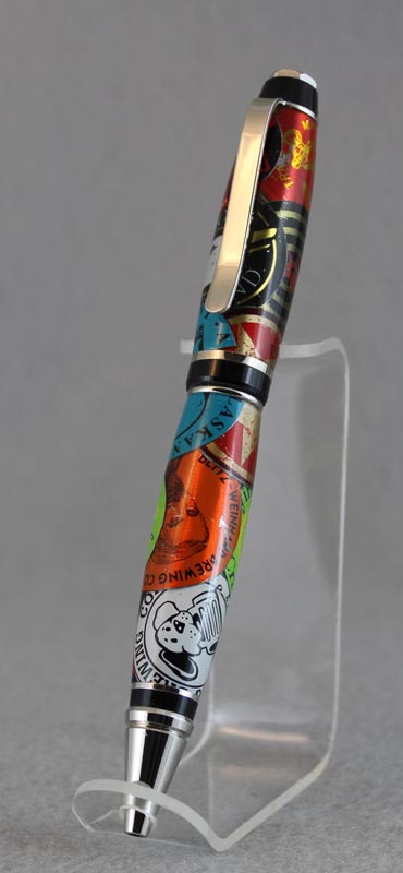

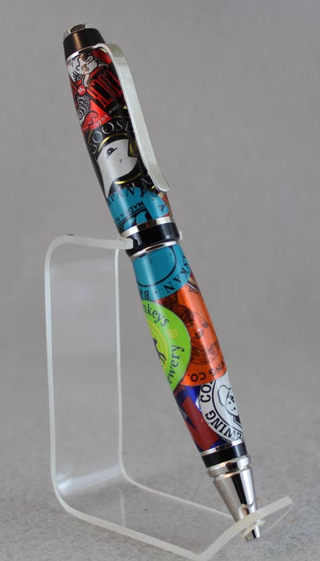

Haven't posted one of these in awhile.
These are national craft beer caps cast in Liquid Diamonds.
The kit is a Rhodium Cigar.
As always any suggestions and comments welcome,
Mike

Those blanks are beautiful! How do you make them? It looks as if you turned the blank right up to the caps. If that's the case how do you know how thick to pour the resin?
Thanks Brandy,
After I cut the crimping off the caps I scrape and sand the inner seal off. I then pick a transfer punch a few sizes smaller than the tube I'm using and wrap the caps around the punch and roll them on a piece of wood to shape them so they fit the tube tightly. A drop of CA under the caps will help keep them in place. I cast them in a resin saver mold and then turn.
I've made a lot of these and the best tip I can give is get the caps on the ends of the blank as tight to the tube a possible.
Hope this helps,
Mike
