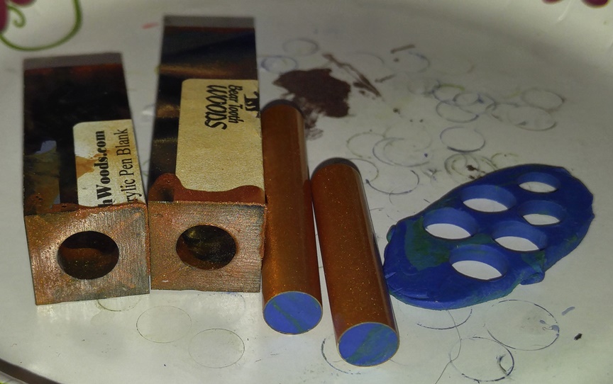

I plug my tubes with non-hardening clay from an art supply store to keep epoxy out of the tubes.
I got a pound of dental base wax on eBay (probably a "lifetime supply") for $12.00. It works great for plugging tubes. I tend to go heavy on the epoxy, so it's a necessity for me.

I used to use base wax, but the clay works better for me. The base wax used to get hard after a while.
