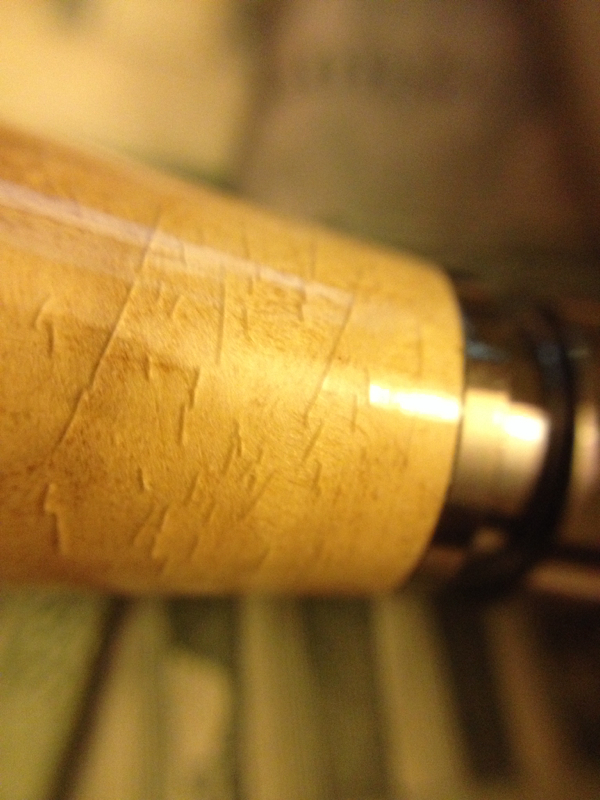

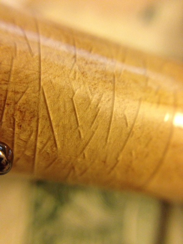

Crackes in the finish of all my buckeye
Linarestribe
Mar 9, 2011
393
Mount Vernon, WA
So I was looking over my stock yesterday and found that most my pens made with buckeye burl had crackes, crackle or something throughout the whole CA finish. The pens very in completion date from a year ago to two weeks ago so the wear made the different seasons here in the Northwest. Any ideas. Here's some pics.

CA finish , I assume and fairly thick . You don`t see this on other woods , made over the same time frame , finished in the same way ? To my eye , it looks like an environmental stress crack problem , but I have no idea what would induce it . What is your finishing procedure ?
Also, much burl wood is very light and porous when dry. For those I like to dry them to less than 7% and stabilize them, this stops stress cracking due to moisture changes.
Thanks for the tips. It only happened on the buckeye. Three different sources of buckeye. One was a buckeye/acrylic blank. Maybe it wasn't stabilized. My shop is just a shed so maybe buckeye is more susceptible to moisture up here in WA.
I finish by applying around ten coats with a paper towel, wet sand through the colored m/m and polish with Nova.

Went tonight to my helpful Woodcraft store owner and showed him my crackled/cloudy CA coated bottle stopper. He immediately asked if I used accelerator and how long between coats. I told him yes and about a minute or two. His personal experiences, when he's had this happen, have been too much accelerator used and need to wait about 5 min. between coats for proper curing. So, going to slow down my finishing and enjoy the process. He also showed me some pieces he did with Wood Turners Finish. They polished up great and looked super!!! I bought some WTF... :)
I went to my helpful Woodcraft store owners and showed them the crazed/cracked/cloudy CA finished bottle stopper I had. They said too much accelerator and not allowing enough time between coats will do that. They had had the same thing happen to them. So, I'll start enjoying my finishing process and wait longer between coats (they suggested about 5 minutes) and then not do the final polishing until the next day. I also bought a bottle of the Wood Turners Finish. They showed me some blanks they had done with it and they really looked great!! Will be using that to see how I do with it. It sounds pretty easy..and no fumes or glued fingers!! :)
My local woodworking store owner opined that the CA finish was put on too thick. It was better, he said, to use thinner coats before applying the accelerator. The accelerator was curing the top layer of CA, but not the stuff immediately under the cured CA.
Thinner coats was his answer.
I had a conversation with the Mfg. seems that this is caused by the CA(thicker) Setting unevenly, and Old material. I was warned that a year + was too old.
seems that the surface sets at one rate, and the center of the coat sets later. They replaced the CA for me. I have a dummy sitting on desk for 2 weeks to be sure.
I had followed the instructions as shown, thin coats, accelerator etc. up to 7 coats.
