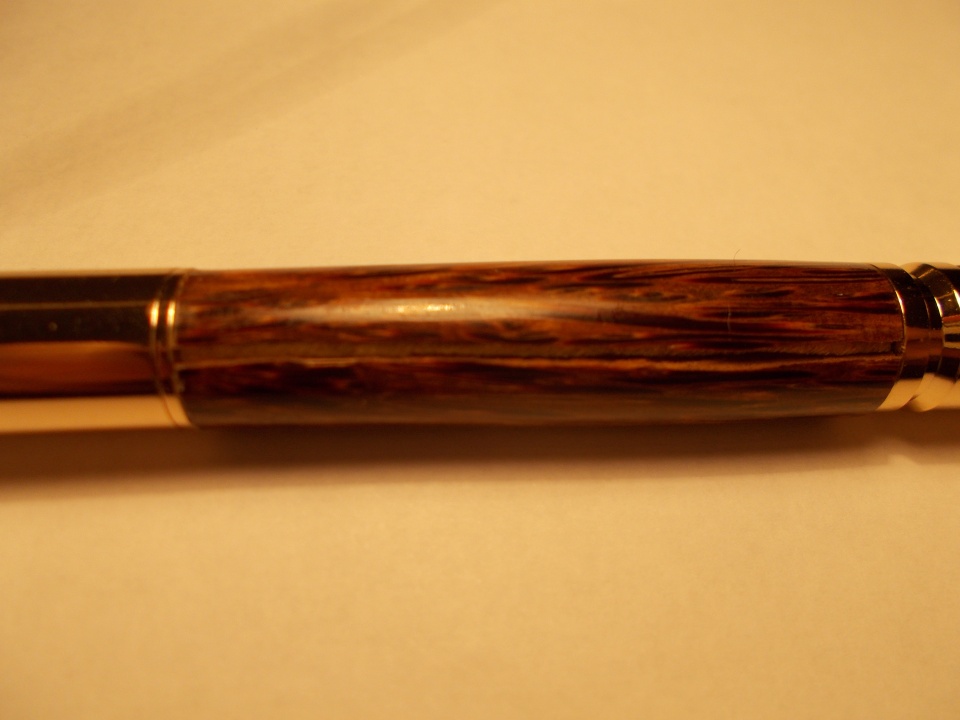

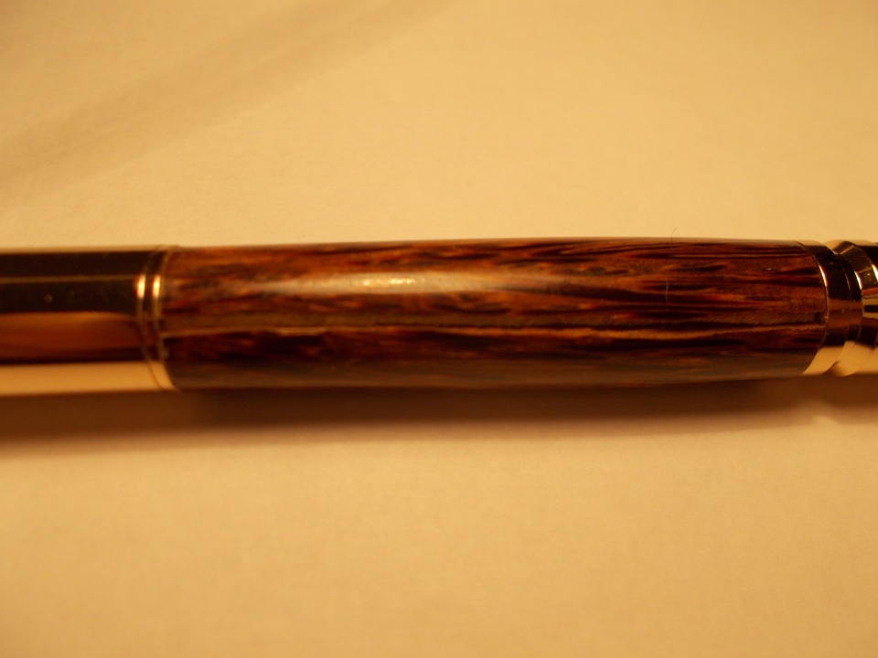

My understanding is that palm is pretty stable. It isn't actually wood and doesn't have growth rings, so it swells and shrinks evenly. If all four blanks were from the same supplier, then it's possible that they were not yet dry. Typically suppliers will warn customers if the wood is still wet, but pen blank sizes should dry within a few weeks, so I'd say it's not a common problem (with purchased woods). Are the cracks all the way down to the tube? A pic of the failure might be helpful.

this was mentioned above and I am betting difference in humidity in the house and the shop. Carefully examine the wood cutoffs - are there any fine cracks in it? If so could be enhanced by heat from drilling and humidity/temp changes between the house and the shop
:redface:
Cracked Pen blank is attached
That is a humidity/heat crack. You said earlier that they were in a box. Were they in a room with a window and placed near the window so that sunlight might shine on them. Usually that type/size of crack pops up when a pen is placed near direct sunlight and short periods of quick higher temps are reached - such as in a hot car or in a glass case in which sunlight is able to hit on it for an hour or so.
It does not have to be that situation as other situations can cause it. I did not read that you took it into your house, (I missed that). Changing the environments for furniture that is made in unheated and non-environmentally controlled shops causes home made furniture to crack also. I would say - that is exactly what happened to your pens.
I lived near the coast in Japan for 25+ years and humidity played a big role in the way I did my woodworking and later my pen turning. I experienced the humidity cracking in wood in my earlier years - from wood that had been air dried for 10 years or so. My shops in my earlier years were not heated or cooled and humidity/temp changes was something I learned to adjust to and avoid when possible. As to pen blanks, I mentioned previously that I would microwave some blanks slowly or put them in humidity stable environments for a few days before using them. Sugar Land - Coastal area, that will affect some blanks and the thinner they get, as in a turned pen, the more likely that will happen.
One more bit of information: Consider this a big plus. If you start selling or just making and giving away pens, You learned early on what happens, and it happened before you sold them or gave them away. Better to happen at home than having your reputation tarnished. :redface: I have been there and done that.

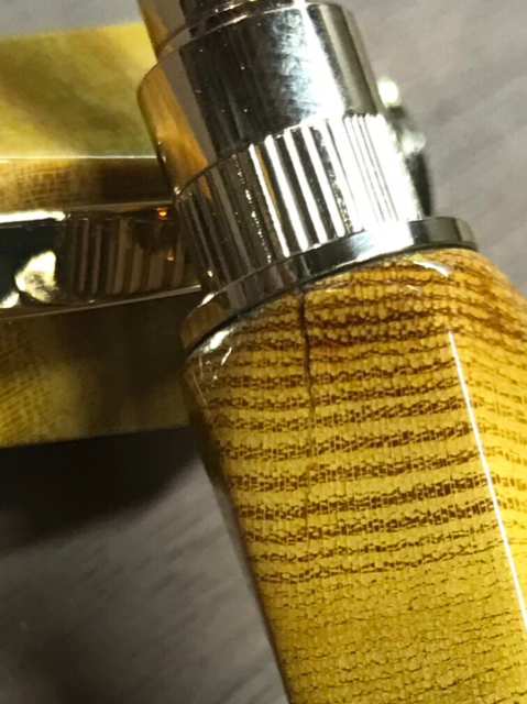

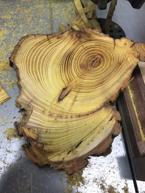

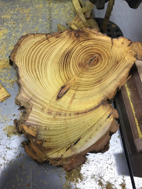

I too am dealing with cracking, but with some Osage orange I cut last spring. I'm experiencing cracking as I press the ends of this magnetic graduate kit. I've made this body of the pen three times. After the first one cracked, I microwaved the blank a couple of times, thinking it was still too green. The third one I slightly over sized the ends and tried to make sure all the epoxy was more in the middle.
Here is what I started with.
Here is the crack.
Each time I ensure there is no epoxy in the tube, I thought oversizing the blank on each end would give some room for tube expansion. Maybe I'm fighting the tight cross grain. I applied a nice CA finish, is that causing it to crack? This time it was just one end.
I plan to press it apart and try one more time, any suggestions?
Depending on your source, some blanks you get may be sealed with wax. If they are then most likely they are not completely dry.
Also, if you glued in the tubes immediately after drilling you may not have given the wood sufficient time to cool and move after drilling. With some woods after drilling and cooling you will notice the tube is a very tight fit and you need to drill the hole again. That is from the wood contracting and moving.

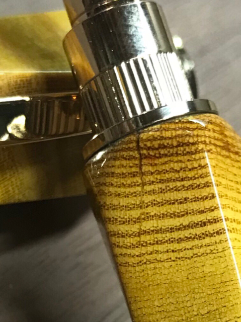

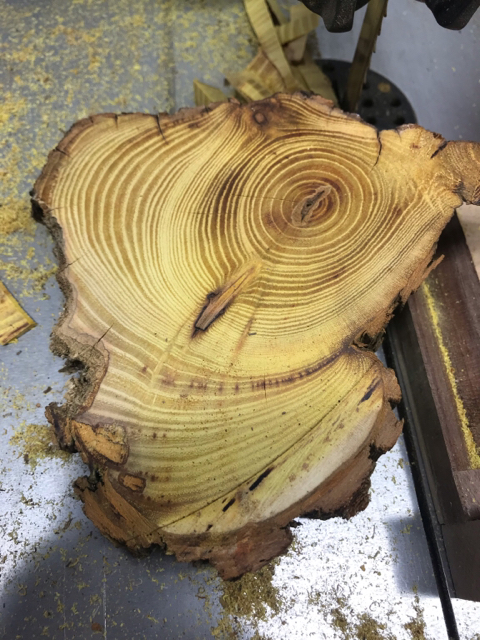

Here is the crack.
Perhaps after disassembling it. You can get some CA to flow into the crack and clamp it until its closed then let cure overnight.
Next I would unclamp the body and take a needle pile to the inside of the brass tube until you can work it down until you're hardware slips in withought resistance. Then glue your hardware in using CA or a thin epoxy.
Place whatever type of adhesive on the inside of the brass tube. Not on the hardware end or the excess glue will squeeze out and make a mess. Very little adhesive is needed. Apply a small amount with a tooth pick. I prefer a 5 min epoxy which is a little more time forgiving.
I usually use this technique when working with a very thin pen body end or brittle material such stabilizes buckeye.
