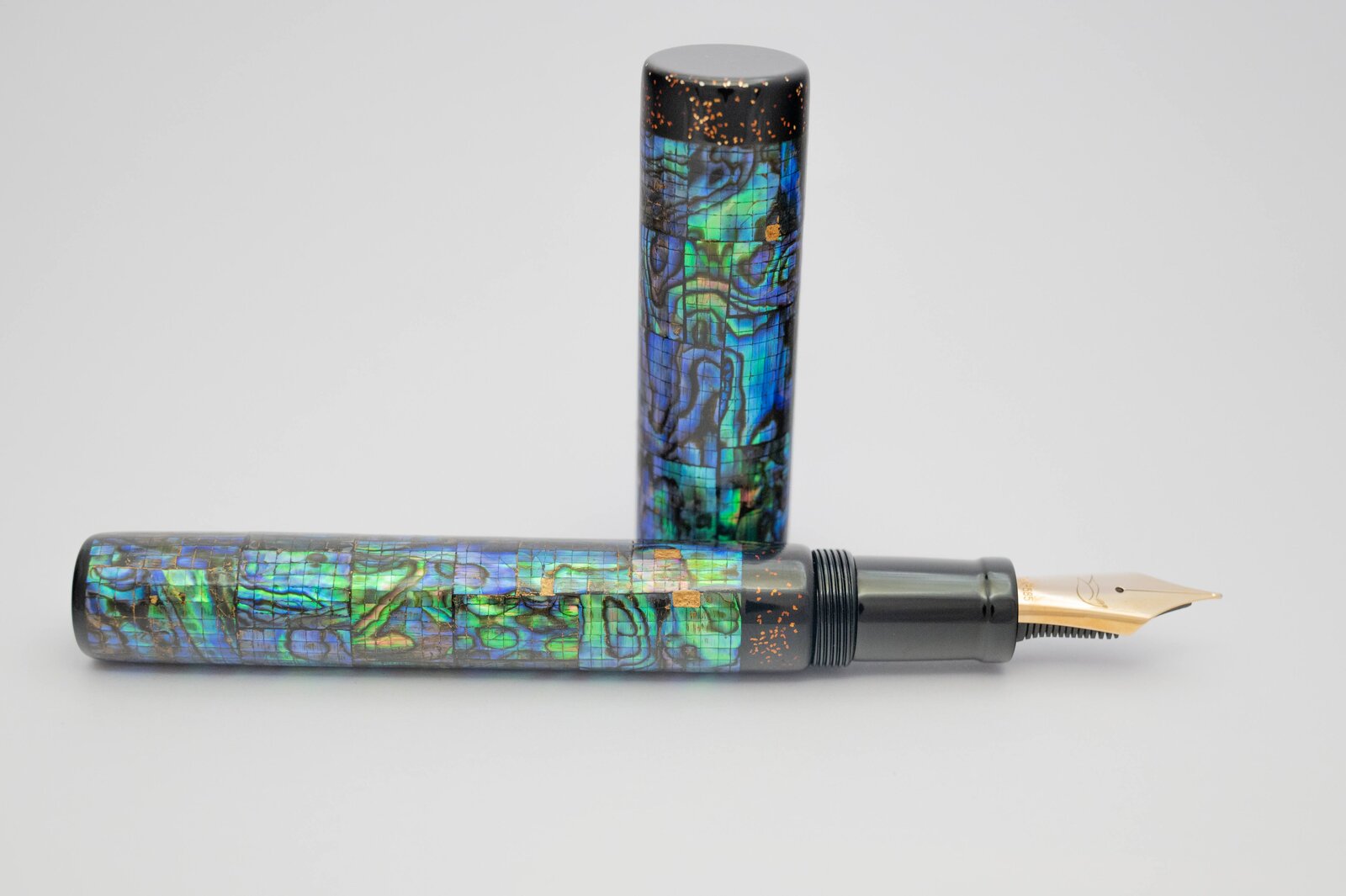

Hello All,
So, finally I finished another puzzle.
Commissioned cracked Raden that took an eternity but, I enjoyed every minute of it.
Enjoy the pics.
Teo

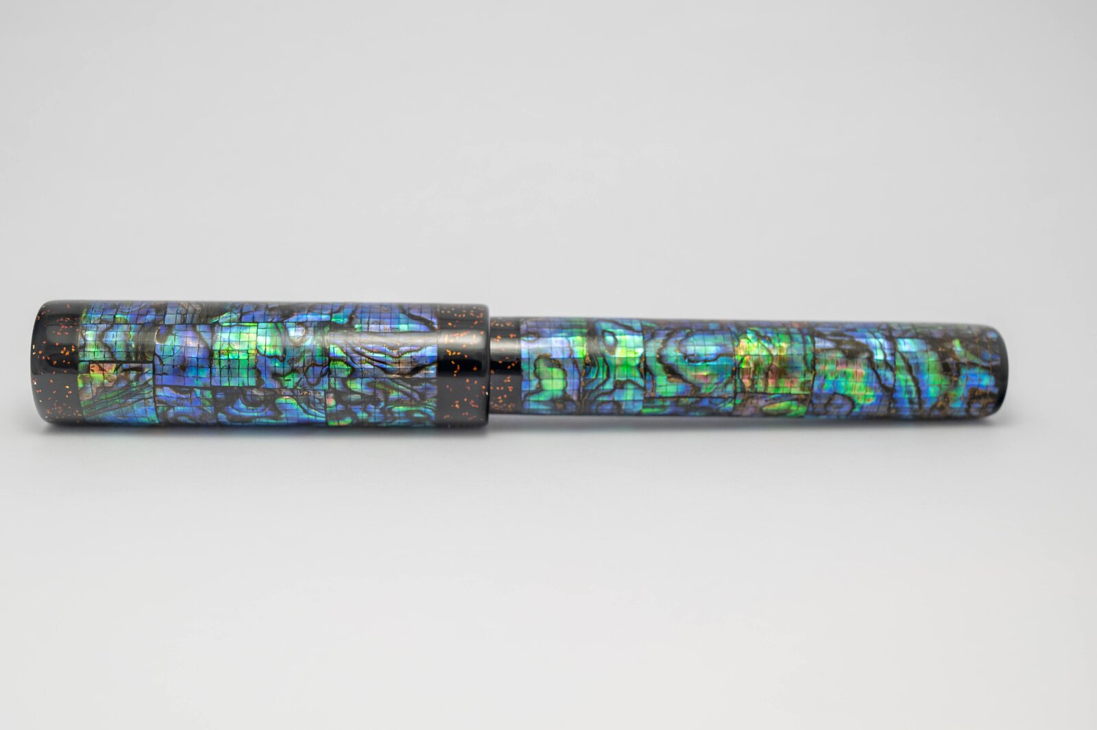

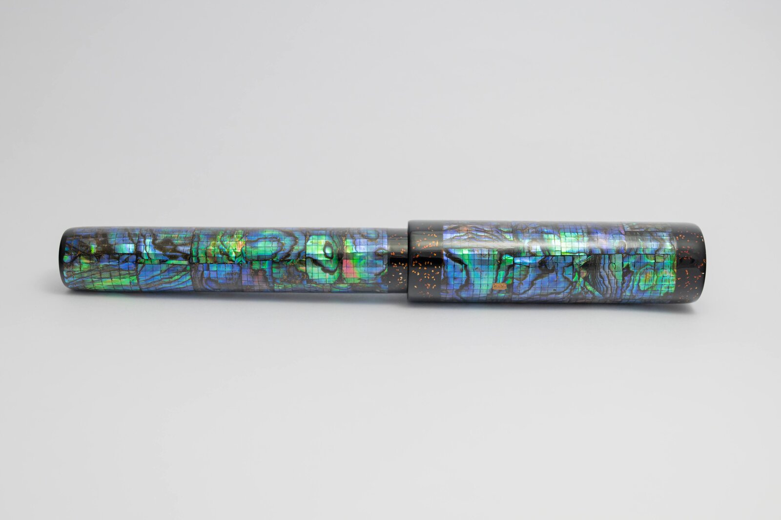

Thank You!
That's urushi work. The shell is from New Zealand, cut and glued with a special urushi mix. The flakes are silver and cover with nashiji, urushi used to fix metal powder or flakes. The gaps between shells are filed with black urushi and some areas have golden powder added. All the surface is polished and covered with final layers of high quality urushi for protection and shine. Threads also are covered with Urushi. That's more than 6 months of work on this pen.
Just finished to glue the abalone on another pen, a lot more of work left.
It's very difficult to take pictures of Urushi, the light bounce everywhere, used light bouncers and diffusers.
