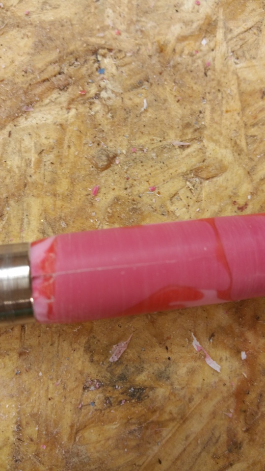

can anyone tell me how to repair an acrylic pen blank,,or if it is even possible,,thank you,,i know this picture isn't too good,,but if anyone can help I would really appreciate it,,,,

Ooh, if it's cracked below the bushings, that's not so good. You can try building it up with some med/thick CA. At that point, I might consider saving it for a smaller pen I hate when that happens!

Cut the end square and and clean with a parting tool. True on a squared up drilled piece of a blank to create a band. Square up the exposed end and return.
I tend to try to make the band look planned and often install a mat thing one on the other end
On the end of a barrel like that? no, not a good situation .....
You could try to repair the gappage by using thin CA, followed by some thicker CA to fill it in, but then you'ld have a clear "window" right next to the next part, and you can see down into the pen. Adding a very small amount of the right kind of dye or ink could make it much less visible, but adding acrylic or other kinds of ink to CA may affect it's curing time.
Alternatively, you could fill it with clear CA and put the problematic area up underneath the clip, if it's feasible.
Lastly, with Ken's idea .... I think he meant to say that he tries to make the band look planned, rather than like a "band-aid" ... by putting a matching band on the other end of the same blank.
actually I was talking about the white line that runs the length of the pen,,
Oh, I don't think there's any coming back from that if it's visible. You can try opening it up and hitting the crack with some CA but I think it will show. You might be able to hide it under the clip and at least it it will be structually sound.
Back in the day when I did lots of pen turning I sometimes would take blanks that weren't cracked and use a Dremel tool and make a "Valley" in the blank when I was almost turned to finish and fill that "valley" with, crushed turquoise,coffee grounds,coral and assorted other colored powders, I usually made the line squiggle no straight, I think you night be able to do the same with that line that looks about an inch long. Turn it almost to size and then see if you can open it up to fill it also see if the hairline crack goes all the way through, it might surprise you and disappear. Good luck.
That white line ? .... If you apply a drop of very thin CA you might find that it "wicks" its way in and makes the line invisible ... worth a try IMHO.
My suggestion is chuck and do not waste your time. You do have a chip out down by the bushing. Unless you want to cut it completely off and make a blank that is segmented then there are possible choices. You can call the vendor to see if a replacement is possible or just save for future oops bands. A straight line crack like that is not usual. Just looking at that photo tells me you need work on tool sharpening or selection. That is jagged from what I see. You are taking too much off the ends at one time. That should be a gradual thing. Take some off the ends then work toward the center. Do this on both ends.
If you have a lot of time you can experiment. I really like OKLAHOMAN's tip above. Very neat.
But the reality is, I don't think that long crack on that material will ever "disappear" unless you cover it up. Filling it will probably be evident.
I've found that hairline cracks on acrylic materials are almost impossible to make go away. Wood is a lot more forgiving.
That's just part of the game though... turn and learn.
I'm with Oklahoman on this one. Of all the pens I've made (only about 50) the ones I like most started out just like this one. They forced my to get creative and it always worked out.
Design opportunity! I'd part it off, clean up the tube, cut and drill a contrasting piece and glue it back on. I've had to do that to a few pens, and was quite pleased with how they came out. Those pens were with wood, not acrylic so your mileage may vary.
Off the top of my head and far from being an expert it looks like there is still a lot of turning to be done on that blank and I don't think I'd give up on it. Try taking some of the blank shavings mix them with CA and stuff them into the crack near the end (I can't tell for sure it that is really cracked there or not. The hairline might disappear as you go you might approach it with sanding for a bit and see what's happening.

Back to the subject at hand - try some thin CA glue to fill the crack while you try and close the crack. Let it set up for a while, so it's fully cured, and turn it again. It might not be perfect, but you'll find out only after you turn it.
It can't hurt - right now, it's an unfinished blank with a crack...try and see if you can turn it into something better...if not, it was still good practice!
(and your tools are too dull - hence the chipping)
While it bothers me to do this (sarcastically written) - I have to agree with edstreet on this one. It is not an expensive blank. I could probably turn a new one in less time than it takes to try to fix this one. And, if I fix this one, I would likely not sell it because of the crack. I could give it away, but I don't like to give away pens with flaws. I could probably do an "oops band", but again, that would probably take longer than turning a new blank.
The other options are good ones, but not ones I would do with this blank . . .
If I had to fix this one, I would try to drizzle some thin ca on the crack then turn/sand it back down to size. Hopefully you could then cover the crack with the clip.

Sometimes it easier to learn why the blank may have cracked and start over with a new blank. That blank may be his first cracked blank, but I think we can all say, it won't be the last cracked blank.... Especially if one doesn't understand why the blank cracked.
I would probably try to fix it, mostly to learn more about turning techniques in that situation. You are out nothing if you have another failure with it, but you might improve your techiniques. I guess I just enjoy the challenge of proving to myself I can find a way of fixing things, and sometimes I succeed and sometimes I don't. But I learn either way

Based on the price of that blank I second what Ed said, throw it away and start over. Unless of course you like the option of having wood accents on the ends then you could always go that route which I think someone else has already mentioned

It does not have to be wood bands. It could be acrylic or metal. The crack down the middle can be replaced with a accent stripe of any material. How much effort that the OP wants to put into it can determine what to do with it. If you are going to completely chuck it then try turning the blank off the tube and salvage the tube. This will also give you a feel for this process in the future where the blank is much more valuable. A learning experience can evolve out of a mistake or a poor quality blank.
If you are at a point where you can make that the clip end of pen you might be able to pull this off. This sometimes works for me:
1. Use a little fresh piece of 320 sandpaper (you don't want any contamination from any other colors) and sand it enough to collect some "dust". Save this dust in a little plastic parts bag for later.
2. Use a little medium CA to fill the crack - you just want to fill the top part of the crack in order to turn it down closer to final size, not all the way to the tube at this point. Repeat as you go if you need to.
3. Turn from the center of the blank to the ends - at this point if you try to turn from the ends toward the center you'll probably totally blow it out since you'll be catching in the chip-outs. VERY light cuts with a SHARP skew should work - sometimes you can use a skew as a scraper but again - VERY light cuts. A gouge stands a good chance of catching in the crack or the chipped out area and blowing it out - at least that has been my experience.
4. Now, when you're down to just barely over the final size if you can still see the crack, rub the sanding dust into the crack and fill it with thin CA, let it sit for about 15-30 minutes to cure enough you can work it, and then carefully turn or sand it down to final size. If you can still feel the crack you can repeat this step.
Depending on your results at this point you can either just move on to sanding through the grits and finish with your polish -OR- you might need to do a CA finish if you think you can still feel the crack.
If all has gone well and you are lucky you should be able to put this under the clip and it will never be noticed.
BUT - sometimes it doesn't work and you just have to chalk it up as a learning experience.
