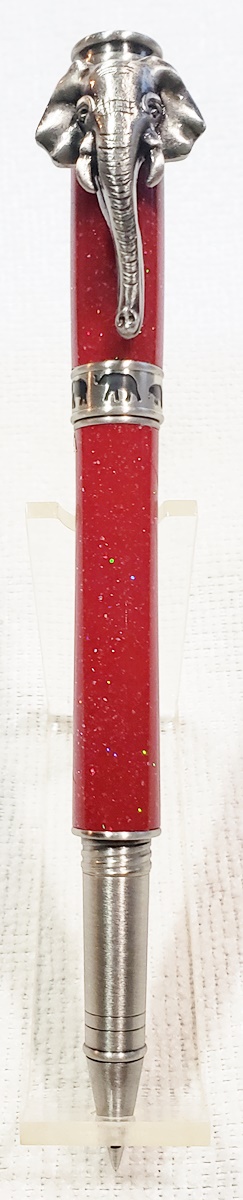

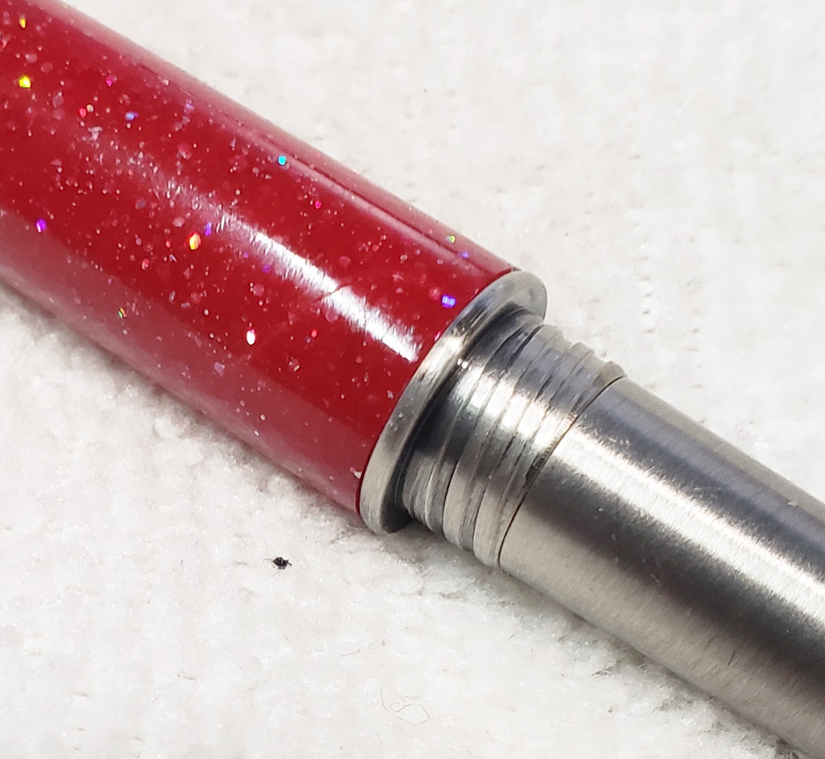

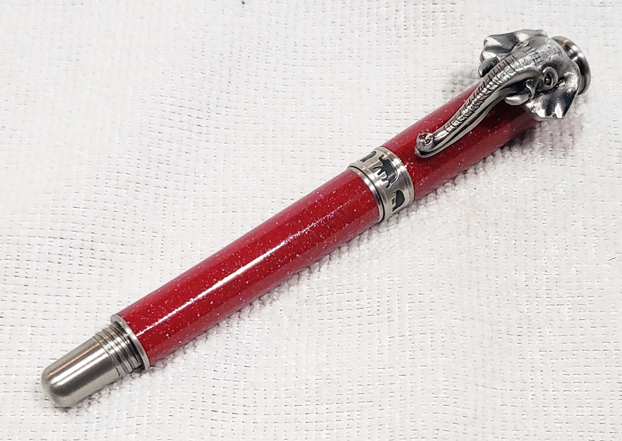

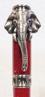

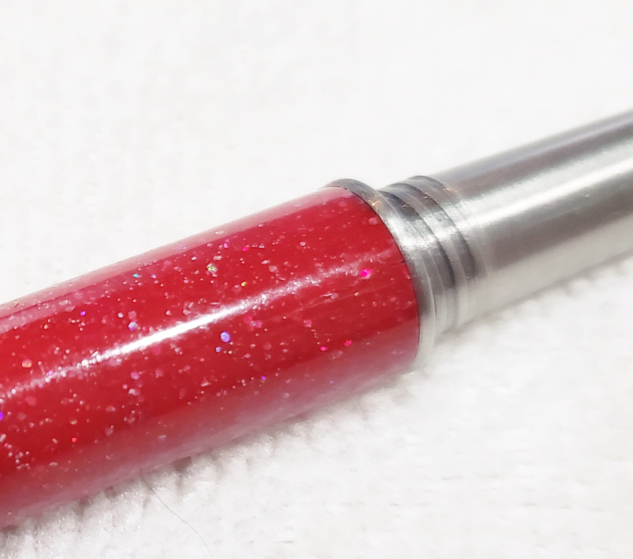

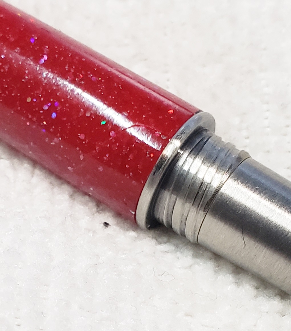

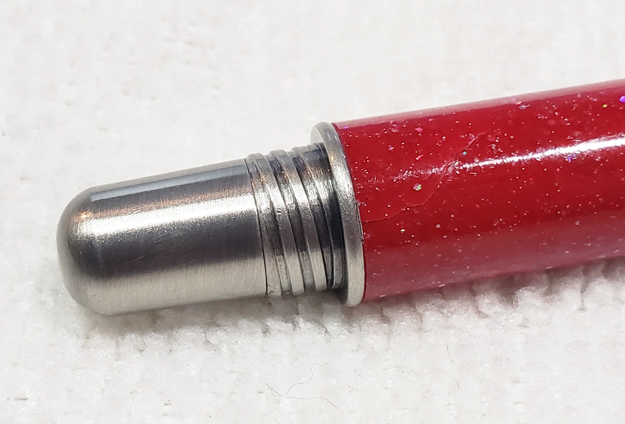

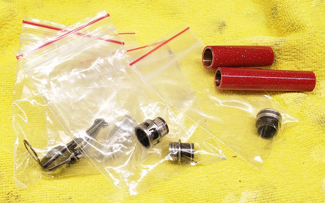

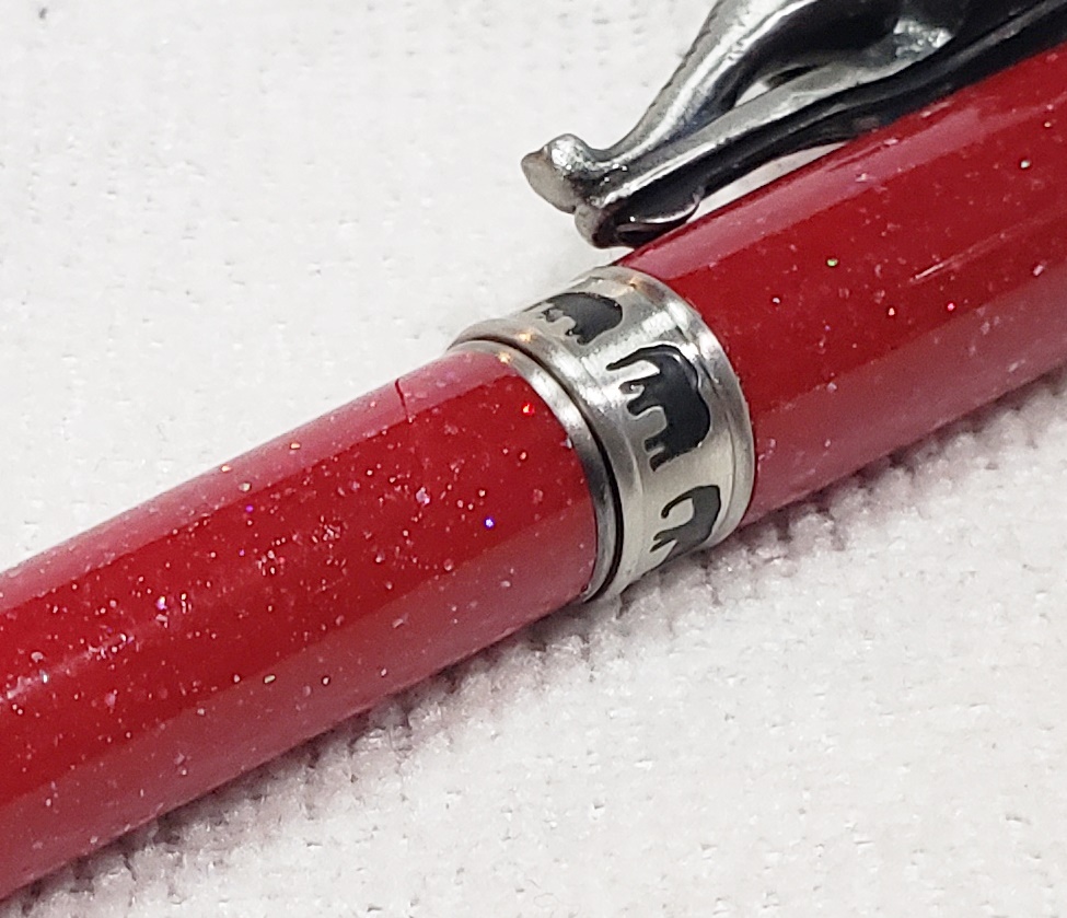

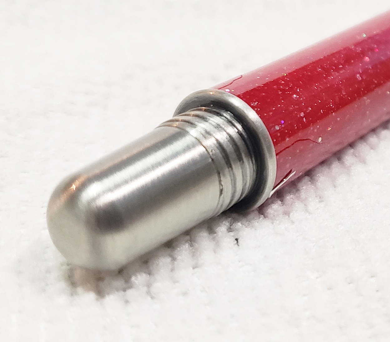

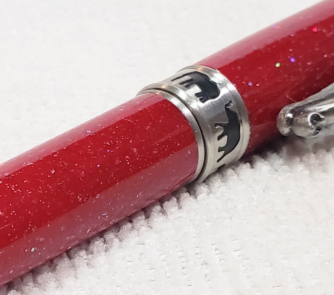

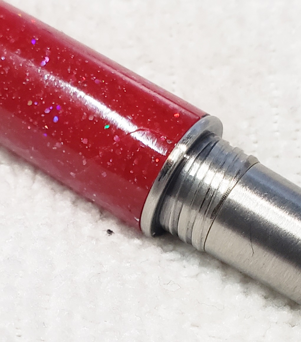

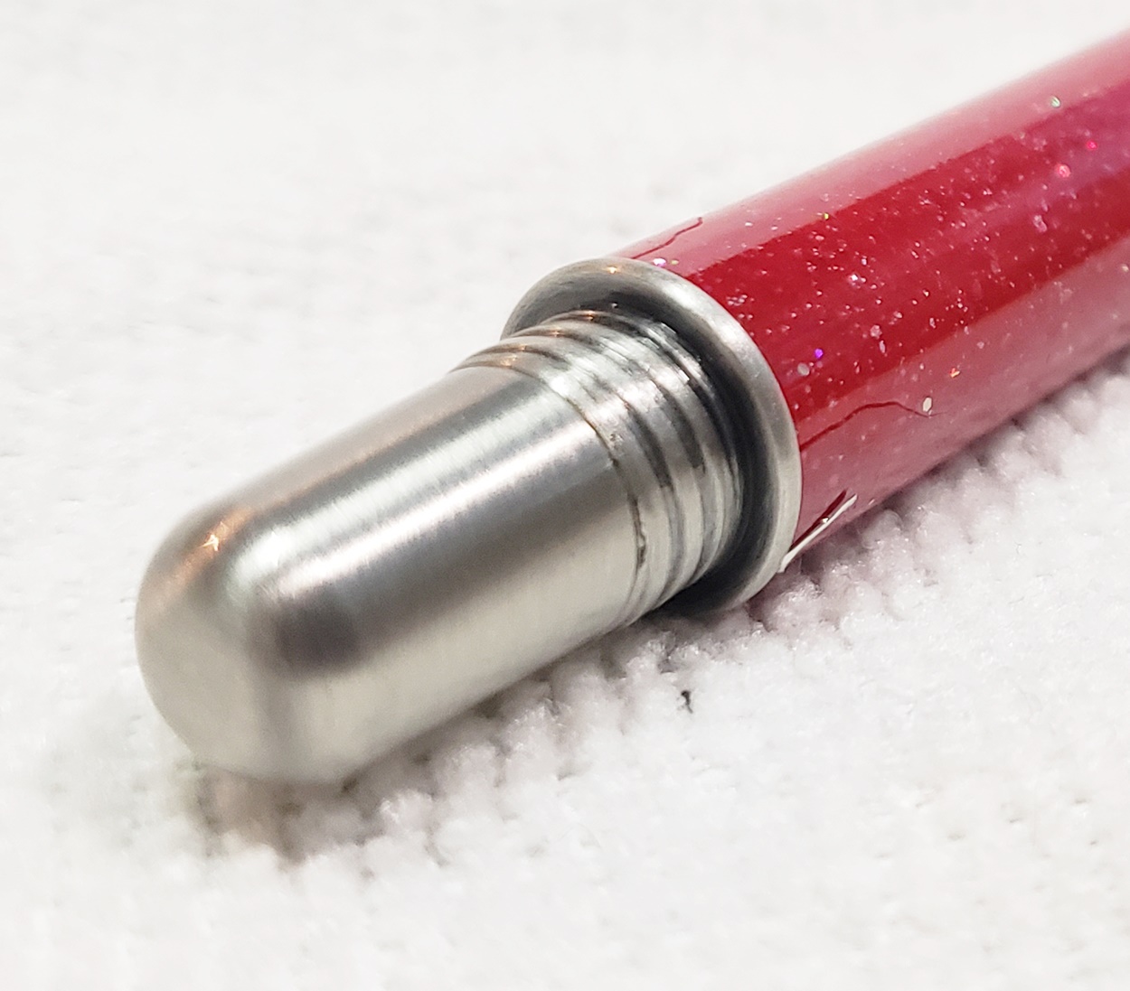

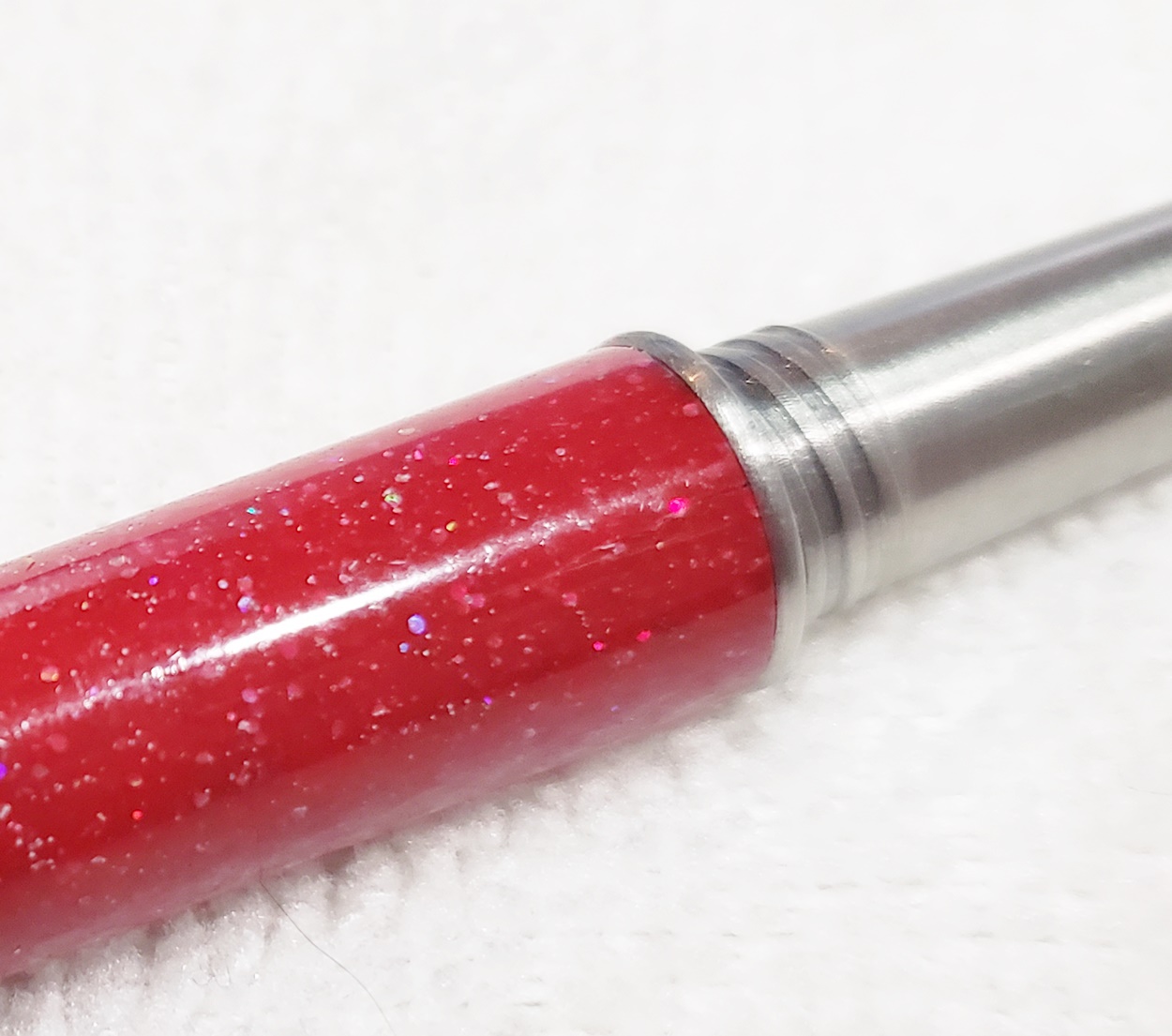

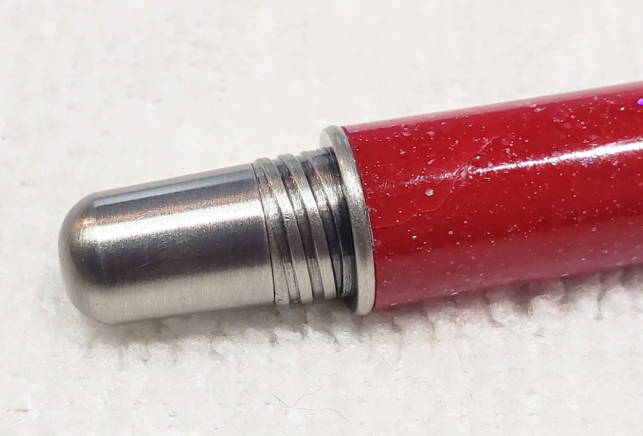

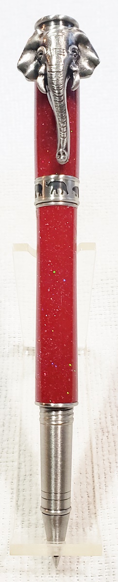

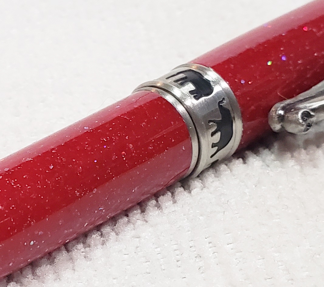

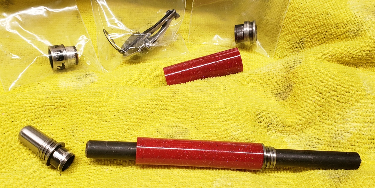

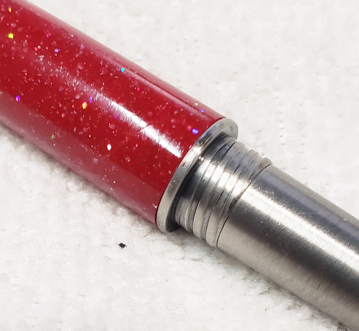

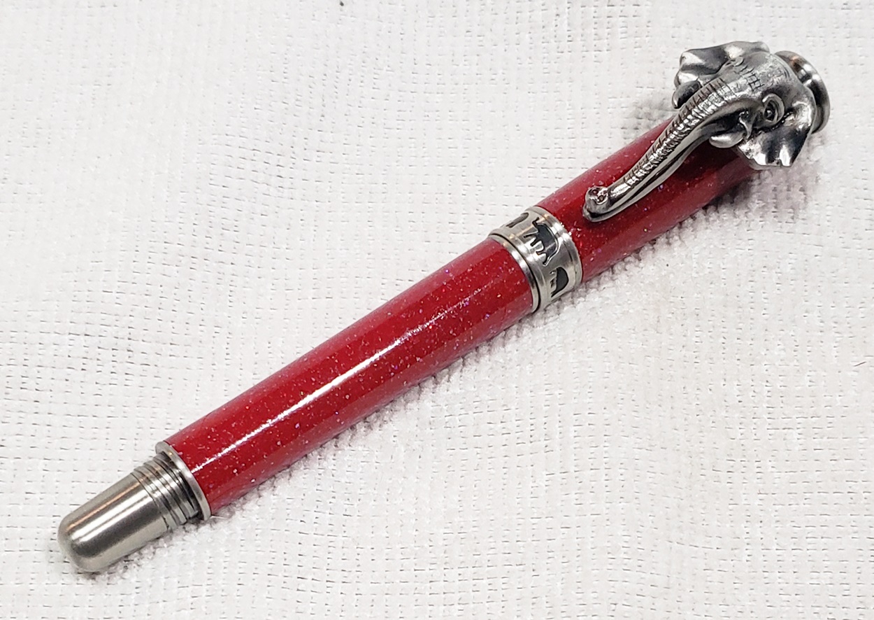

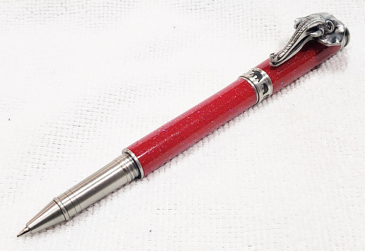

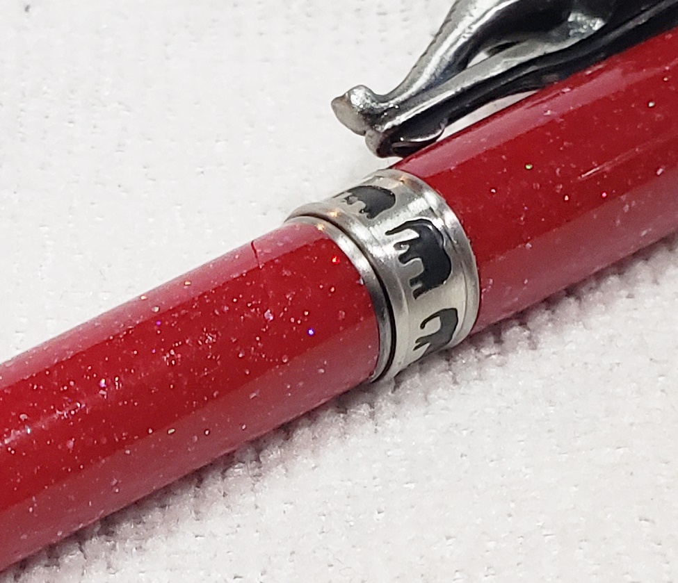

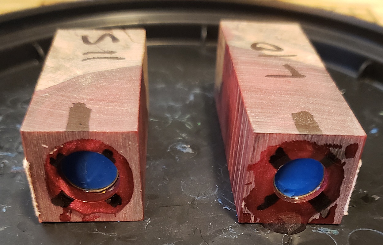

This was going to be for my sister. The blank is inlace acrylester, so I assume it's brittle. Hopefully I can disassemble it.
Oh ... YEAH ... one of those cracks ... while pressing the parts together, I assume ! . Inlace Acrylester did you say ?
1 out of 15 or so, I will experience that with Acrylester. I am better at assembling more slowly ; I also started applying several coats of CA to it. And make sure my shop is above 65.
It happens. Pretty pen.
My garage was in the low 50's, so that could have had something to do with it.
Maybe. For me I think it was the material being too thin and assembling too quickly. I did have them make me a custom color (turquoise) and all cracked (I think it was their mixture). My shop never gets below 58. I will also heat it until 68 before turning anything. I have no idea if that helps. I just don't like the cold.

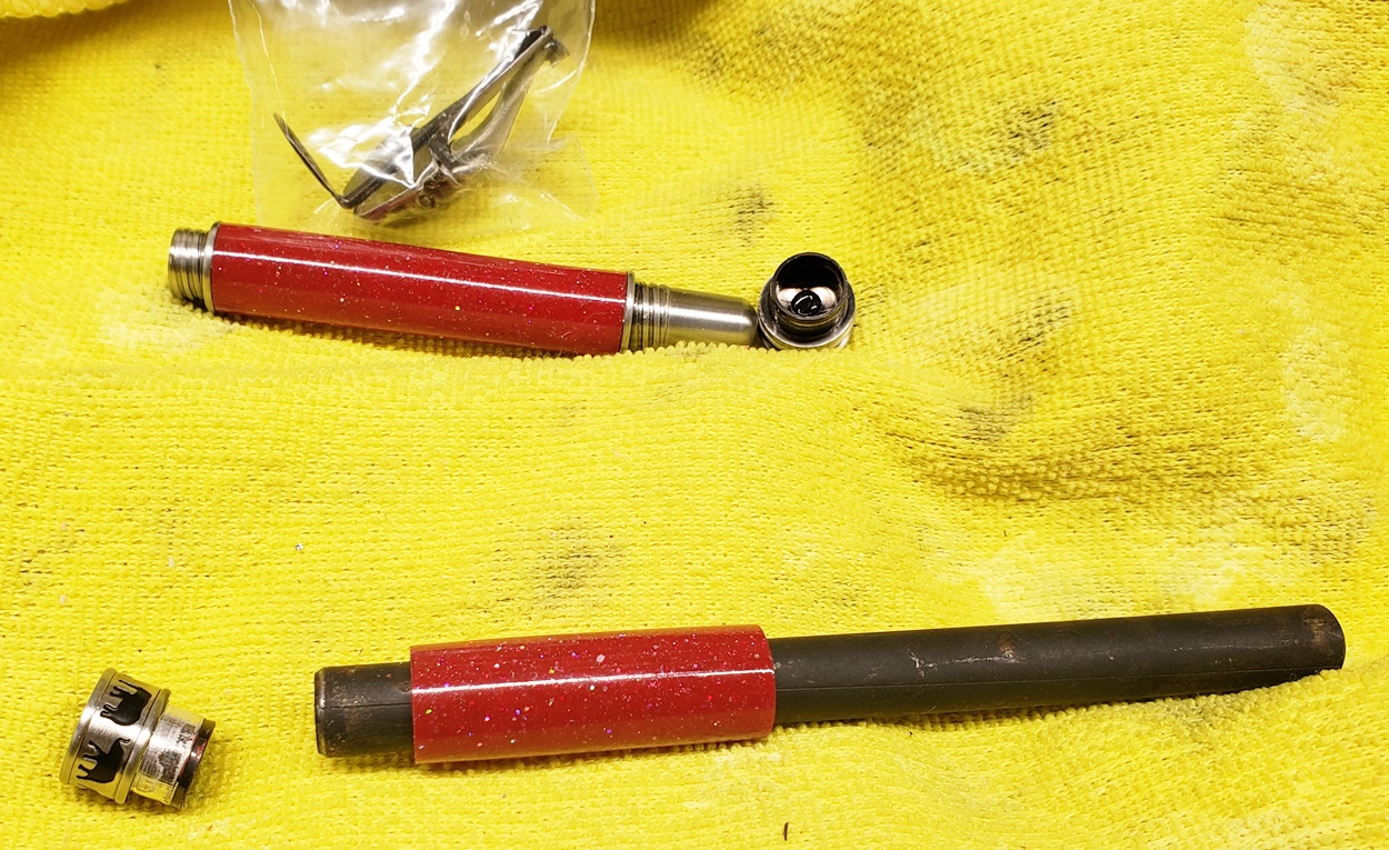

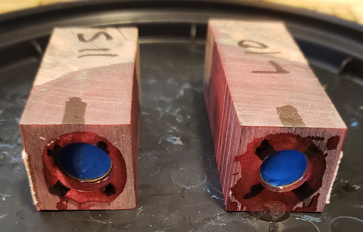

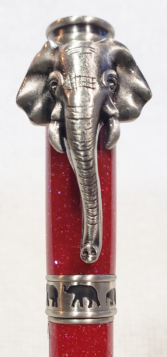

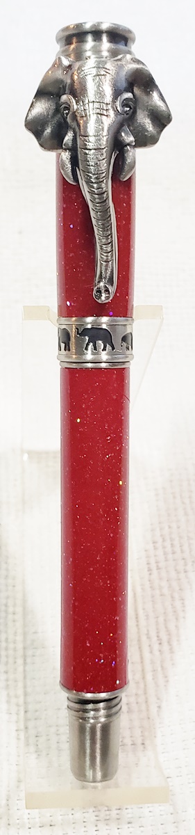

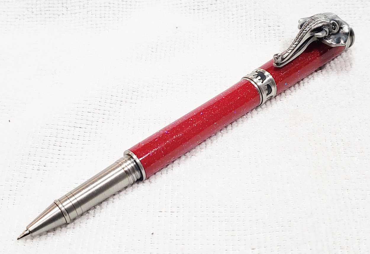

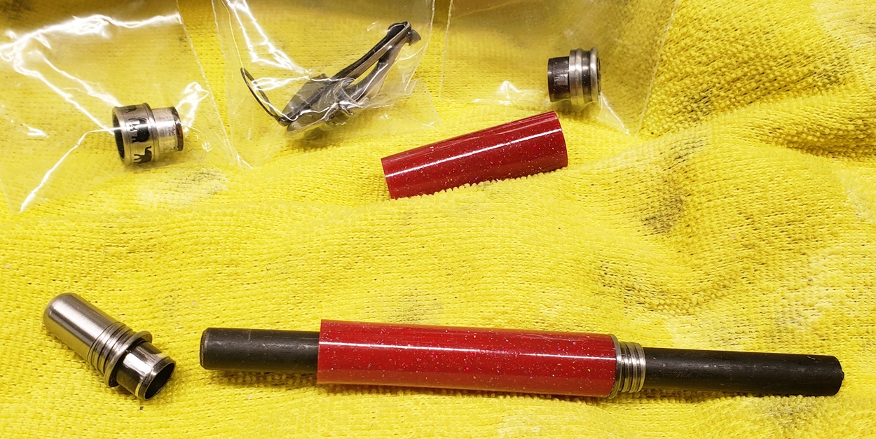

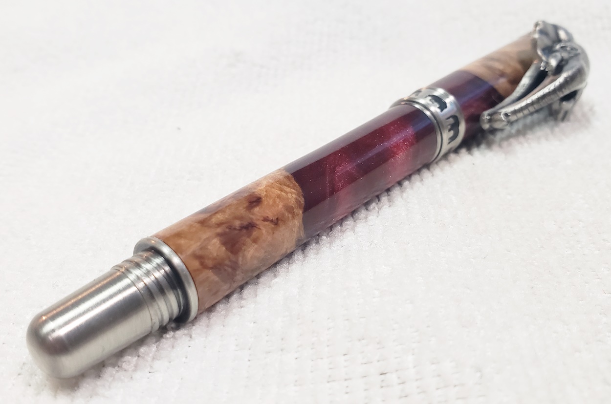

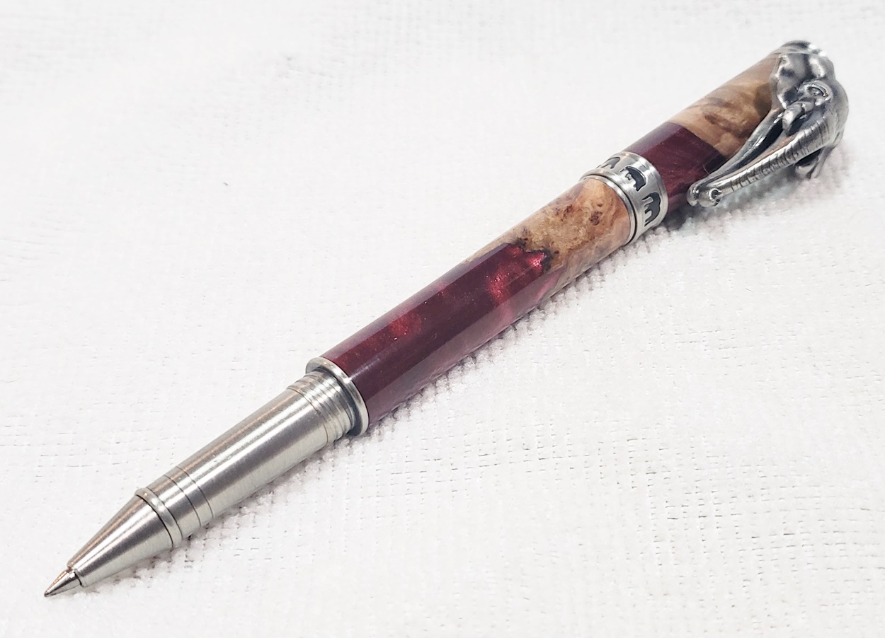

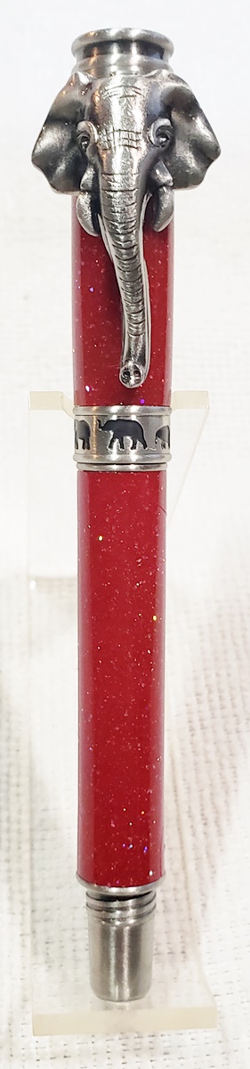

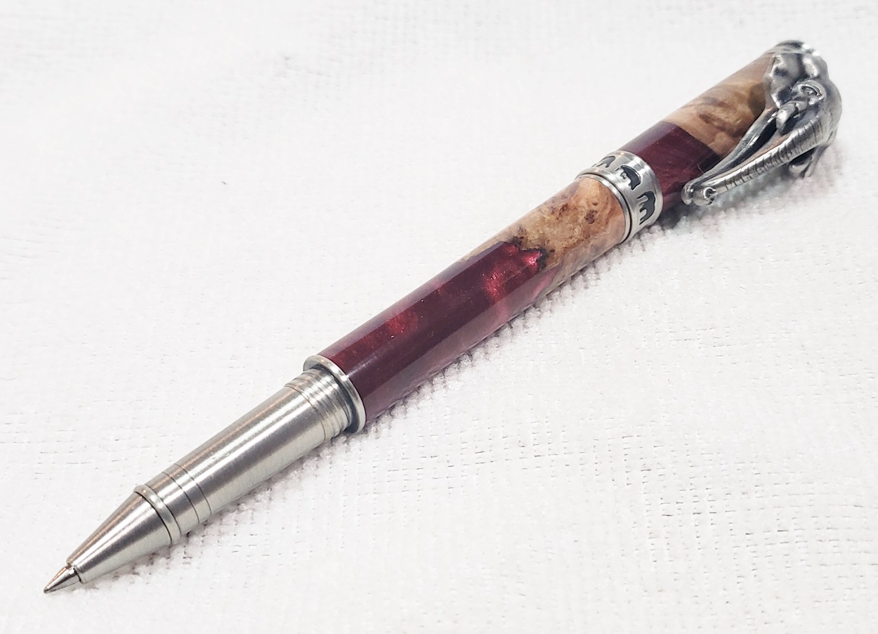

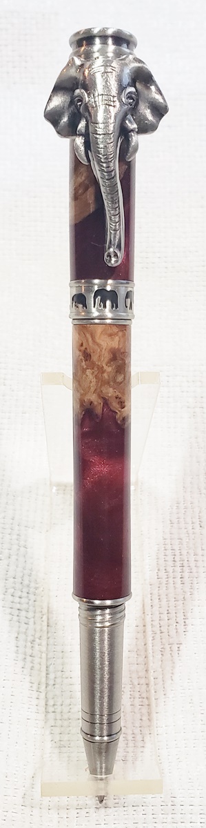

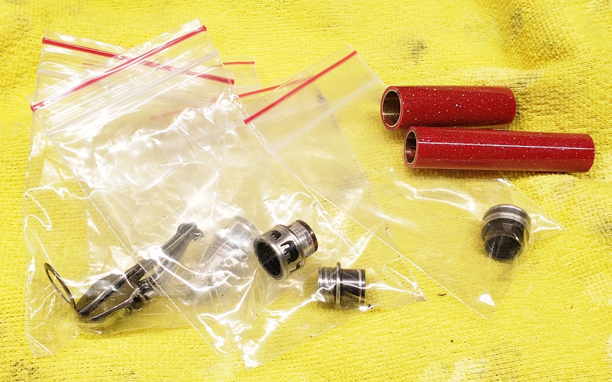

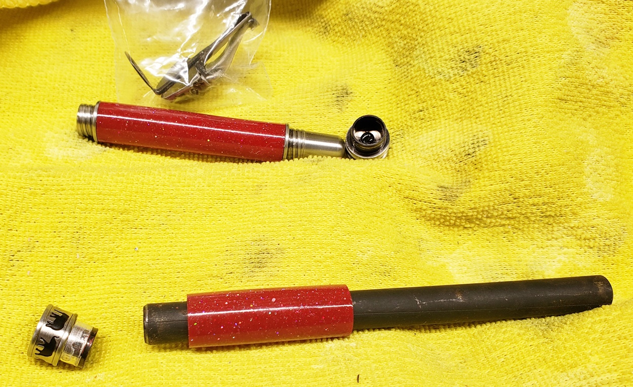

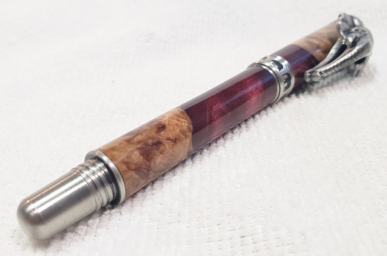

I got it disassembled, and started over with a hybrid blank.

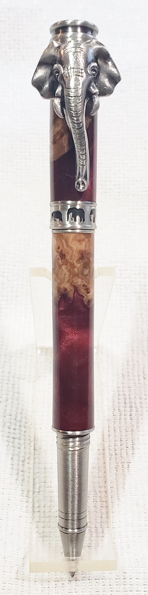

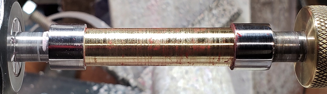

On any of the brittle "plastics" we use it's always best to sand the ID of the tube so that the fitting will almost press in by hand then assemble using a very tiny amount of red loctite. You'll have very little cracking that way.
Sent from my SM-G955U using Tapatalk
I've heard of that, but never tried it.
