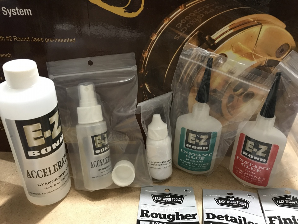

2. I currently only have thin and medium CA and accelerant spray, what other polishing options do you all recommend I learn? I looked all over town for EEE paste with no luck.

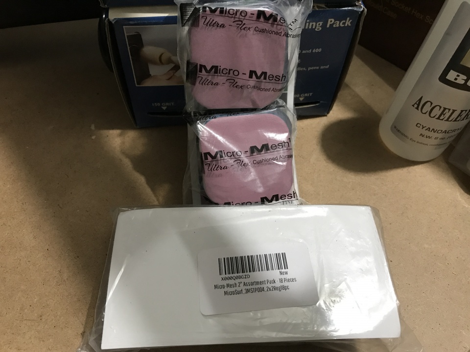

Use or get some very fine sandpaper 600 - 800 or get some MM Micromesh sets. These will do great.
EEE is a wax polish, which will disappoint unless you know what it does. Wax polishes - finishes and wears off in a day or two or three. If you are happy with that, then it is OK.

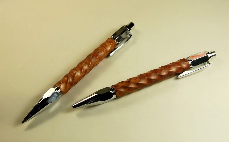

An end-to-end spiral on a pen does not look/feel that good, especially if your fingers grip the spiral when writing. . Might be OK if you are doing a Sierra pen kit or similar type where you don't grip the barrel that you turn.

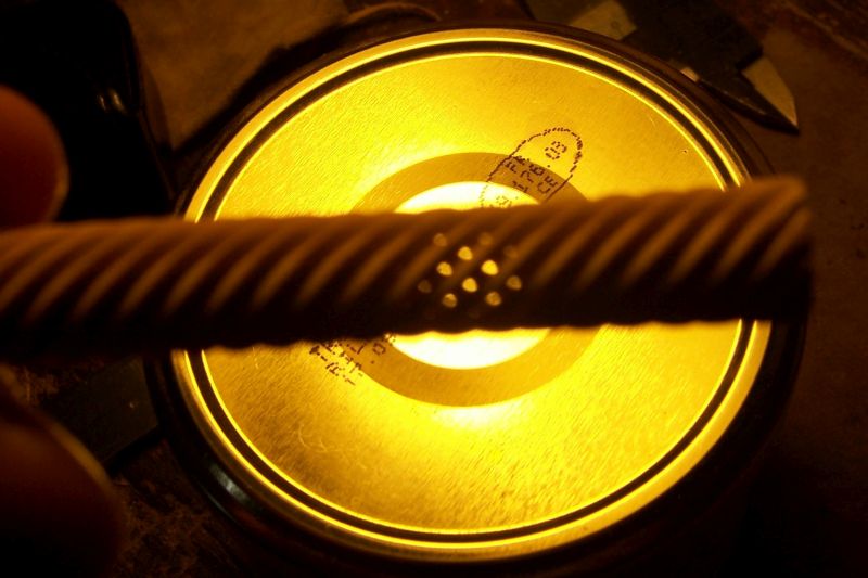

One of the problems with turning a spiral is that the low points of the spiral can go right through the material and expose part of the brass tube. . You have to be very careful to not cut the spiral too deep for the particular pen kit you are making. . The kits that are the worst for doing this are the Executive and the Sierra (ends of the blank have only a millimeter of material or less when finished).
By far the best finish, IMHO, is CA. . I am pretty sure that EEE can be bought on-line.

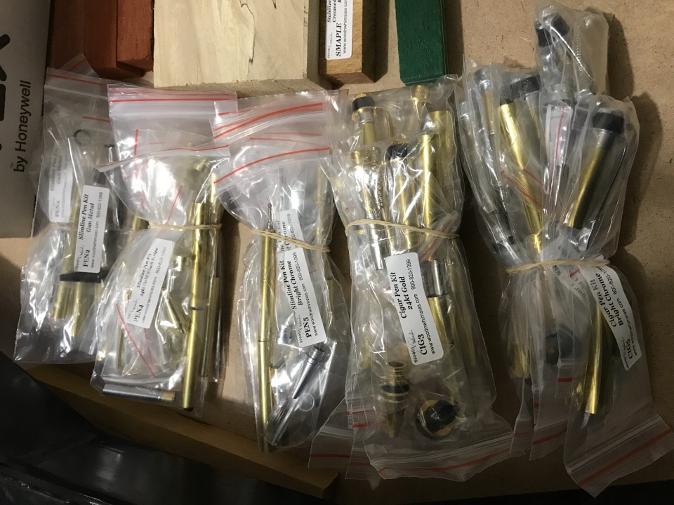

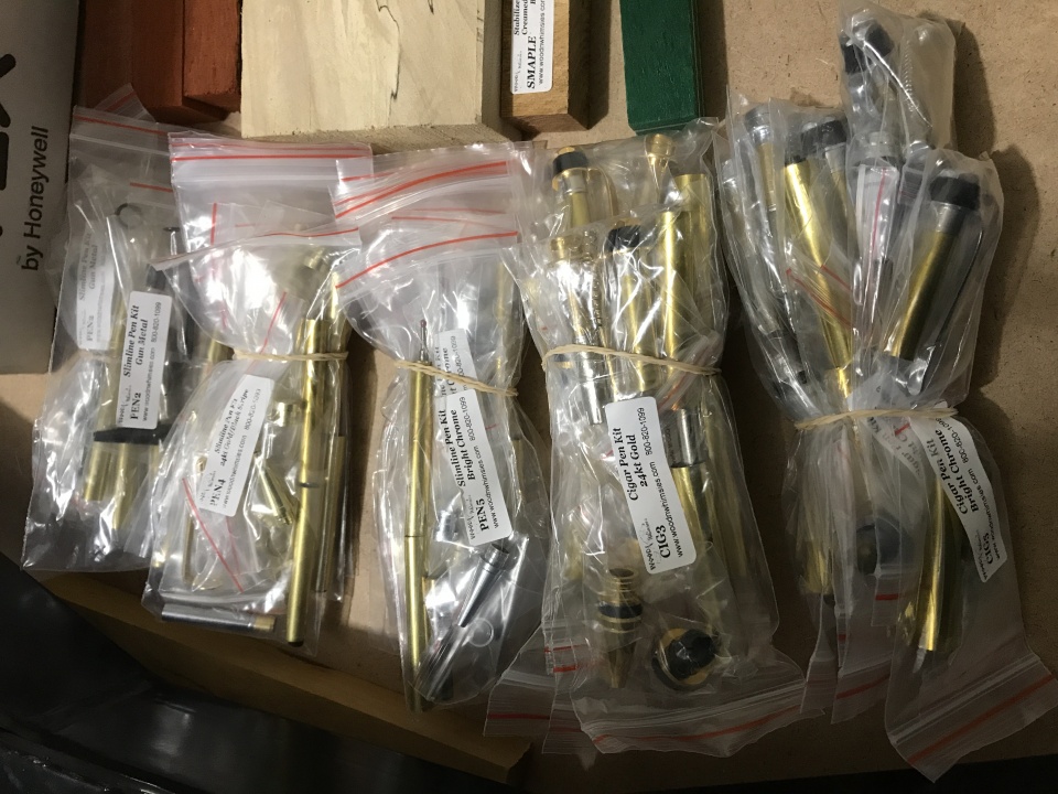

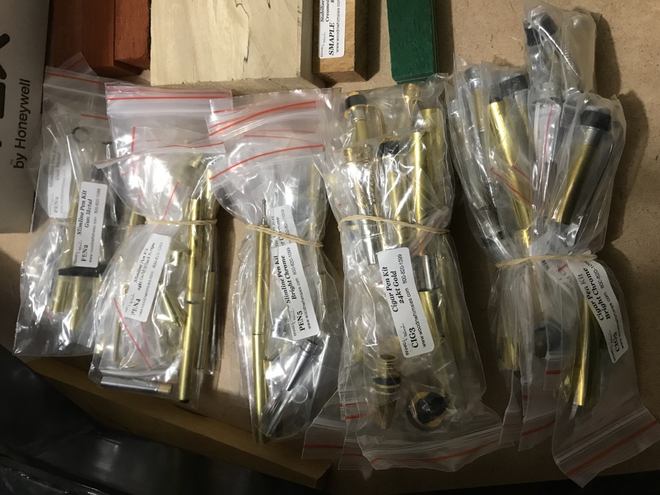

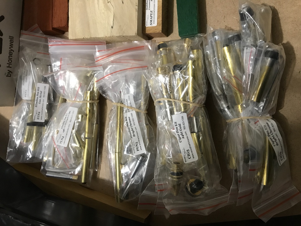

Not sure of pen kit manufacturer but I have these.

You will need something to polish your CA, Micromesh and buffing compound on felt discs are your friends. Forget EEE.

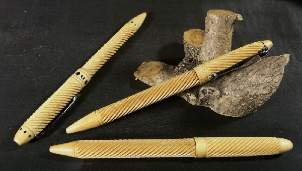

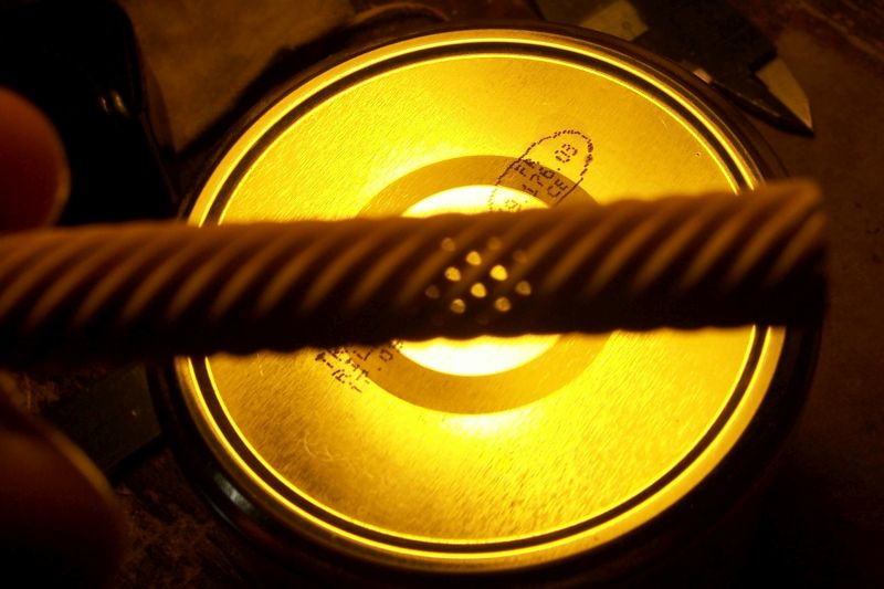

3. Is it possible to do pens with a spiral from one end to the other? If so how?

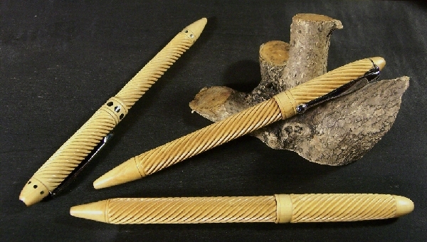

Sure. You may like the pen wizard, but as I heard that it was subject to wobbling and long to master, I made these two pen quickly and cheaply with rasps and files after careful drawing.
Quote:
4. I thought about buying those spinning Texturing and spiral tools for small bowls and such, can they be used on pens to make a textured finger grip?

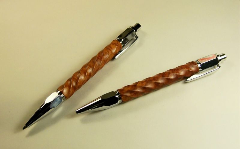

Sure. I respectfully disagree with Mal, who maybe never touched such a pen: once you have a spiraled pen in hand, you won't let it go, it is addictive. I made these with the Sorby tool. Plenty of uses, including filling the spiral with malachite powder. As it has been said, watch out and do not dig too deep!

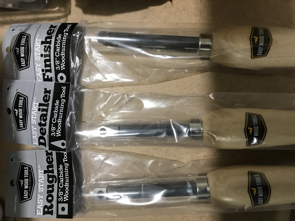

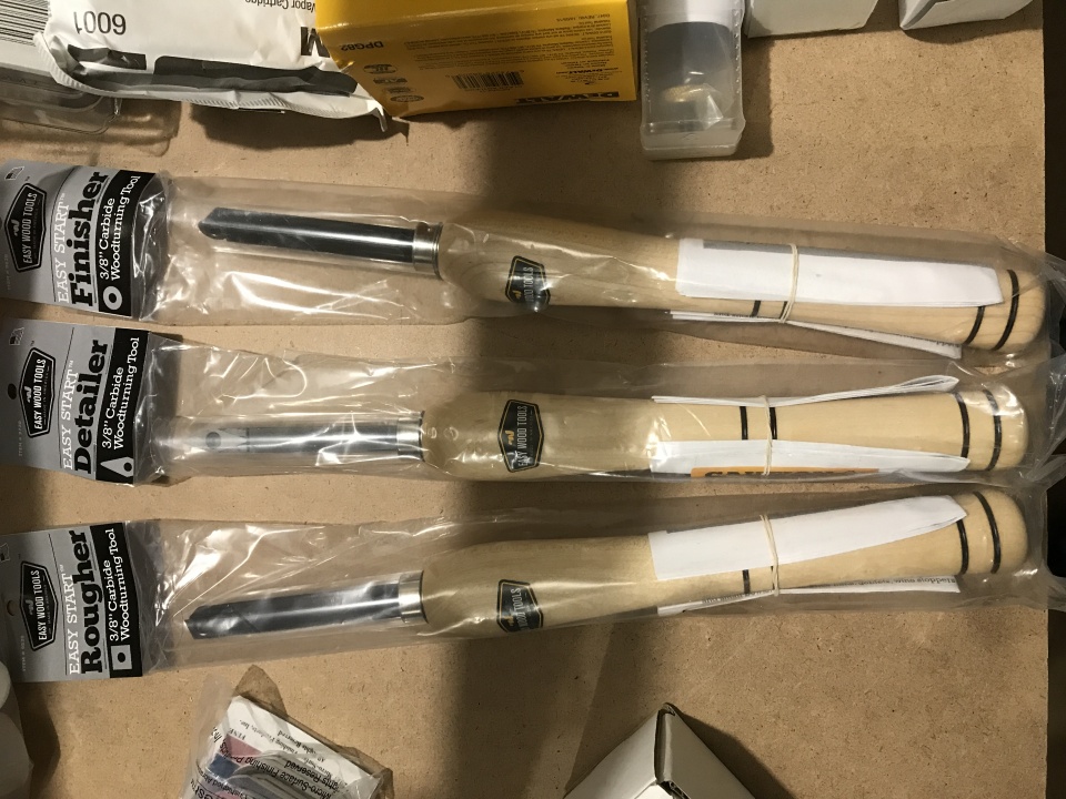

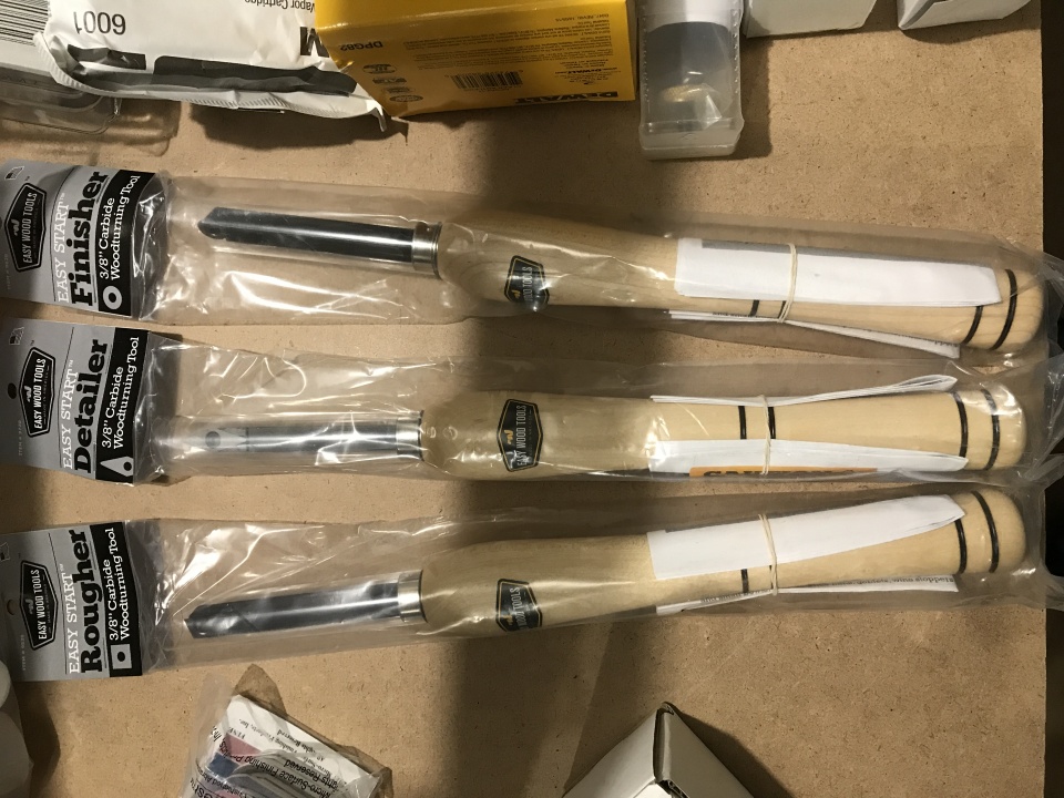

Your carbide tools will serve you well. . Skew is better for smoother but a pain to both learn and keep sharp (and it has to be sharp) when you are a newbie.
When you say "All of my pen kits the top cap is pressed on", what kits are you meaning ? . Are they Cigar pen kits ? . The screw on caps are usually only for rollerball or fountain pens.
These are all ballpoint kits and the cap does push onto the tranny. There are screw caps and also magnetic caps. Those are usually rollerball and fountain kits because the ink will dry out if not caped.
Those are no-name brand "Made in China" kits. Some China kits are very good, some not so good.
In what you show, 3 lots are Slimline-style, and the other 2 are Cigar-style ... all Ballpoints. . Neither is a style with screw on cap.
The Cigar kits which you show are copied from a design that has been around for 20+ years, I would say. . I do not know the manufacturer of the original Cigar pen kit.
There are plenty of Slimline-style kits available by various names. . The original slimline design has a long history which I do not know either.
Slimlines are frequently recommended as starting kits for pen-making beginners. . I do not agree with this recommendation because slimlines are some of the hardest pen kits to make properly. . Cigar pen kits are also rather difficult compared to other designs which I would recommend for beginners. . If you want my recommendations for beginners send me an email and I will gladly tell you.
I recommend that you familiarize yourself with some "name brand" kits, and the best way to do that is to look on the websites for Craft Supplies USA and Berea Hardwoods. . There are others but those are a good place to start. . Do not be put off by the prices at this stage but looking at those kits will give a start with some of the most (but not all) reliable kits. . It is a starting point for reference.
You should also be aware of the Dayacom company and their kits (a Taiwan company of excellent reputation). . You cannot buy directly from them. . They sell only in large quantities which does not suit pen makers like us. . They have a website which you can find by googling the name Dayacom. . Their website is not easy to navigate until you know what you are looking for. . But it is well worth your looking at for familiarizing yourself.
The reason I mention this company is that some of the most desirable (but not cheap) kits come from them.
If you go to US pen kit vendor websites like ExoticBlanks, BearToothWoods you will find many offerings of kits made by Dayacom.
For kits with screw on caps you should look at the Jr Gent II, Jr Antony, Jr George, Jr Harold, and several others with names starting with Jr (which, yes, stands for Junior). . Many of these "named kits" come from Dayacom.
What you have shown in your picture are not Dayacom kits. . The reason I can say this is because of my experiences in shopping for and buying kits over the last 8-10 years. . I advise you to do some surfing and looking.
I hope this info helps you even a little.

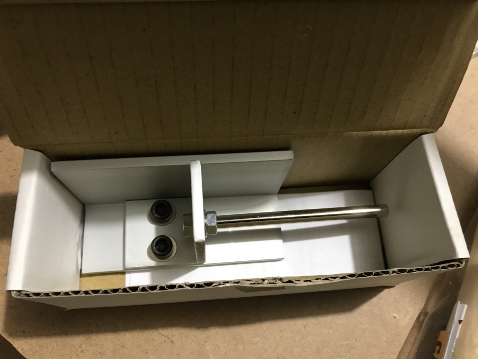

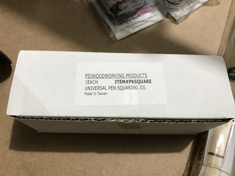

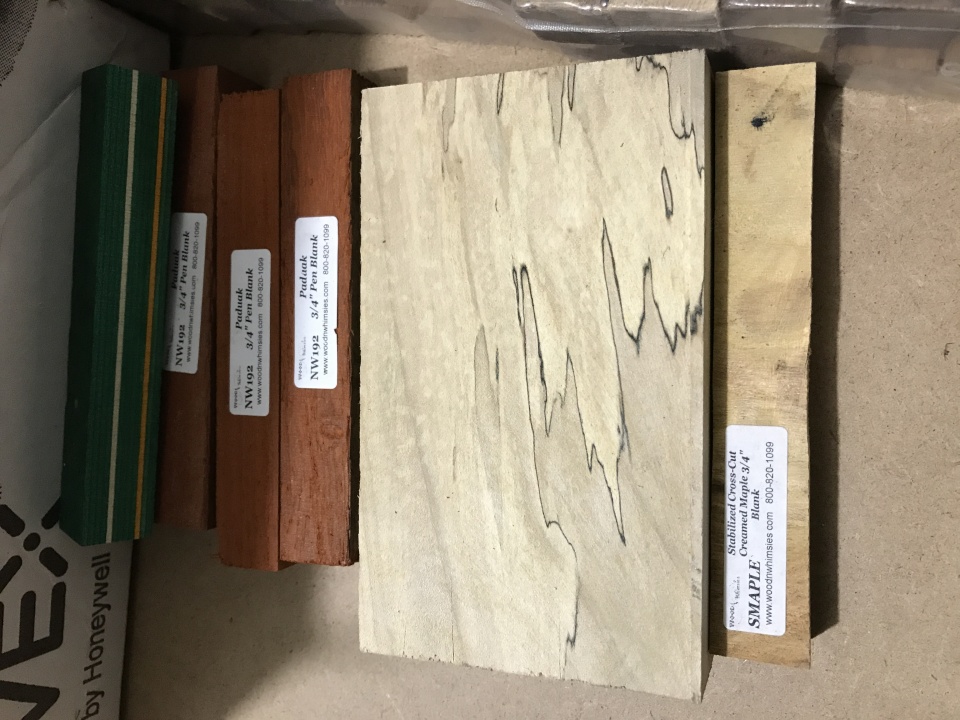

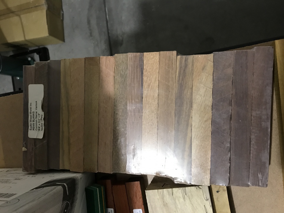

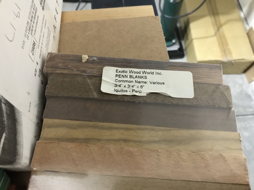

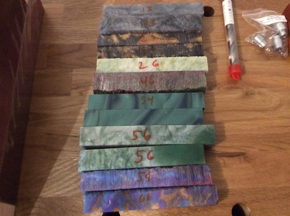

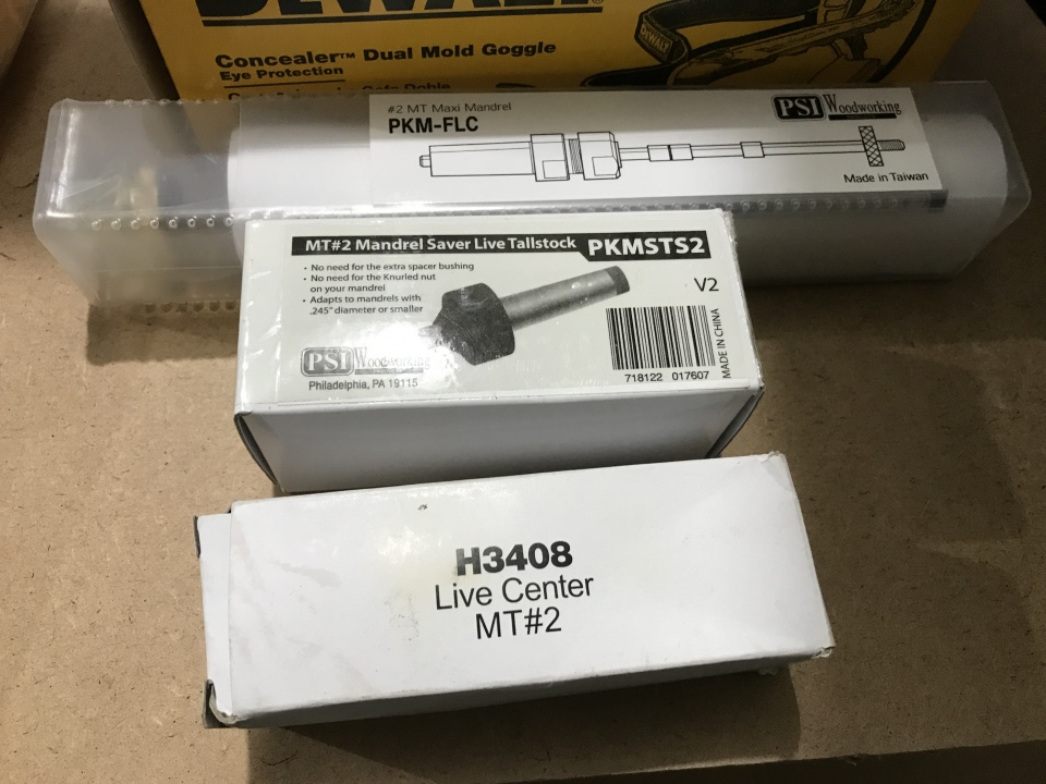

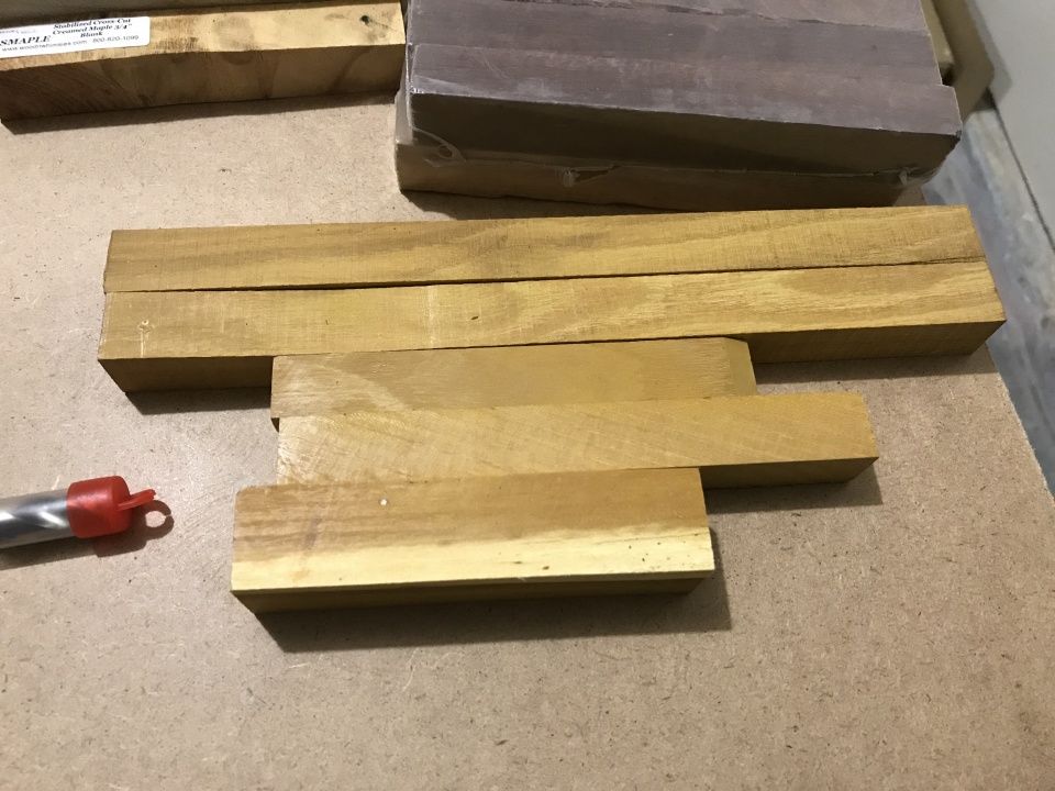

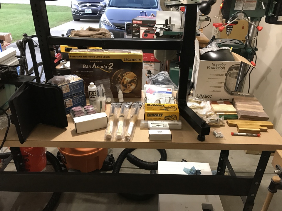

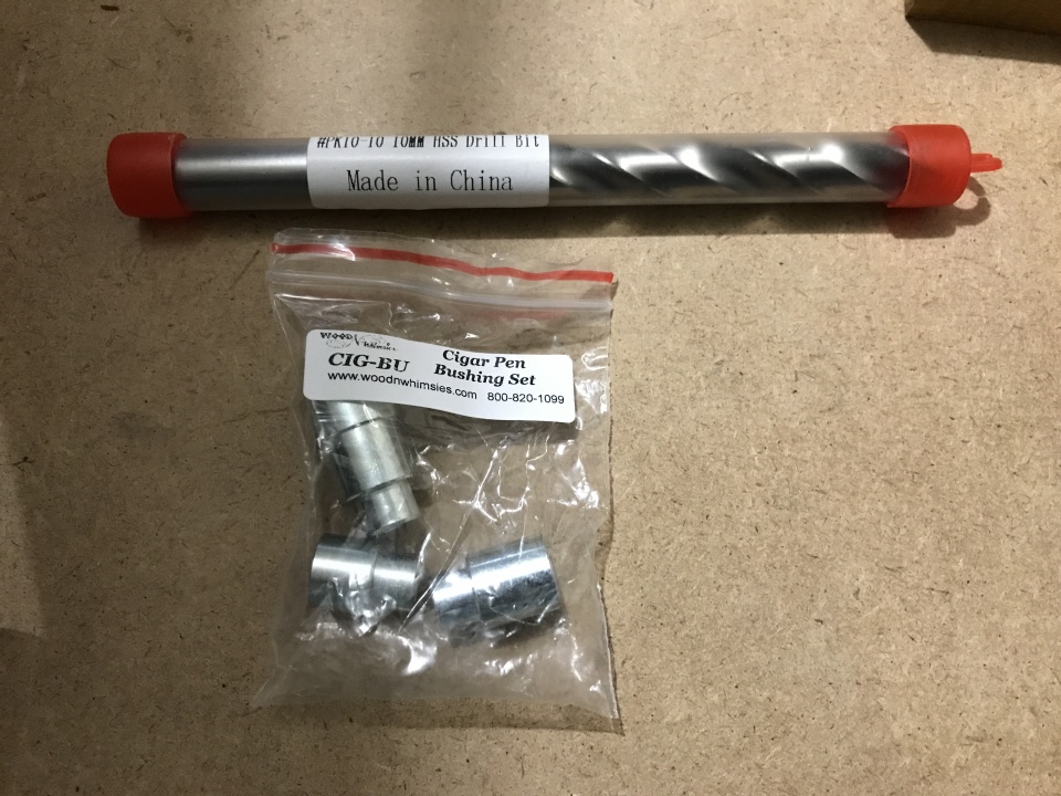

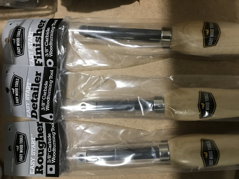

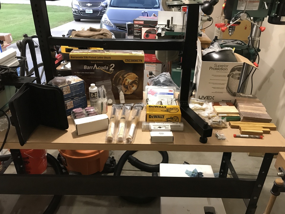

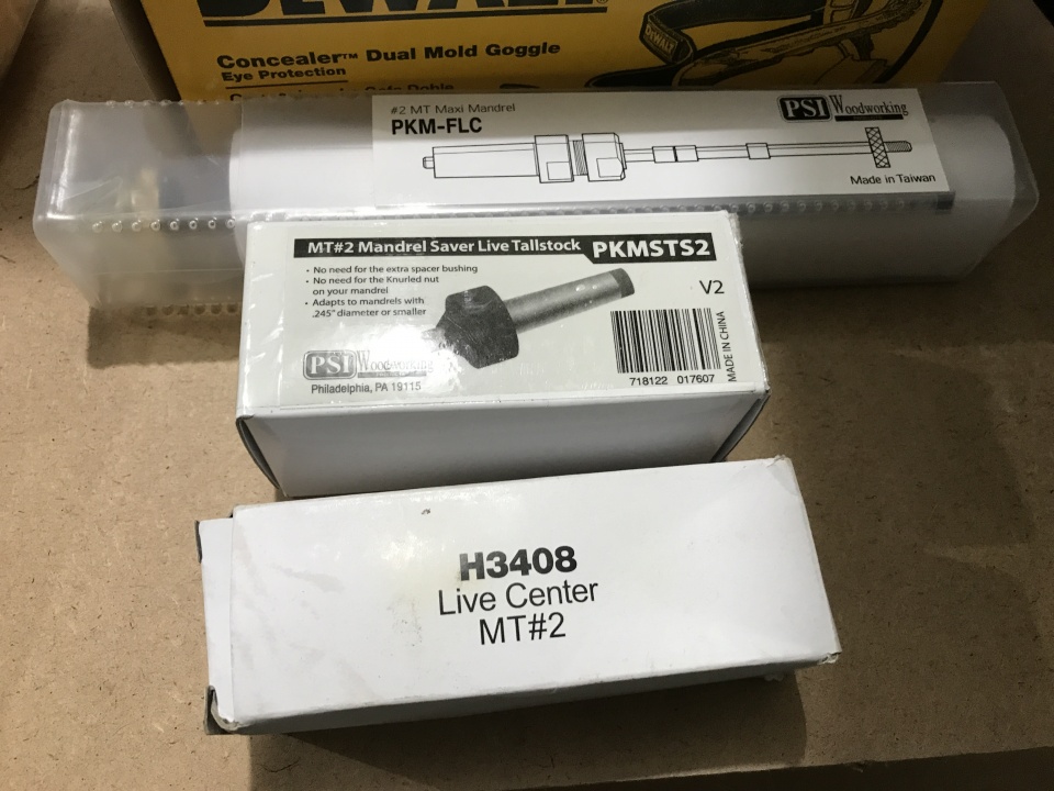

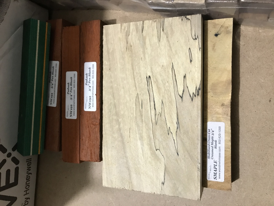

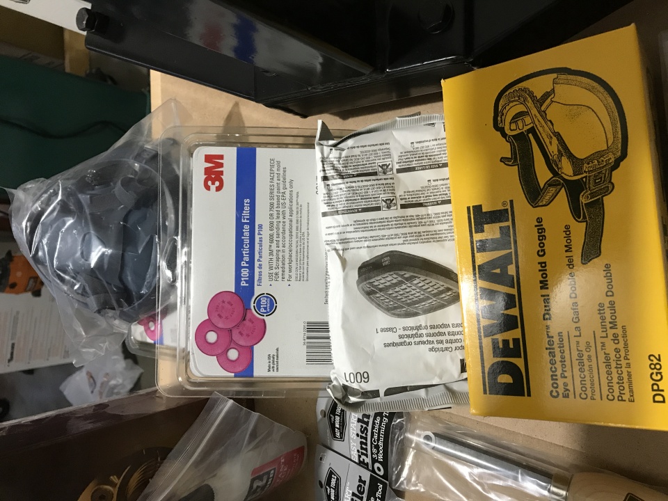

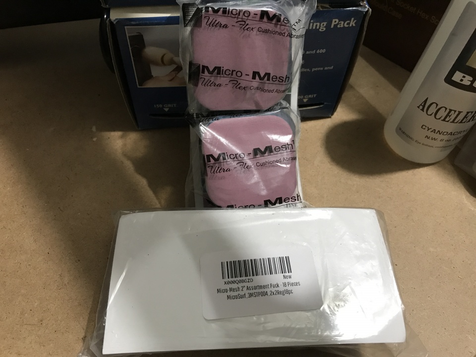

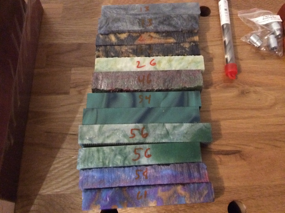

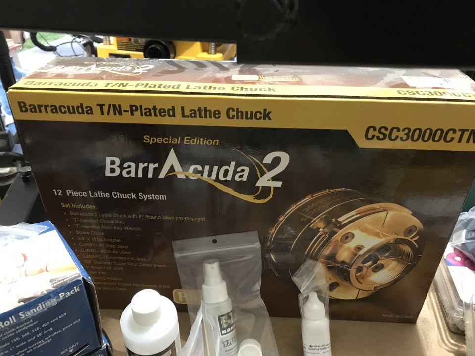

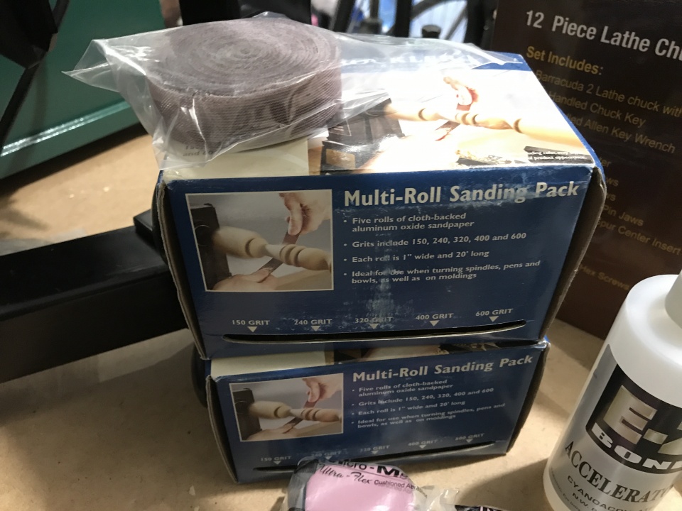

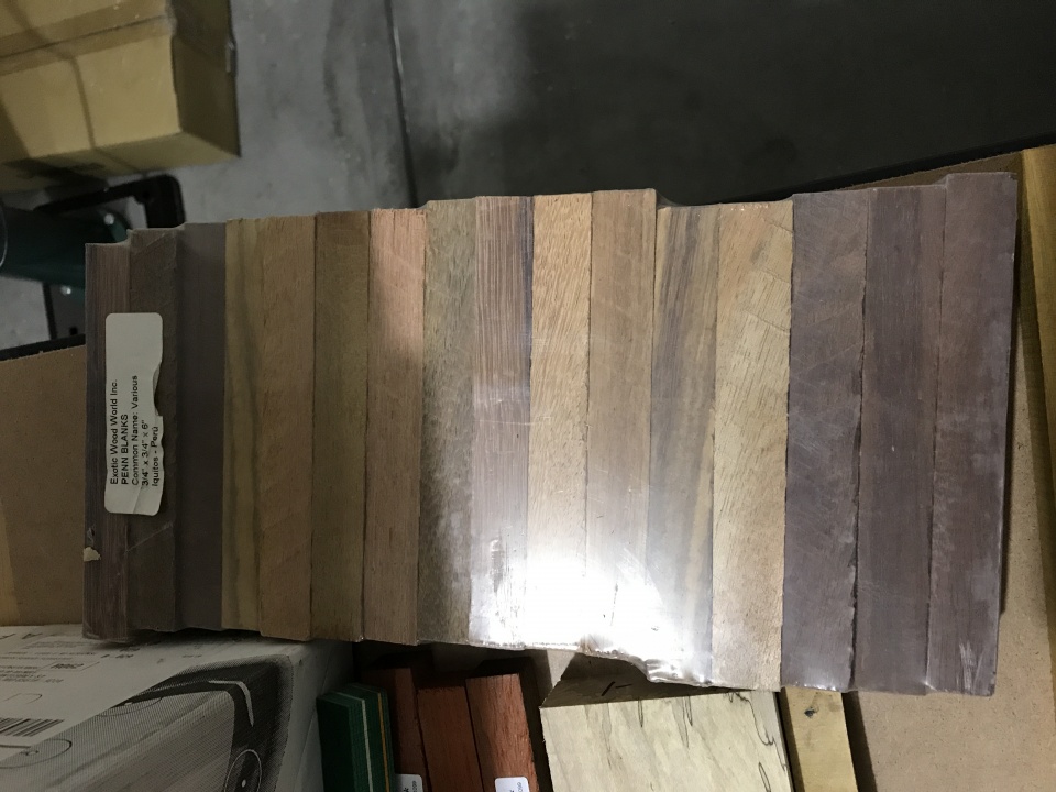

Most of what I have for Pen making.
Yes my first lathe. In taking images I discovered I do not have the drill bit or bushings for the slimline pens so I will get those tomorrow. I also do not have the non metal slim or cigar ones for applying CA.
What else do I need?
I also bought a T10097A—8" Grinder / Sharpener but not the jig for sharpening lathe tools yet as I only have the replaceable tip carbide ones. A few of the items I have I do not even know what they are for.

Mag.pens (Mal) I might be wrong but the kits I have MIGHT come from PennState Industries, I bought them from a local shop called Wooden Whimsies (Very nice people) In the kits, blanks, pen press and a few other things I spent over $300 and that was BEFORE I even bought a lathe. I tend to jump in head first and then look to see if the pool has any water in it.
Edward .... the kits you showed first are not from PSI. . They are indeed from WoodnWhimsies as printed on the packages. . As well as importing kits from China, WnW do sell some PSI products (which come from ???), however.
Have to say you have some nice new toys Advice: not all cigar kits use the same bushings so make sure they match your kit if you bought in different places. So many knock-offs of kits today. Also be aware there are 4 different sizes bushings for that kit so pay attention what you use for barrel and cap. I suggest you get yourself a nice digital caliper set. It will be money well invested. Never trust bushings size. Also use the components of each kit as your guide for sizing.
I suggest you use some scrap wood and practice your technique both turning and finishing. No need to put tubes in piece. Just turn down close to pen size and go from there. You have some nice wood blanks and would be a waste to ruin them with a blowout or catch. I also suggest get yourself some starting bits. Also suggest you get yourself a set of harbor freight transfer punches. Used for many thing when making pens and in particular taking kits apart. Also suggest when ordering kits to get spare tubes. Just about all kits can come with spare tubes. Not a big fan of accelerator especially one with a nozzle spray like that. Prefer the aerosol cans. A finer mist. Just beware of the mist that comes out of those spray bottles. It can splurt (is that a word) Make sure that live center is 60 degree. Did not see a pen press. You may want to get one of those too. There are some people that use various other tools to press components together such as their drill press, a vise, a set of parallel clamps and so forth. Also suggest you get if you do not have is a pen tube reamer. some people use a round file but they make reamers made for pen turning. I see you have a sanding jig so I am guessing you will be sanding the ends square with a disc sander. Setting that up accurately will be a key factor or else pens will have a gap at components. Many people do many of these things on the lathe. Many topics here written on this stuff. Check library or do a simple search which can be found to the right in the blue tool bar. On the left of the front page is a more indepth search feature using google seach. More accurate. Have fun and ask questions as you get started.
