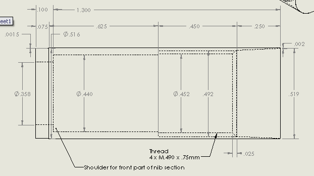

I'll have to try to get my head round having the shoulder in the cap. Must mean some precise measuring/planning to avoid damaging the nib I suppose.

Yep! Most of what I make has the shoulder inside the cap and the front of the nib section screws up against the internal shoulder. My comment about using a shoulder was a general comment about how to design any two parts that screw together outside of pipe threads. You want axial pressure on soft materials especially instead of radial pressure with high mechanical advantage.
I've attached an example drawing of what I make to accommodate a particular Parker nib. The part is an acrylic insert that gets cemented inside a metal cap barrel. The nib comes in from the right and the front part of the section hits the shoulder I've indicated on the drawing. The nib sticks out past this part and actually past the rest of the cap barrel. The little part of the nib that sticks out past the barrel is covered by the finial. Dimensions are in inches and the threads I'm using are 4-start. Just an example ... Your pen would likely be all one piece for the cap - no insert.
