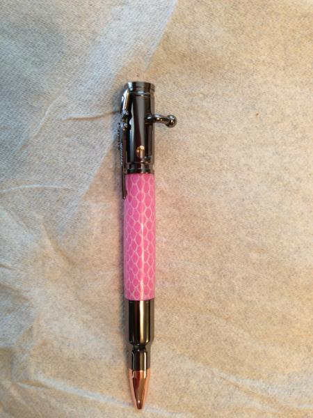

Here's a few pens. The gunmetal magnum bolt action has a pink leather blank from exoticblanks.com.

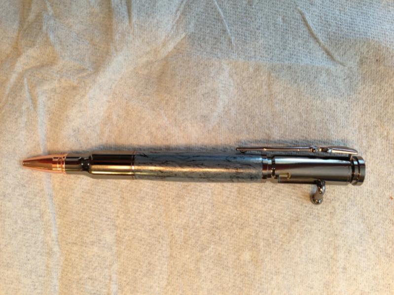

The gunmetal bolt action has a cobaltium mixed M3 blank.

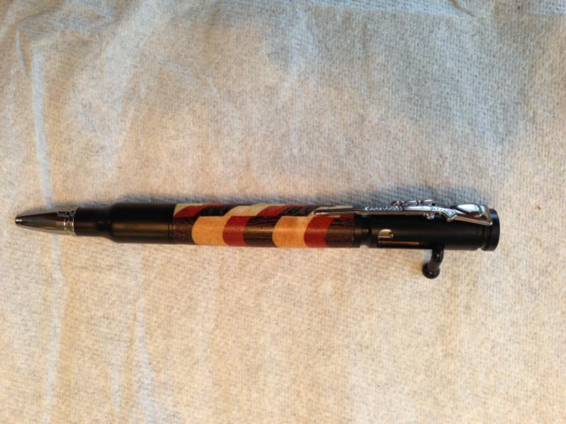

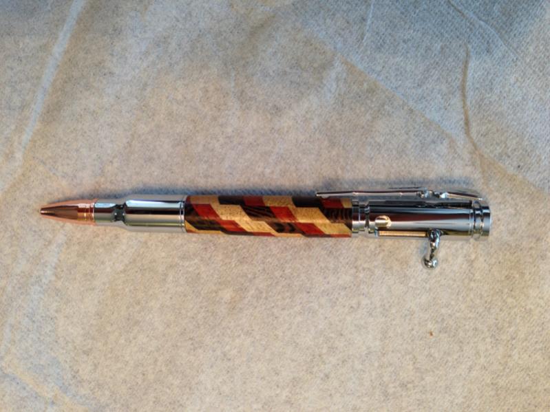

The chrome bolt action and black enamel bolt action have a segmented blank I bought from PSI (still learning the finer points of many things and I learned a lot about turning a segmented blank with these ones).

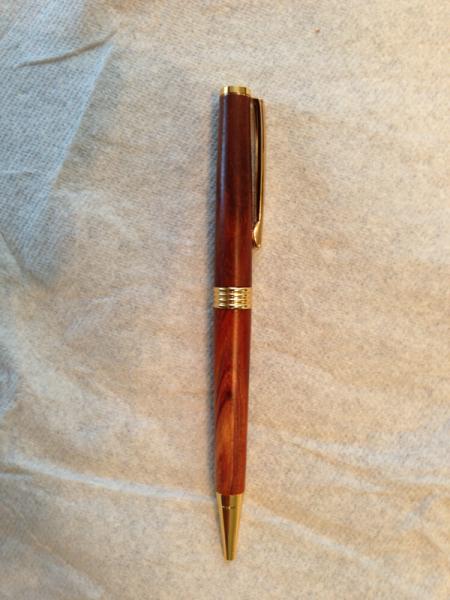

The gold Toni twist is cocobolo
The M3 is finished with micro mesh all the way and metal compound polish. The leather cast is the same but with huts plastic polish.
The wood ones are sanded the same but the. I used sanding sealer and melamine lacquer.

It's a trimline not toni twist (though they are practically the same thing).
The segmented blanks came from one blank. I drilled off center on both but at different starting spots to make the blanks slightly different. I noticed how one got some tear out at the nib but not enough to spoil the pen but enough that I noticed it and consider it a partial success.
The pink one I guess I didn't shorten the blank enough. I cut it off from a pre-tubed and glued blank that was cast (maybe someday I'll get into casting and what not but not yet). That was the first time I ever used a pre-tubed blank. The pen still works and I thought I had shortened it enough but the nib looks like it's a runt!
