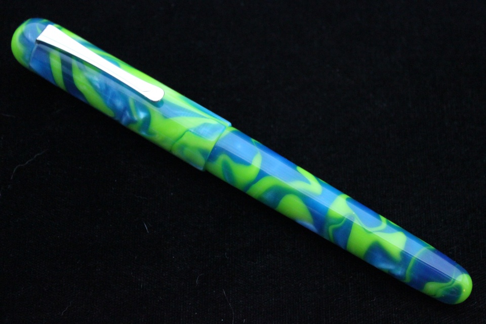

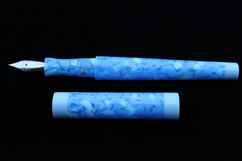

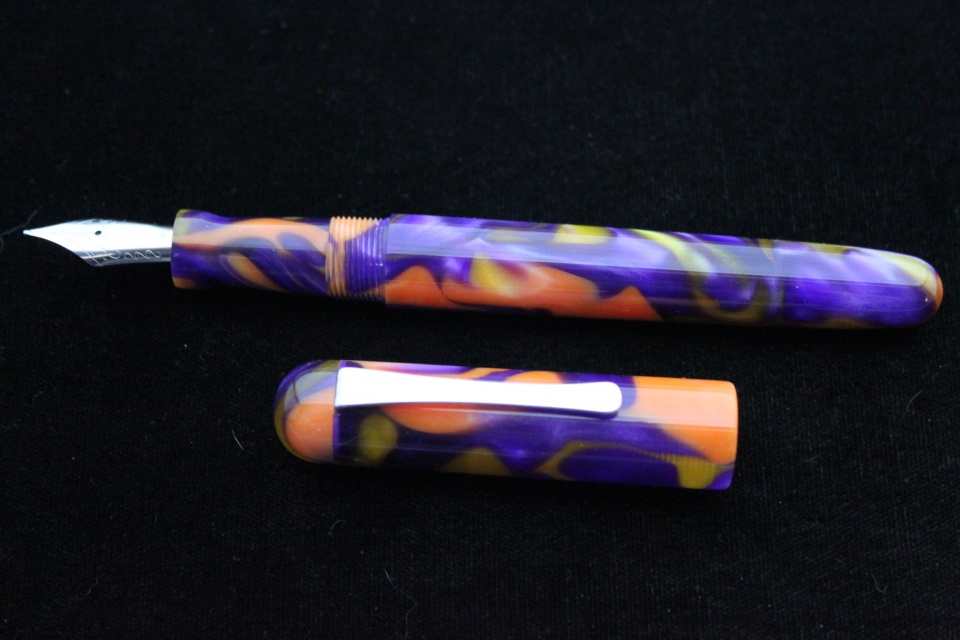

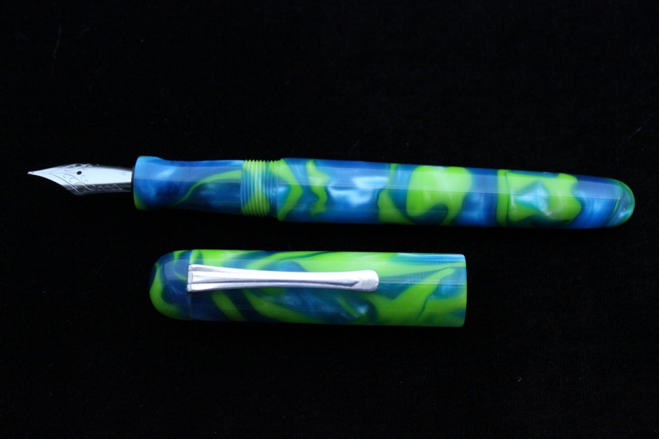

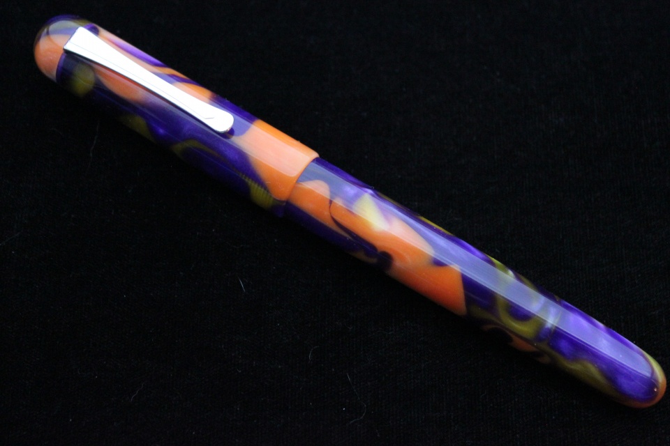

Here are a few pens I just finished. I'd love to hear what everyone thinks. They all have medium JOWO nibs and Schmidt k6 converters in them. I used 13mm triple start threads on them... so they only turn 1 1/2 times to attach. You guys have no idea what a victory that is for me. The pen in my pocket turns 8 1/2 times to connect cap to body... my wife can tell me about her entire day in the time it takes me to get my pen apart. Ridiculous!

Very impressive !! Not sure which one I like best, but I'm leaning towards the Blue one.
Might I ask what kind of blanks those are? Your threads look impeccable.
Bill
Nice work Jeff. You can get those threads reduced to allow capping the pen with just a half turn. :wink: Triple starts are nice and, that is their main purpose.
