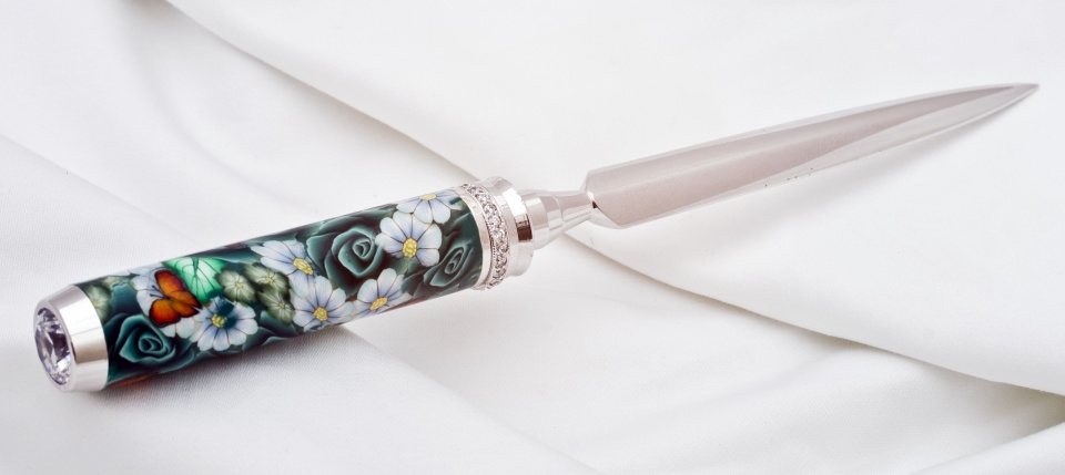

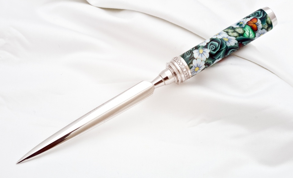

Dare I bump this by posting the matching non-pen item to this SET?
attachment.php
attachment.php
I like the fortune cookie line better than a Dayocom order :)

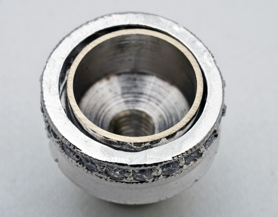

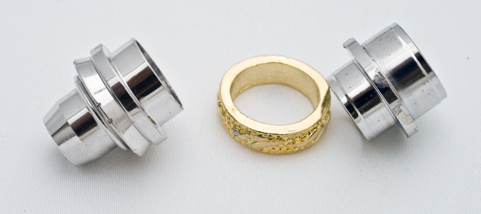

Seriously tho, not for the faint of heart. Majestic letter opener kit, venus kit. Both will be chopped up so be prepared to waste the near $100 if you screw up.
First thing is we have the same diameter tube on the majestic letter opener and the gent series. The length is not really that important in the letter opener so you can use any gent tube for that purpose.
The majestic letter opener center band is near similar to that of the gent series. Only exception is there is this added bulk on the front if to hold the letter opener in.
attachment.php
attachment.php

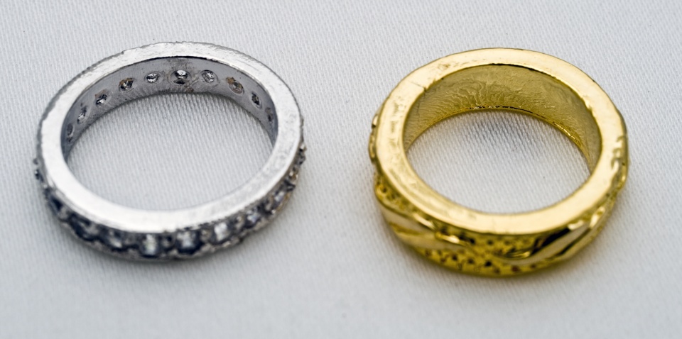

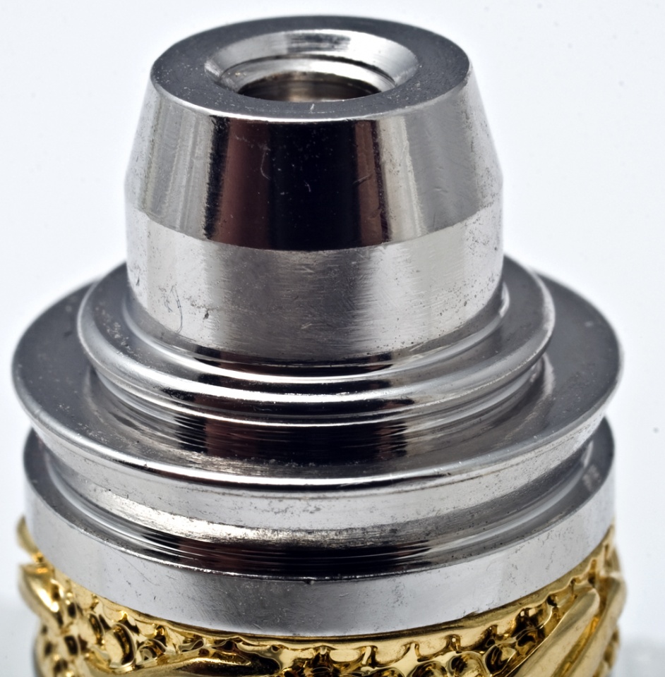

After several trial runs I pulled the band apart
attachment.php
Compared the two bands and there is a difference, that gap must be taken into account.
attachment.php

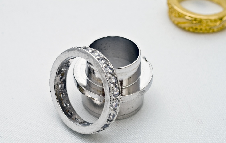

Front screw section of the center band on the inside view with the Venus band showing.
attachment.php

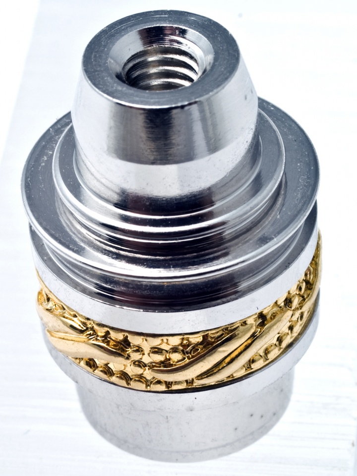

This is the insert into the tube section. this section is the same for all gent series center bands. the plastic tube rest on this part.
attachment.php
Re-press and like emerald would say BAM!
